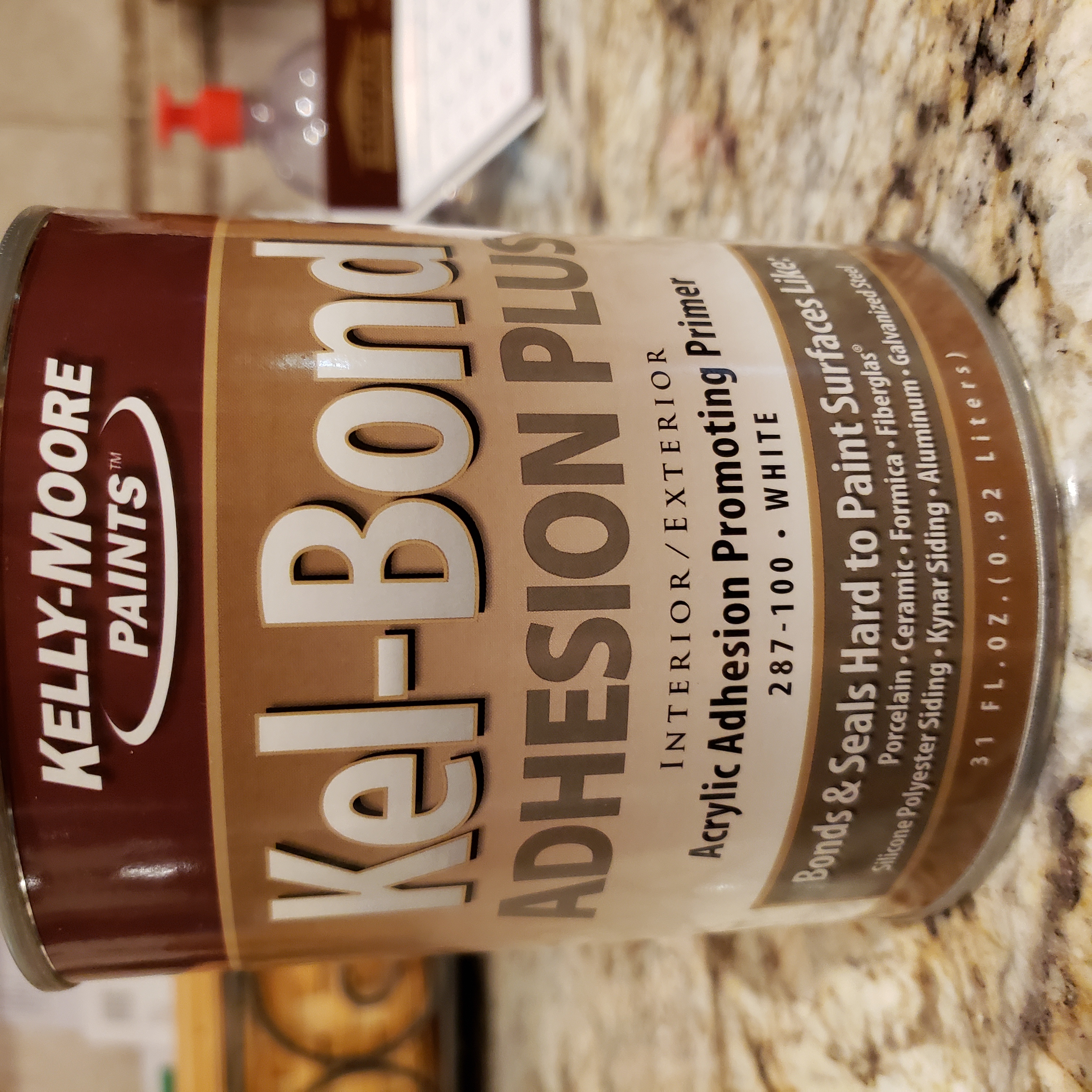

I had a job once that I was going to have to deal with old mixed materials, particle board, melamine, hardwood and I wanted to seal it all up before paint and found this primer. I ended up not using it but I'm sure most suppliers have a comparable material. "Acrylic Adhesion Promoting Primer" I like it list formica in the surfaces which is pretty close to melamine.
