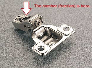

Hello, my name is john, I am a builder looking to replace 2 cabinet hinges, sounds east enough except I dont know the nomenclature of this hinge or its angle!
BASE END CORNER CABINET, please see the image and its LEFT set of hinges, please help me purchase the right hinge. Thank you, John

Hi John,,
The hinge should say “ Salice” stamped into the steel. It will also have a number on the hinge arm, near the adjustment screw. The number would be a fraction, 1/2, 5/8, 3/4. Etc…
If you email me this number, I can send the exact replacements you need.
Are the current ones broken?

1/4/23       #4: end corner kitchen cabinet hinge ...
hey John,
You can find to identifying number here.
Dennis

Jim Herron
Appears to be a negative 45 degree hinge
Look for brand name stamped inside the hinge cup
Likely available thru a local Wurth Louis and Company or online

Hey Jim, this is a common Salice, S series face-frame hinge. The only question I would have is the overlay. It’s likely 1/2 but could be 5/8 or 3/4” overlay. Hard to tell from the photo.

Jim, i think you are correct on closer examination. I was looking at the other side. Oops!
