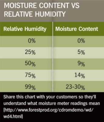

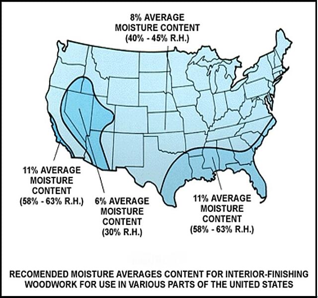

Please see the map below for average RH and MC for interior woodwork in various parts of the US. I have also attached a chart that shows RH and corresponding MC.
My workshop is located in Southwestern United States. Target MC for local orders is 5%.
I don’t have much experience with plywood. My company specializes in glossy contemporary lacquered doors and particleboard carcass. Recently, I have customers who strongly prefer plywood carcass and hence I am pressured to offer plywood carcasses.
I don’t import plywood from abroad. The plywood I plan to buy are produced in the Pacific Northwest. The UV contractor is also located in the Pacific Northwest.
I usually have my UV contractor picks up the plywood directly from the mill. He has found out that plywood's MC is always at 9-11% when he inspects at the mill. Because of the huge difference between 11% and my target MC of 5%, I worry that the plywood would warp when they arrive at my climate.
