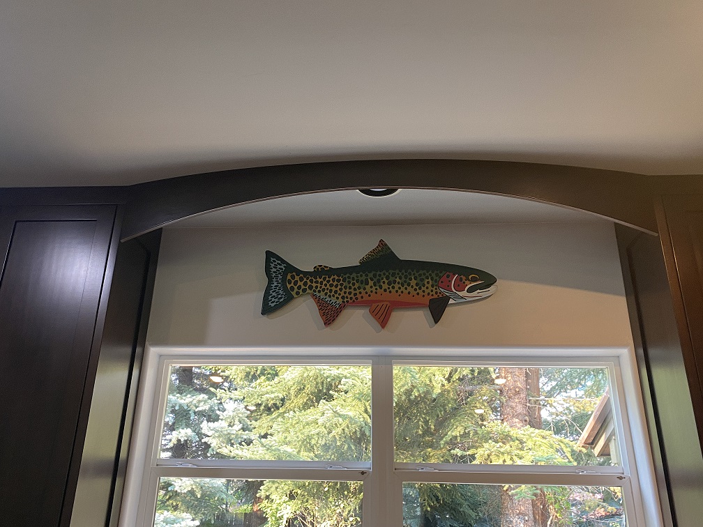

I made this arched valance using 3 plys of 1/4" african mahogany veneered mdf core panels.
I banded the bottom edge with an 1/8" thick strip of solid mahogany.
I spent most of a day making the form, laminating the panel, trimming the edges, and banding the bottom edge.
This was for my own house, I set the requirements...
View higher quality, full size image (1008 X 756)
