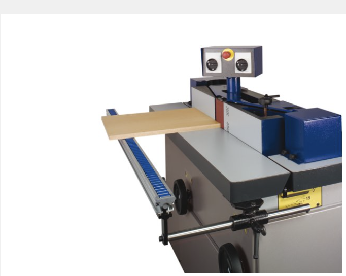

chris
A friend of mine has a Felder edge sander that has an attachment that operates like a jointer. See pic for the idea. maybe there is an aftermarket fence for your sander? Maybe you could make one?
View higher quality, full size image (682 X 544)
https://forum.canadianwoodworking.com/forum/tools/power-tools/1287730-ever-see-a-jointer-belt-sander

Thanks for the responses, a new machine is not in the equation for me right now but its nice to see the options out there. I especially like that kundig one (we have a (dated) kundig wide belt but its pretty sweet).
I don't make hundreds of doors a day. Maybe 40/50 in a weekend by myself. Our shop orders doors but for my personal jobs or other employees side jobs i make doors for them and I'm trying to improve sanding times.
I've started using a no file laminate bit to break the edges with a 1/16" round over. That saves a little time with the hand pad.
The split fence seems like it would do what I need maybe ill try to make my own in the future.
