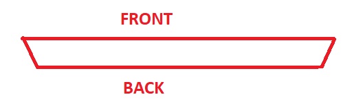

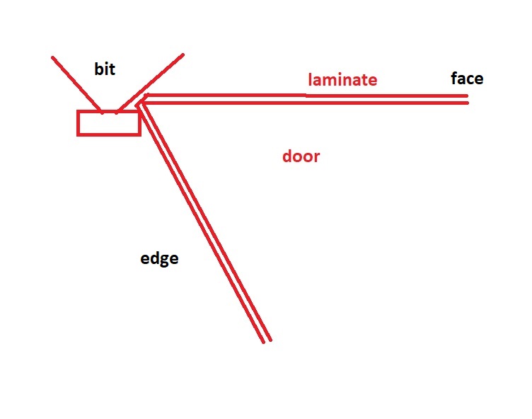

I have used a laminate trimmer to do this before but I can remember how I did it. Whats the trick
View higher quality, full size image (512 X 161)
9/6/23       #2: Laminate trimming on doors with pul ...
Roger Forst  Member
Do you have a trimmer with a tilting base? That would be the easiest.
9/7/23       #3: Laminate trimming on doors with pul ...
dave Member

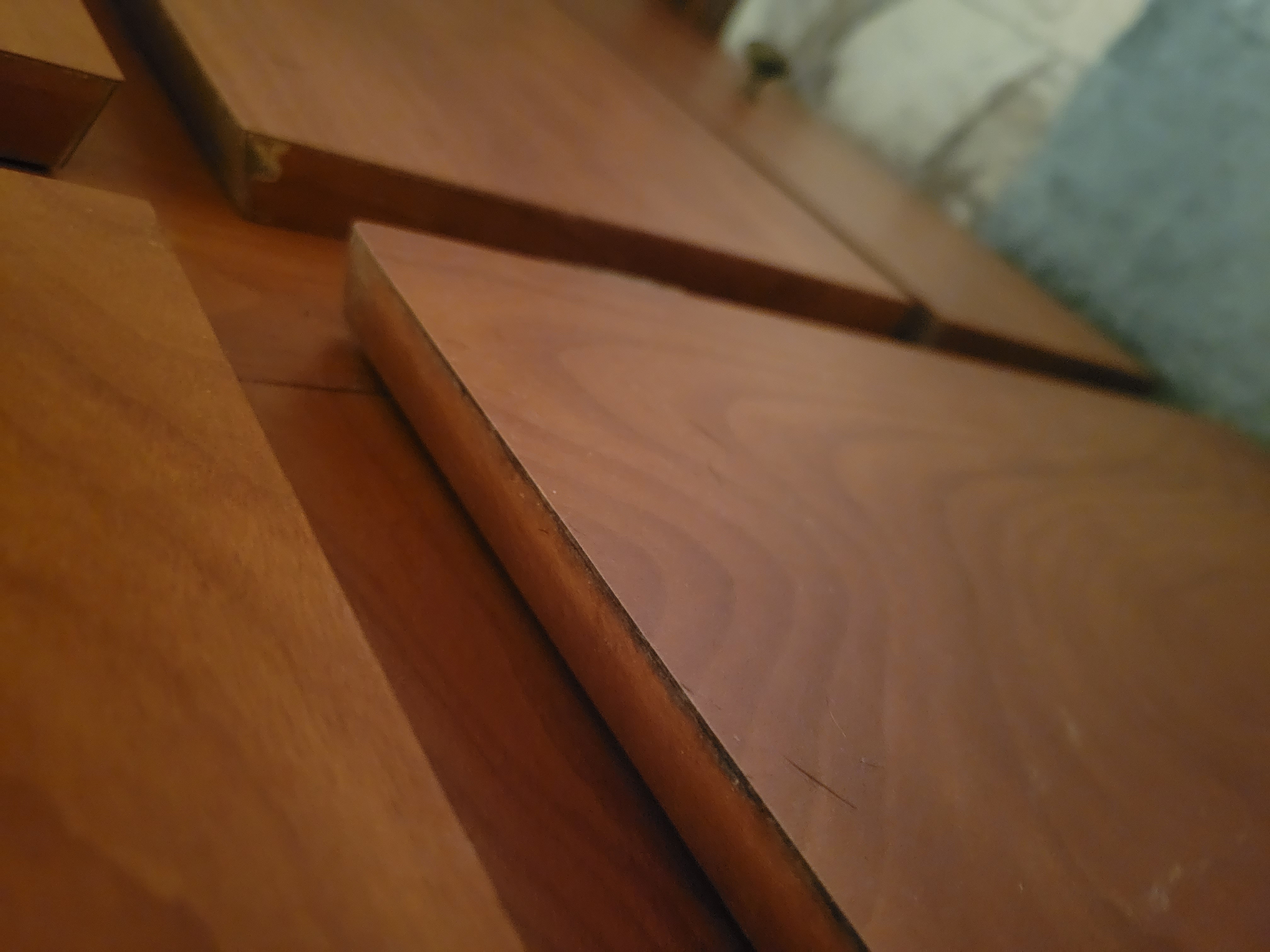

I dont have a tilting base router. What about an offset bit.. Here is a closeup of the edge I am working on.
View higher quality, full size image (752 X 592)
9/12/23       #4: Laminate trimming on doors with pul ...
Craig Caughlan
Depending on the color of the laminate, and if you're using laminate on the pull edge, you're really exposing the substrate for an ugly sight line - IMO. If available to match your laminate, I would suggest PVC or Melamine edging, with or without pre-adhesive. Or, what I do sometimes, is put 2mm solid wood veneer and knock the sharp edge off with sandpaper.
