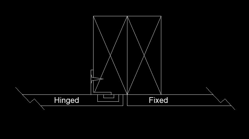

Is this what you are trying to describe?
View higher quality, full size image (823 X 462)
9/18/23       #4: Hinges for an inset overlay panel ...
Kevin Member
Thank you, BH! Yes, that is exactly the scenario I was trying to describe. note... I would like the drywall faces to align flush, exactly as you have depicted in your drawing.

Hinge a plywood panel with a standard flush inset hinge (off the shelf) and apply a 1/4" drywall skin (mastic'd to the plywood panel). You'll have to account for the total door thickness, perhaps 7/8" in your hinge selection (1/2" ply, mastic, 1/4" drywall likely with some sort of Jbead around the perimeter.
I dont see the need for the drywall as any smooth door material (MDF) will paint up like drywall and be far more durable face for a swinging door.
