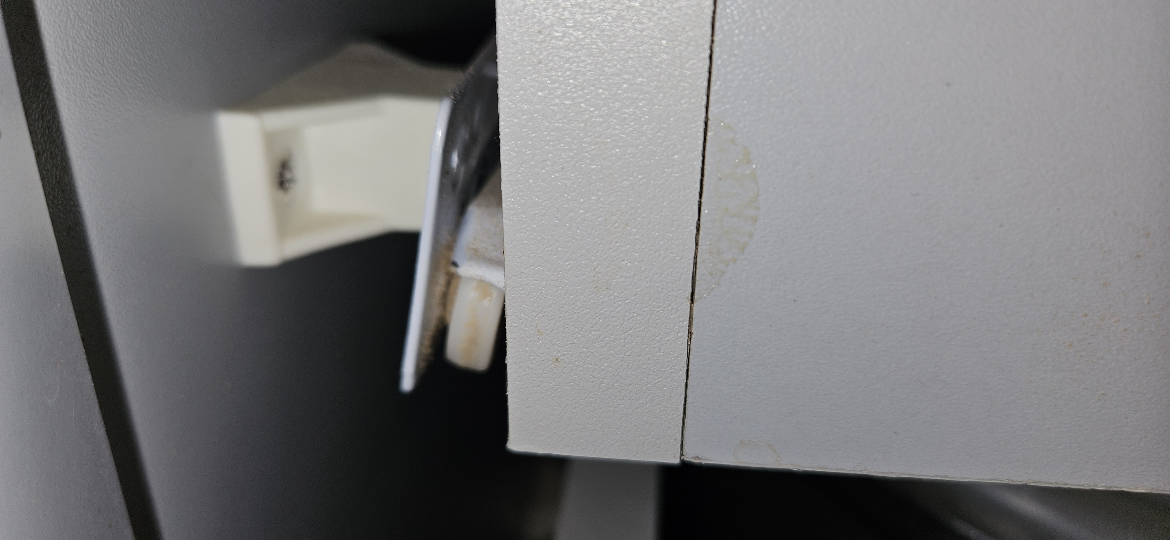

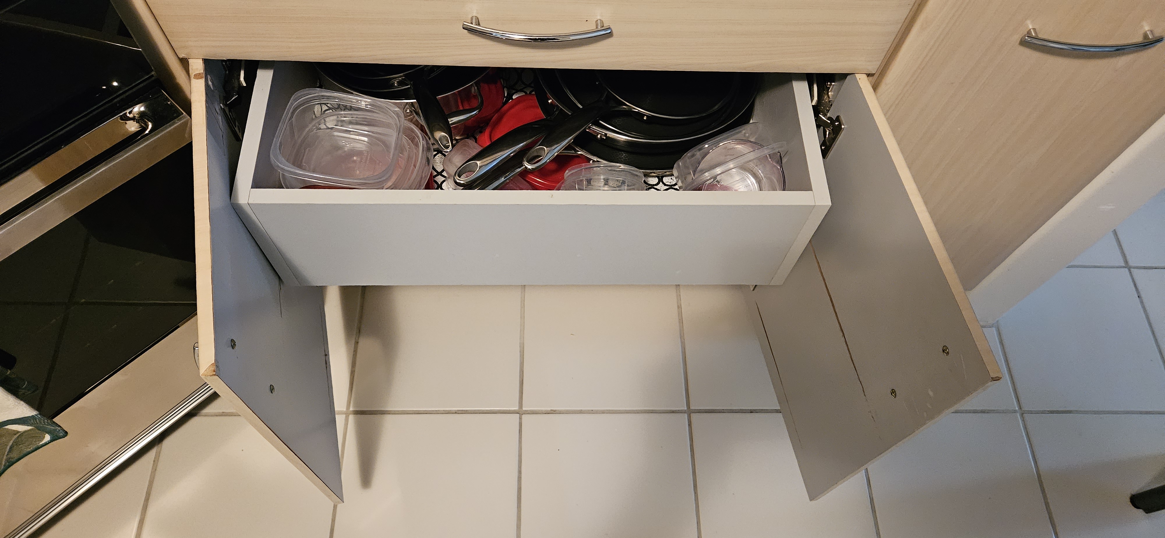

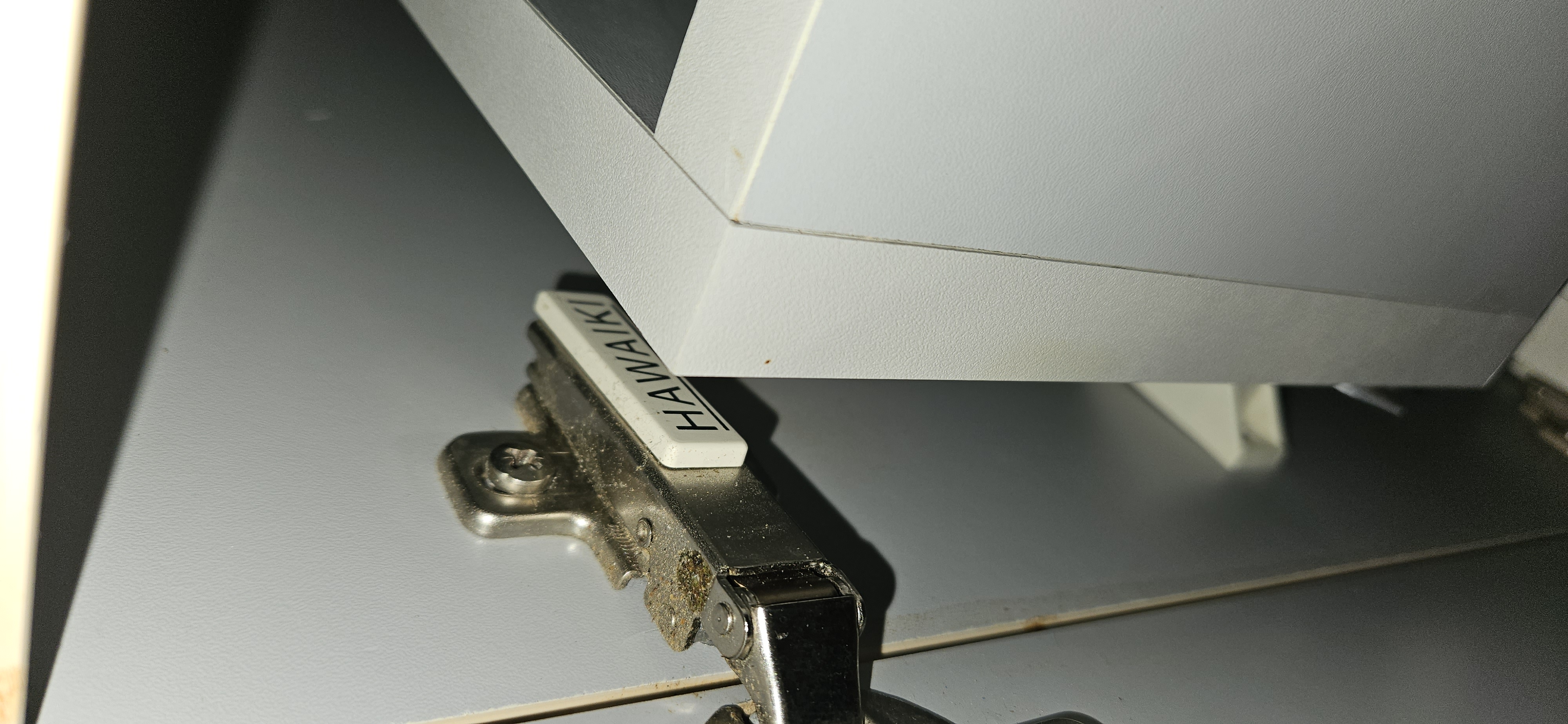

The appliances were recently replaced, and the cabinet cannot open because it hits the oven handle. The cabinet works in the way you open the doors, and the drawers roll out. As you can see in the pics, the handle gets in the way. Before the suggestions start flowing in, replacing the oven/handle/moving it, etc, is not an option. Replacing the entire cabinet is not an option. I am looking to see if there is a custom hinge that will "bow/flex" away to allow the door to open all the way.. I'm not concerned with matching hinges, but just need the door to open to roll out the drawers. The only other option to explore is to change the inside drawer system, but again, I think it would require a special hinge to clear the handle.

Modify the roll out, make it narrower on that one side. Or modify the end of the oven handle ?

John, What's the overlay on that door on the hinge side? (distance from the left edge of the closed door to the inside of the cabinet opening)
Are you a cabinet guy with access to a cabinet shop?

It's wonky, but you could remove the left door from the cabinet and then hinge it to the right door and have it operate like a bifold door.

Jim Herron
Brad, you have the thinking cap on...good call
