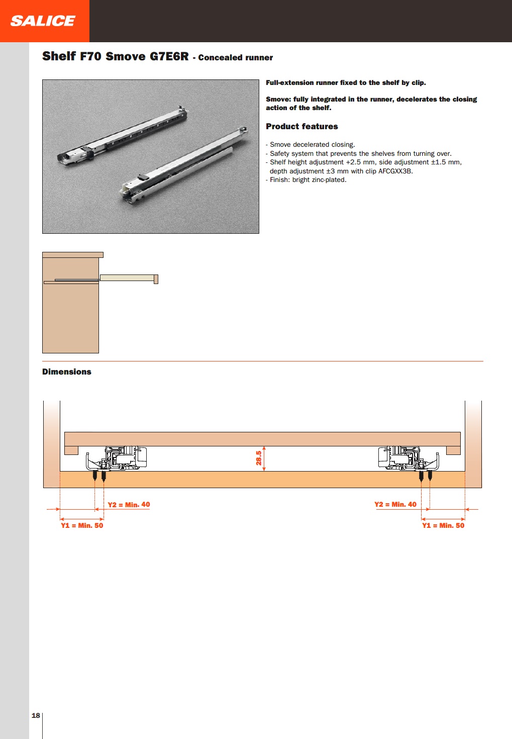

1/2/24       #4: Drawer slides ...
Here is an additional illustration.
View higher quality, full size image (1008 X 1378)

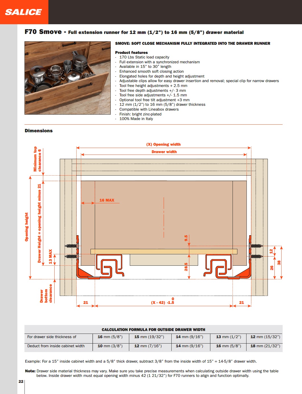

1/2/24       #5: Drawer slides ...
F70 Details
View higher quality, full size image (1061 X 1382)
