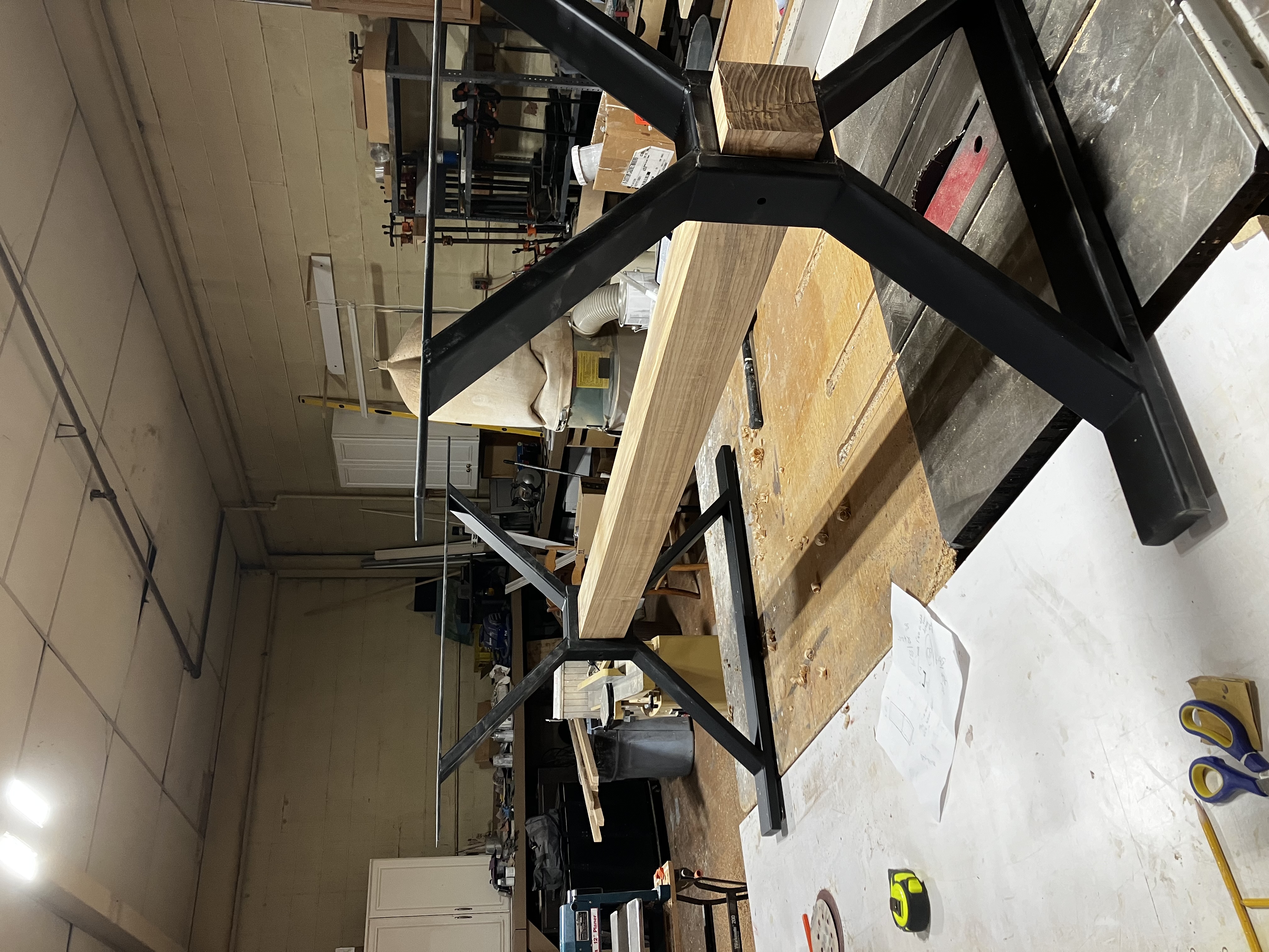

Ok. So I’m drawing a complete mind blank moment here
I am building a table with trestle frame. Pictured
The top needs to open in the center and fit in 2 22” wide leaves
I’ve done many leaf tables with the wooden and metal glides. That’s not the issue.
I’m drawing a blank on how to build some sort of sub Top because I need the top to come apart without the base coming apart. I normally make these tables with four legs and I just cut the entire table on half and attached of the glides and off you go. Anyone please help me and describe what needs to be built. I'm just having one of those days.

You have to get really creative if those steel legs are tall and won't let you add a slide on top of them. Hope you have a welder.

tom
to response number 1. i know how to build it, im just drawing a blank on the best way. it was a knee jerk post as i was working in my shop. i didnt bid this particular table to the dollar, i have the ability to charge what i need for it with this particular customer. money is not an issue for them.
getting the table they want is.
the leaves will not be stored inside table.
the leaves are too thick and heavy. they will not cup in a closet any more than they would sitting in the table. they will be stored flat and dry.
im going to put a subtop on and have to put some heavy duty slides on the flat. build the table upside down and get the lines dead on.
i was and am more curious to see if any other had done this type and what method they used. thanks again.

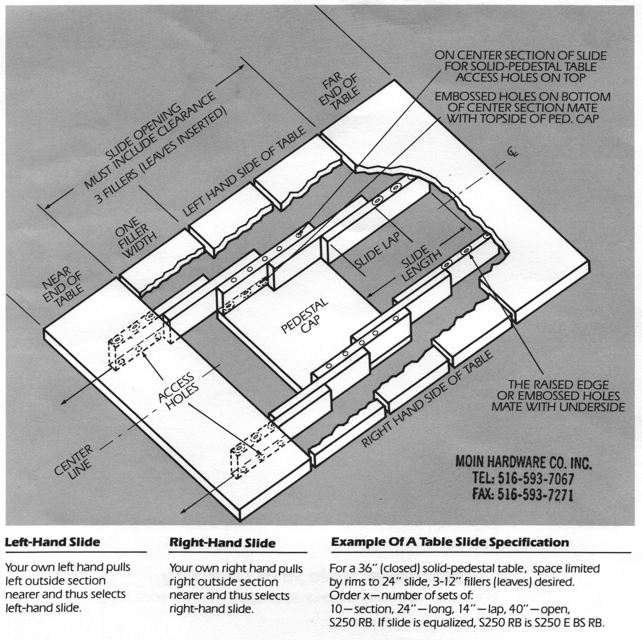

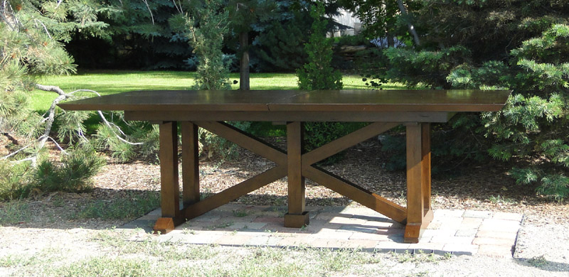

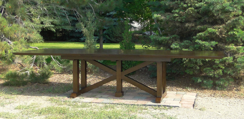

I've done a number of these type of tables, and they require a different approach than regular 4 legged tables. You'll need a subframe to attach the equalized slides to. Equalized slides are different than the regular slides you're probably used to. They're meant for fixed base tables like yours, where only the top pulls apart to make room for the leaves. You screw the bottom of the slides to the subframe, and the top of the slides to the underside of the two halves of the wood top.
From what I see in the photo of your base, you might have to modify the top plate on the two X trestle ends to make this work. The slides I use are 2.5" tall so that's how high the interior of the subframe need to be. I get mine from Moin Hardware @ tableslides.com
Tha table in my photos was 7' long, with 2 leaves it was 11'.
