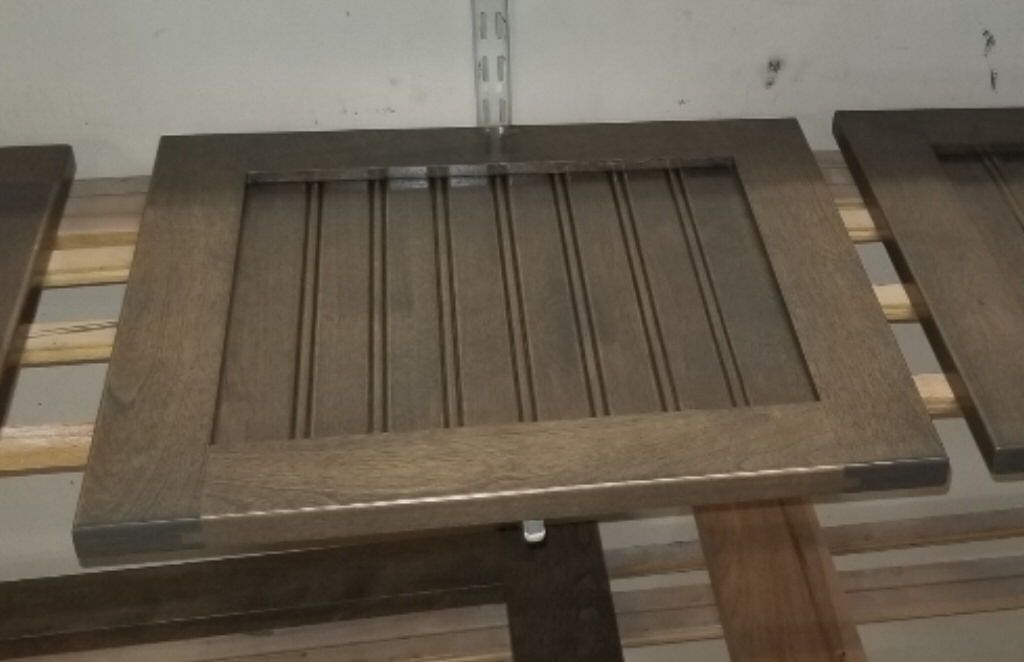

I had to make some beaded panel doors. I used a Point Roundover Router bit. It was solid carbide with an 1/8"R by Amana (#56125). I spaced these beads at 1.5" on center. But you could just as easily put them one after the other by using 1/4" spacing between cuts (really 0.28" spacing) and make reeded panels or full drawer fronts or doors out of them.
It would be insane to try to do it without a CNC.
View higher quality, full size image (1024 X 662)
