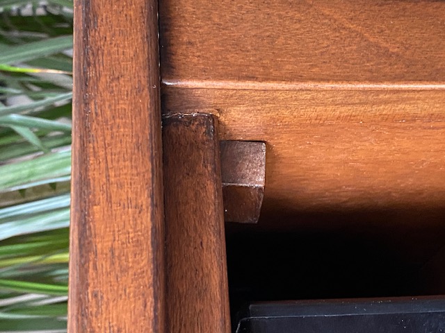

(1) Attach a block of wood behind the frame making sure it drops down below the frame to act as a stop.
(2) For appearance's sake, many cabinet makers will install a strip of wood that runs completely from left to right, behind the frame. Again, it will drop down below the frame to create that stop that you need.

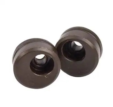

(4) The simplest way to fix this is to use the inset door stop made by Fast Cap hardware. This is a small black rubber disc that can be attached to the top and bottom of the opening to stop the door from over closing. It is adjustable via eccentric holes.

Fastcap Doorstop
4/3/24       #5: Inset face frame hinge problem ...
These
Inset stops

It's what I've been using for a decade now. I don't think the one's I get are Hafele as I get them from a local supplier. But they are the same. On occasion I've had to cut off one hole or bend them to get the desired result in some oddball situations.
So much better than wood blocks.

I posted the link to Woodworkers Hardware for the Fast Cap discs since Liz seems new to cabinet making and likely doesn't have an account with Hafele or other traditional distributors. Woodworkers Hardware is a great retail source for the occasional onesie/twosie buyer.

I was shocked I couldn't find them on Amazon. They are in a few places other than Hafele if you search.

I just make a stop with a little scrap and glue & screw it to the back of the face frame or side of the cabinet. Takes maybe 2 or 3 minutes and I don't have to buy anything.

Sounds like you are looking for a stop block. When we do inset we rip in our lineal faces frames an additional lineal of 3/4 x 1 1/4 for stop block. We have a router table set up that rabbet a strong 1/16" x 1/2". Door bumper thickness. This gets nailed on when cabinet is finished sanded and doors are ready to install.
