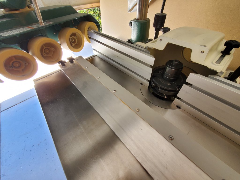

Yavuz Member
Freeborn split body carbide insert tooling.Jet 5 hp 1-1/4" spindle.similar to your shaper. One of the reasonably priced quality tooling.
Split body is a big improvement over single body non adjustable one. Once you try you will never wanna go back to headache :)
