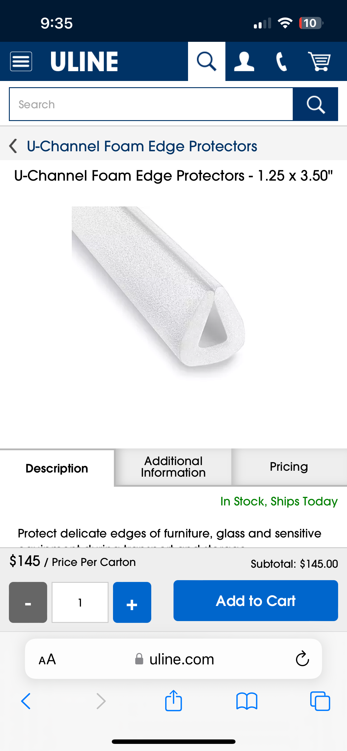

We mostly used blankets for years, but I’m hauling shutter panels mostly, occasionally a closet system or cabinet. I’m finding it more and more difficult to find quality blankets. Now some of the brands will leave a blue or black lint, which brushes off, but it’s an annoying task. Plus some dyes on newer blankets will transfer to a finish that’s fresh and not completely cured. I prefer the old style quilted blankets when I can get them. But lately we have been buying u channel foam protectors from Uline cut up into various lengths to pad against contact. They work well on panels, don’t harm my finish, but you still have to plastic wrap. But they are reusable for many jobs, and wrap faster than sheet foam.
