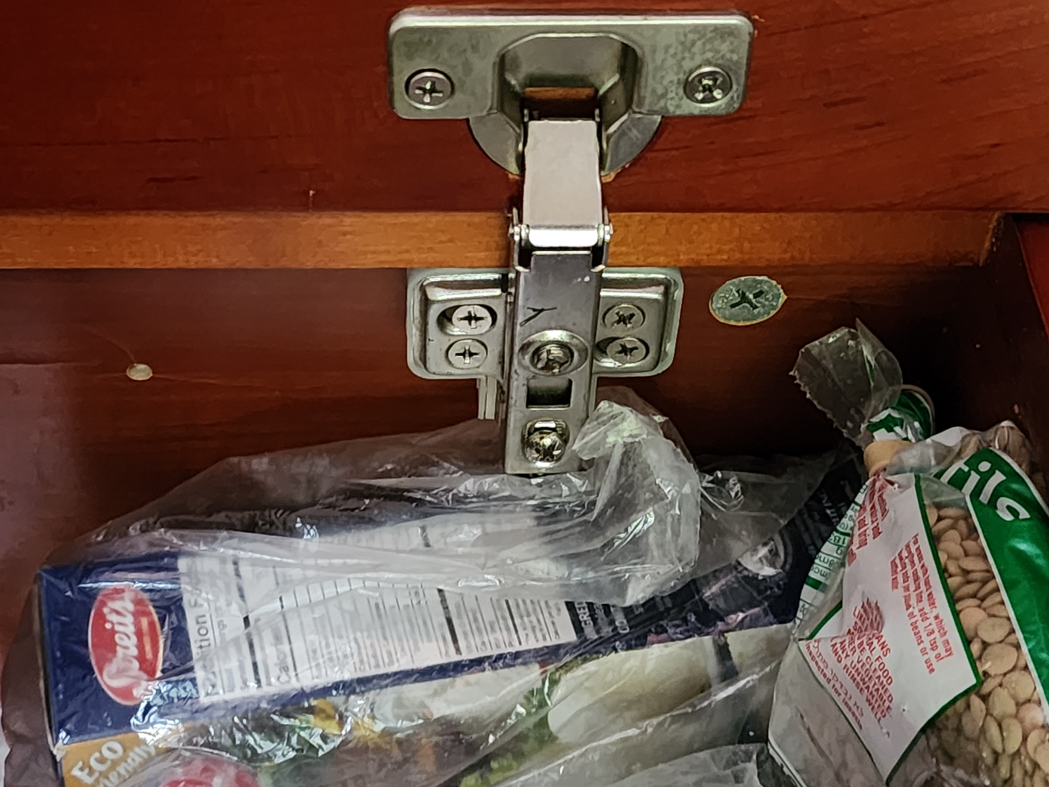

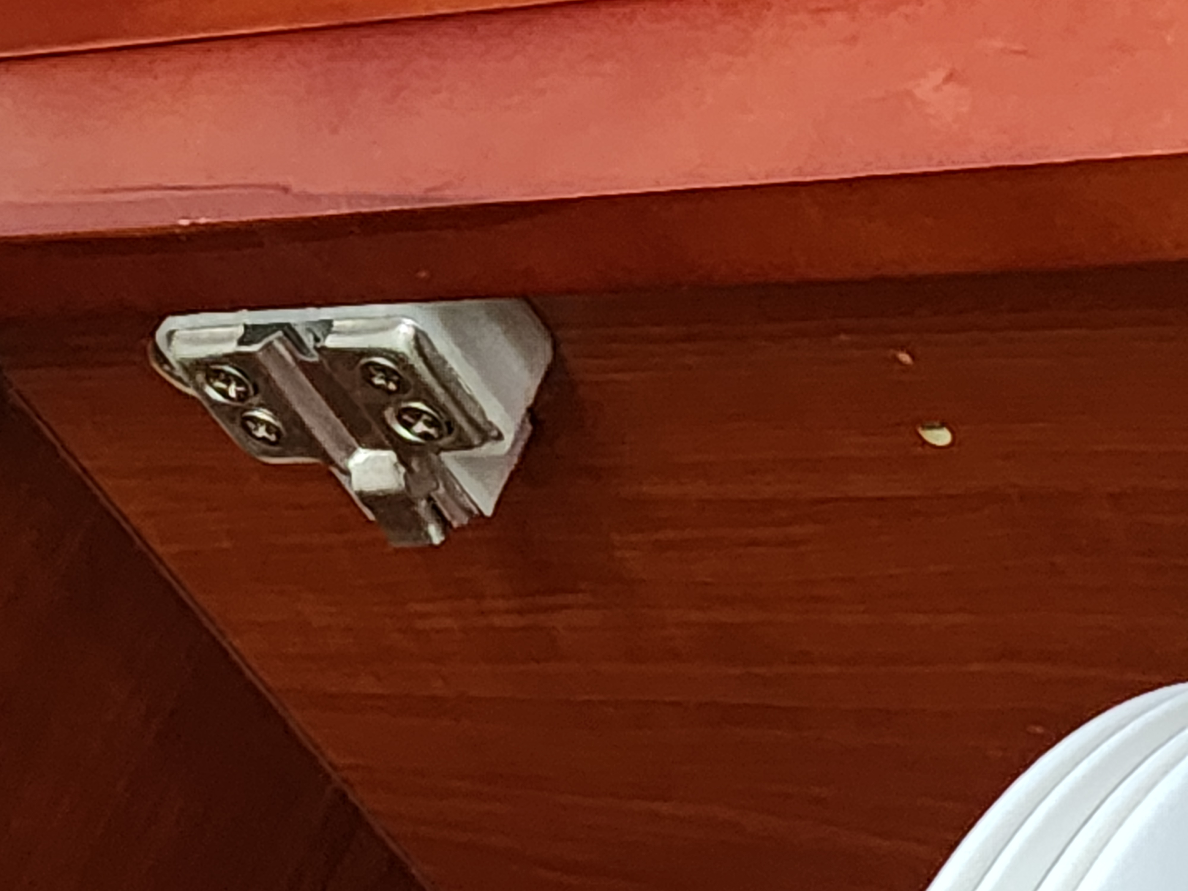

A customer has Chinese faceframe cabinets with frameless hinges with the base plate attached with a spacer. Now, hinges are starting to fail (kitchen was installed 5 years ago) and she wants me to replace the hinges that failed with ones that are most similar. She is thinking of maybe adding a soft close option too. Would appreciate any advice for hinges that are most similar in terms of look.

Looks like you can use face frame hinges? Problem is going to be the door & trying to match the holes that are there now. Measure the distance between the mounting screws that will at least get you close.

I don't believe she would be willing to mount base plates on the frames. Regardless, thank you for the reply.

Hey Bill,
First, you will not find a direct drop-in hinge to replace these.
I say this for 3 reasons.
1. The hinge boring pattern in the door is not in the standard pattern used in the U.S. These were made for the European or other markets in the world. Probably for the China market.
As a result, you will need to fill the current screw holes in the door then move the location of them to the American standard pattern of 45mm X 9.5MM.
2. You will not be able to use any face frame hinges on the market today as I can see the edge bore distance from the door edge to the 35mm cup is much larger than can be used for a face frame hinge. In the photo it appears the edge bore distance is 4-5mm. Most face frame hinge have a maximum edge bore distance 0f 2.5mm
3. Switching to a soft close hinge will also be a challenge as most soft close hinges on the market have very specific cup drilling depths. These may or may not have the correct drilling depth to accommodate a soft close hinge.
I would suggest starting fresh as though you were installing the hinges for the very first time and ask yourself the basic, required questions:
What is the overlay for each door?
What opening do you want 94, 110,
120 or 165
How thick are the doors?
What is the current edge bore distance?
What is the current cup depth. (In mm)
Which hinge and mounting plate (Thickness) is needed for the doors to overlay properly?
That funky spacer should not be needed if the correct mounting plate thickness is used.
I would be happy to assist once you have the answer to the above questions.
