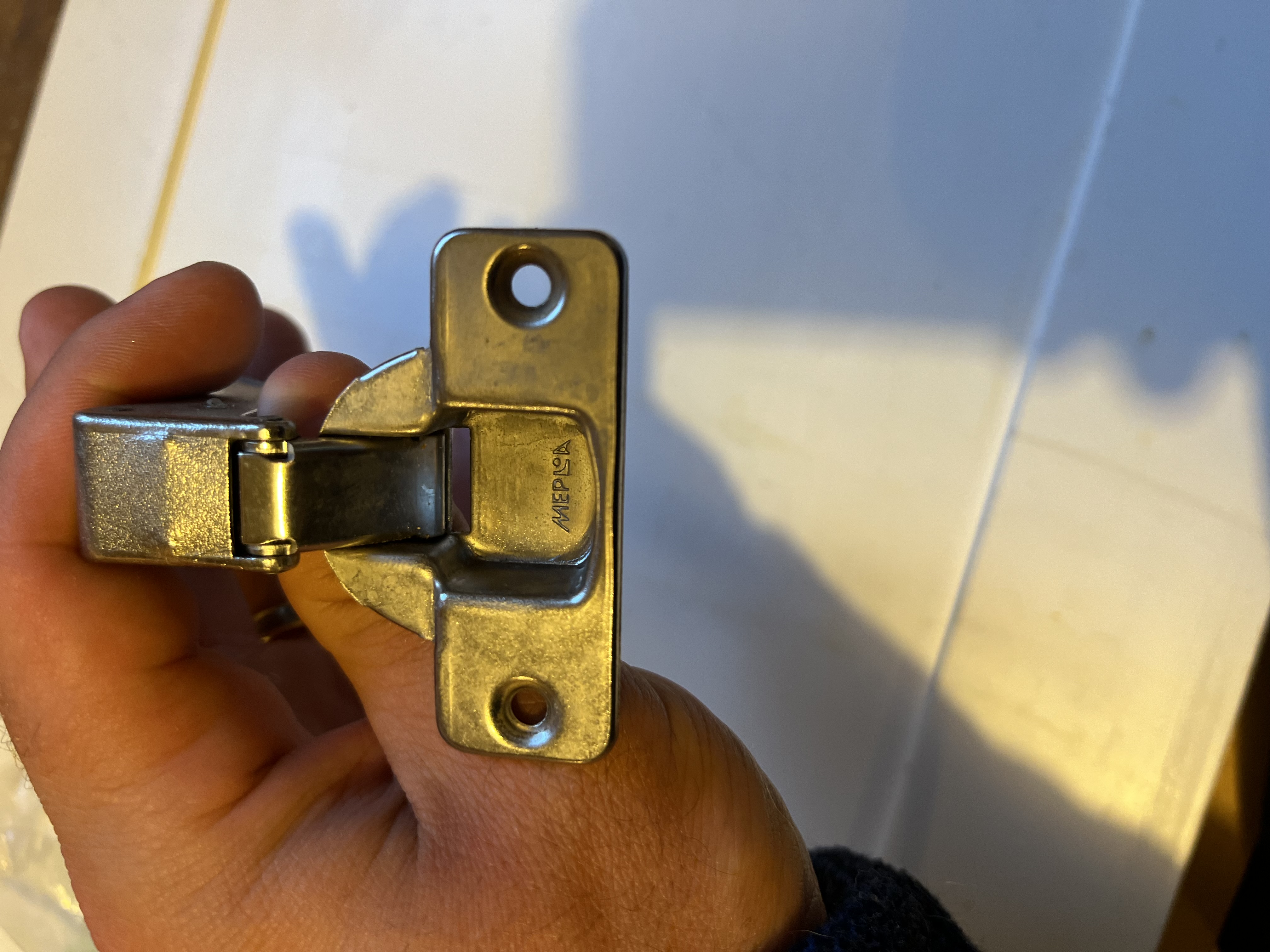

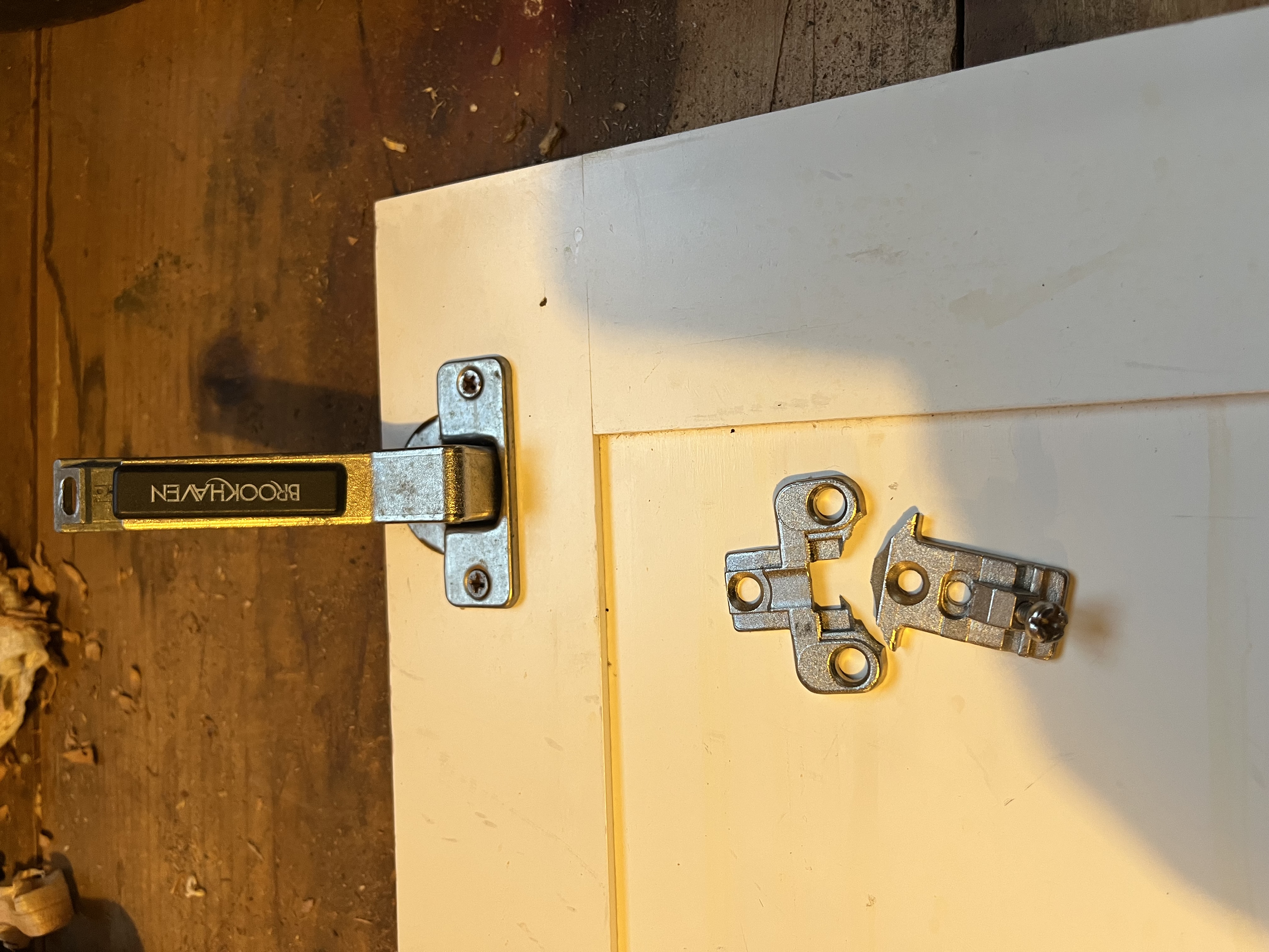

I'm looking for some info on where to find Mepla corner hinge. I was told Salice might be a close second, or there might be someone on here that could help. I'm trying to find a replacement for a corner cabinet hinge below my sink. If this is too hard to find in small quantities, does anyone know the closest pattern that I could find in quantity of 1 or 2?
For reference, the cabinet swings open from right to left. The top left hinge bracket broke in half. See pics. If any one has any hacks to "get me by" that would be awesome.

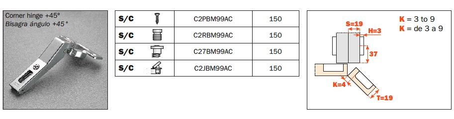

From your photos, this appears to be a +45-degree corner hinge.
Mepla has been out of business for many years so finding a Mepla replacement will be a real challenge.
Salice may possibly have a hinge to use but to accurately ID your current hinge, I will need to see a good side view profile.
There will be one difference in that the hole pattern in the door will not match up but, this is not a deal breaker. We can work around this.
