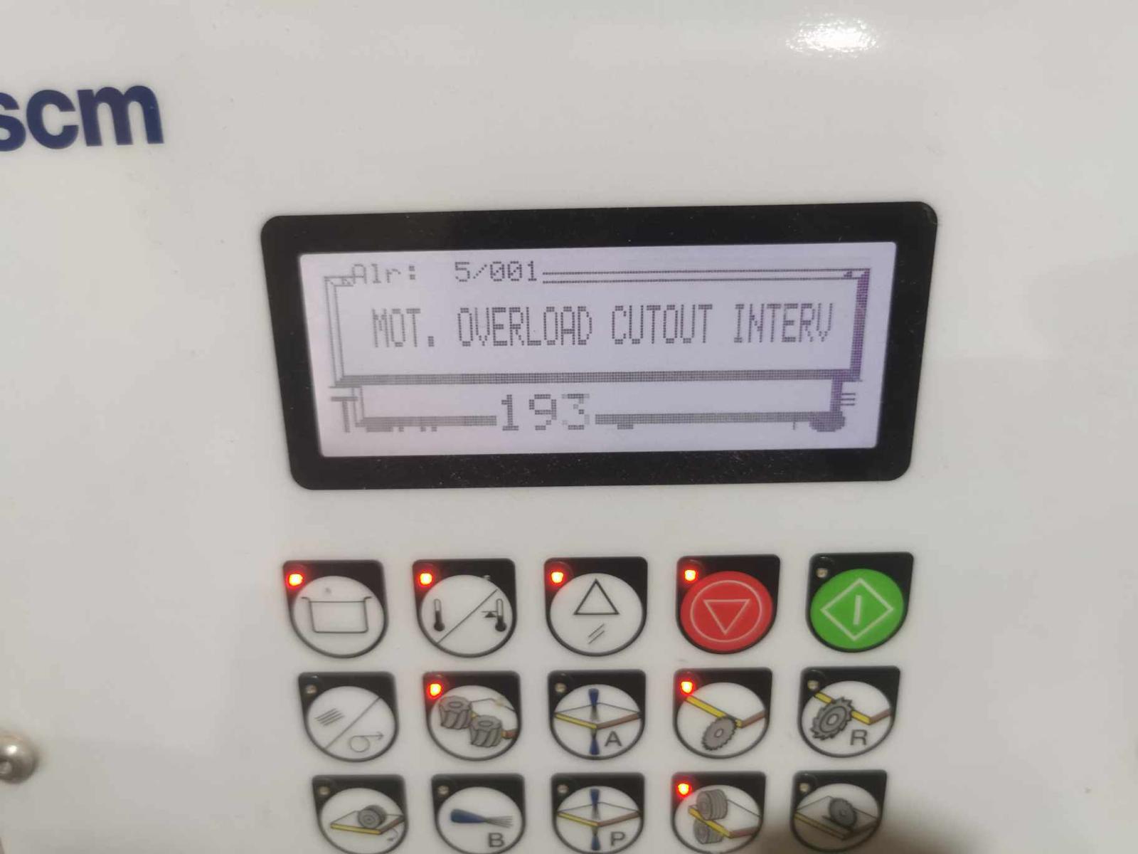

Hi guys,

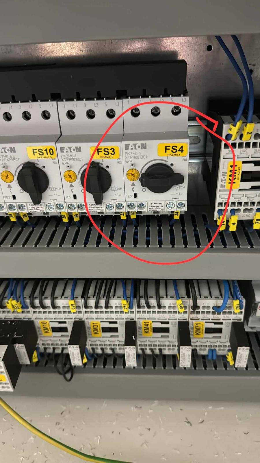

Minimax me 40 keeps randomly shutting down with error code 193 saying
Mot overload cutout interv and switch fs4 goes off. Any suggestions would be appreciated

Check the heat on the motor that the switch controls. You may have a bearing seizing or something else causing it to draw a higher load.
