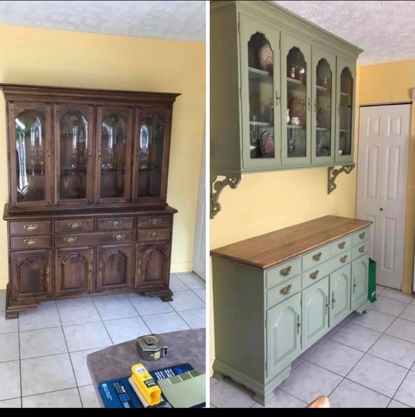

I saw this idea on Facebook and have been trying to figure out how to actually do this. Someone took an antique two-piece China Cabinet and hung the top half on the wall above the base to create a beverage station. I'm assuming they used a French cleat to hang the top half. You can see where they used a couple of corbels to help support the bottom.
My question is how would I reinforce the back to support the weight? These were obviously made to sit and not hang. I would assume it would need to be framed somehow on the inside, but with what and how?
I've attached a picture to illustrate this idea.
Any advice would be greatly appreciated!

The back would have to be recessed for a french cleat to work. Another way is to add a 1 1/2" or 2 " wide horizontal cleat under the cabinet top and above the cabinet bottom and screw to the wall though them. Make sure the cleat is adequately fastened to the cabinet. Also make sure the cabinet top and bottom are adequately fastened to the sides.

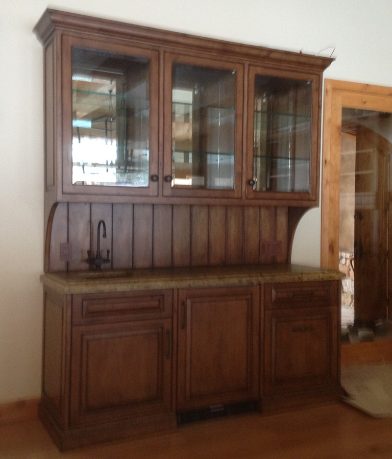

On this piece, I used a piece of steel angle screwed to the top of the cabinet through the lid into the top back rail, and then horizontally into the wall studs. The crown molding was held up 1.5" to conceal the steel. I couldn't screw from the interior because of the mirrored back. It was also screwed to the studs though the backsplash.

To reinforce the back of your China Cabinet for wall mounting, consider adding a sturdy frame using 2x4s or plywood inside the cabinet.Attach the French cleat securely to the studs in the wall and use additional supports like metal brackets or corbels for extra stability.Ensure the weight is evenly distributed to prevent any wobbling or sagging.
8/20/24       #6: China Cabinet Reinforcement ...
Make the back as a frame and panel, with 2-1/2” or wider members mortised joinery. Run three verticals to make a four opening frame, matching the openings in the front frame. The joints should have 1” or longer tenons, or go buy steel. Then, glue in the ply or veneered panels with a full perimeter glueline and nailed in place.
This makes a back that can carry the cabinet. I would use at least six screws, into studs. French cleat will also work, but will eat up some interior space, and is not needed if you build a rigid back.
