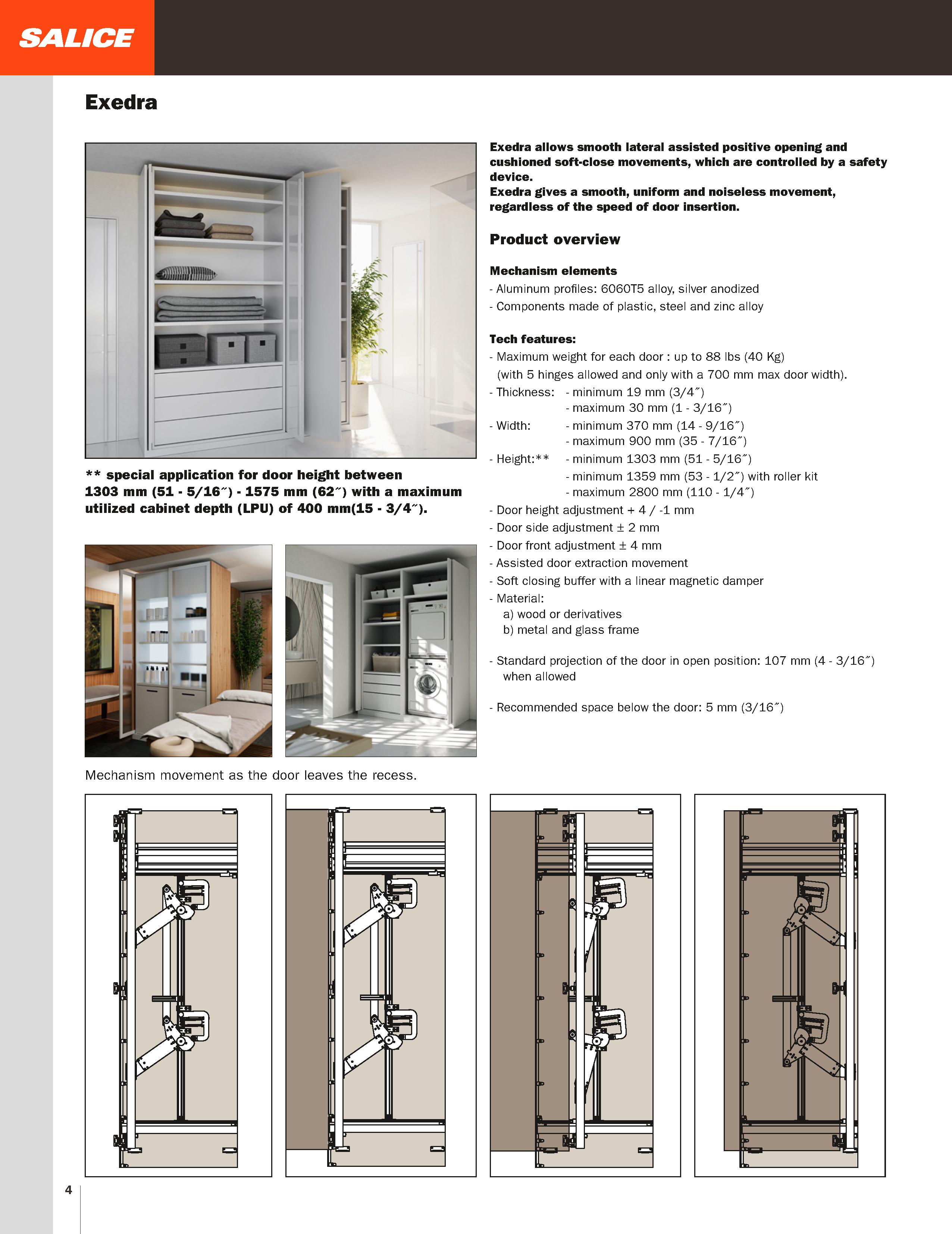

Hello Matt,
The Salice Exedra pocket door hardware is perfect for this application. Exedra is exceptionally smooth in operation. Salice will assist you every step of the way to insure you make the correct selection.
Please see the link below to detailed specs for Exedra. I have also included an "order" form that you can complete. This will allow our engineers to fully understand the details of your project.
You are welcome to contact me any time with questions

View higher quality, full size image (2552 X 3308)
View higher quality, full size image (3508 X 2481)
Salice Exedra Pocket Door System

Dennis, thank you very much for the reply. I have a question, my door is 47” tall, will this hardware work for that height? It says on the specs you provided minimum height of 51 5/16”. Looks like a slick system.
8/28/24       #5: Full overlay pocket door hardware ...
Hi Matt,
Sorry, I overlooked that detail in your post. At this time, 51" is the minimum. I hope we can assist with your next pocket door.
