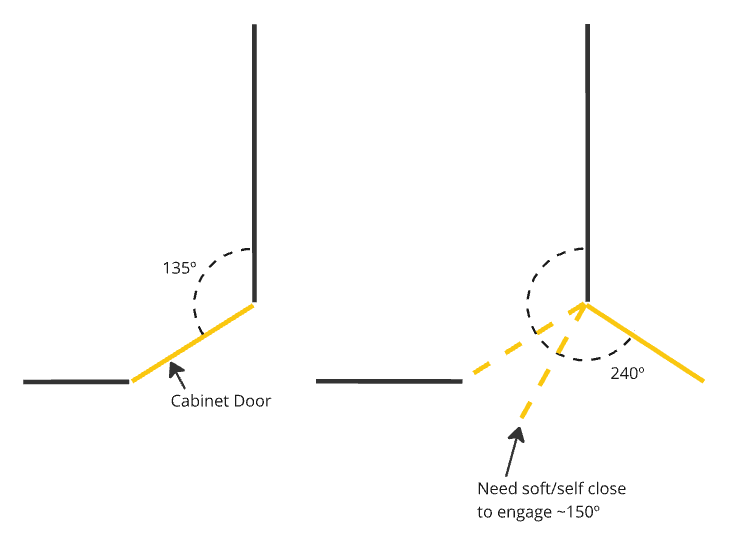

Hi everyone. I have a cabinet in the corner where the 2 boxes meet. The door is 1 panel and is not a lazy susan style. I'd like to put a soft close hinge on it. When the door is closed it sits ~135 degrees from the box. The soft close mechanism would need to kick in around ~150 degrees from the hinge attachment to the box. I've created a picture I've attached. I'm not a cabinet maker and not sure which high quality soft close hinge to buy. Can someone point in the right direction?
Thanks!

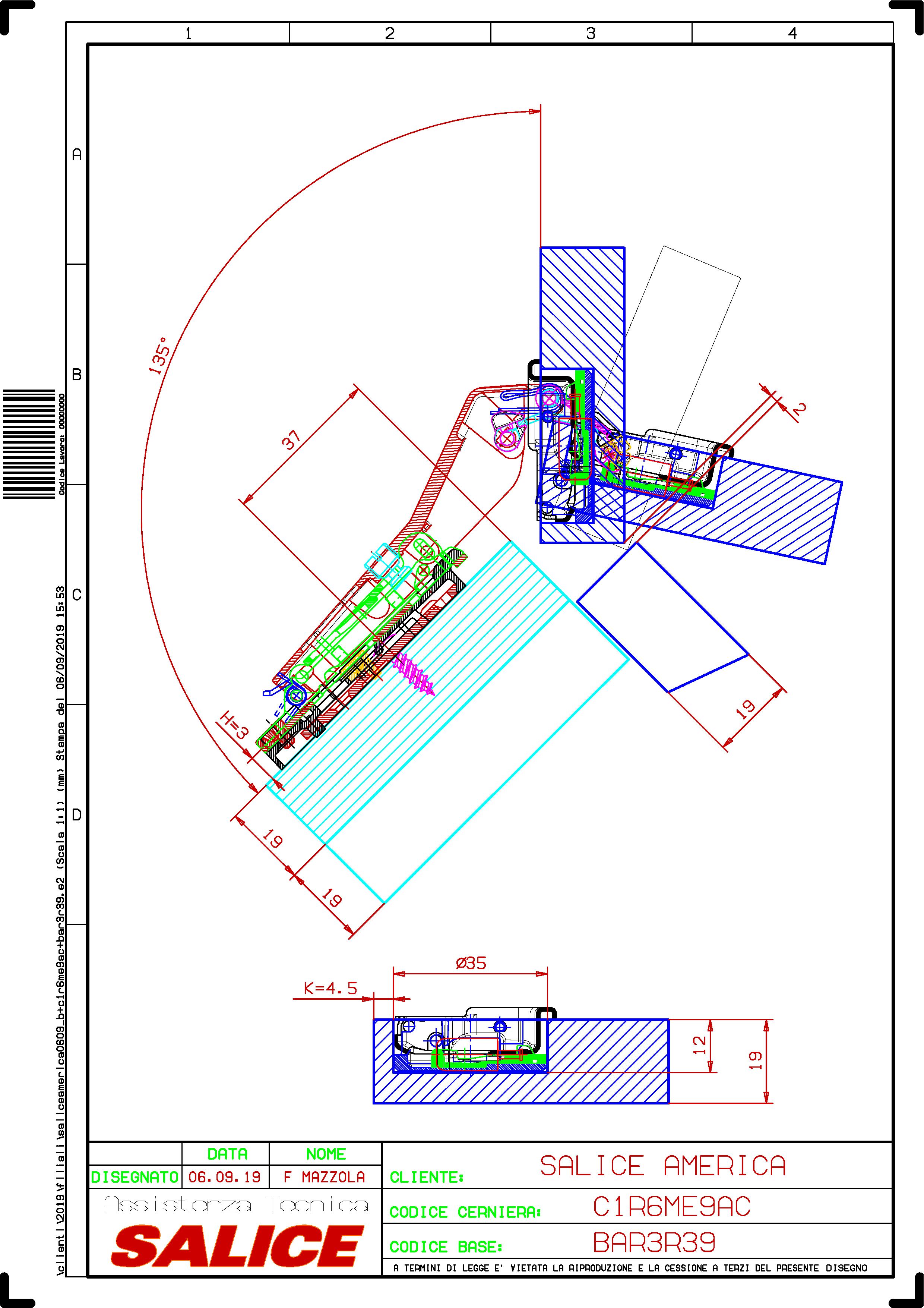

Hello Ryan,
Unfortunately, what you are proposing is not possible with any brand of soft close hinge on the market.
Salice offers a 270-degree hinge, but this cannot be mounted with this 135-degree angle. It must be mounted on a square box. This hinge is not soft close.
This hinge is also not fully concealed.
Salice does offer a soft close hinge that can be mounted for a 135-degree angle like you show. This hinge opens to 90 degrees from the closed position, not 240 degrees. This is true for other brands as well.
Here is an example to the application.
View higher quality, full size image (2480 X 3509)
