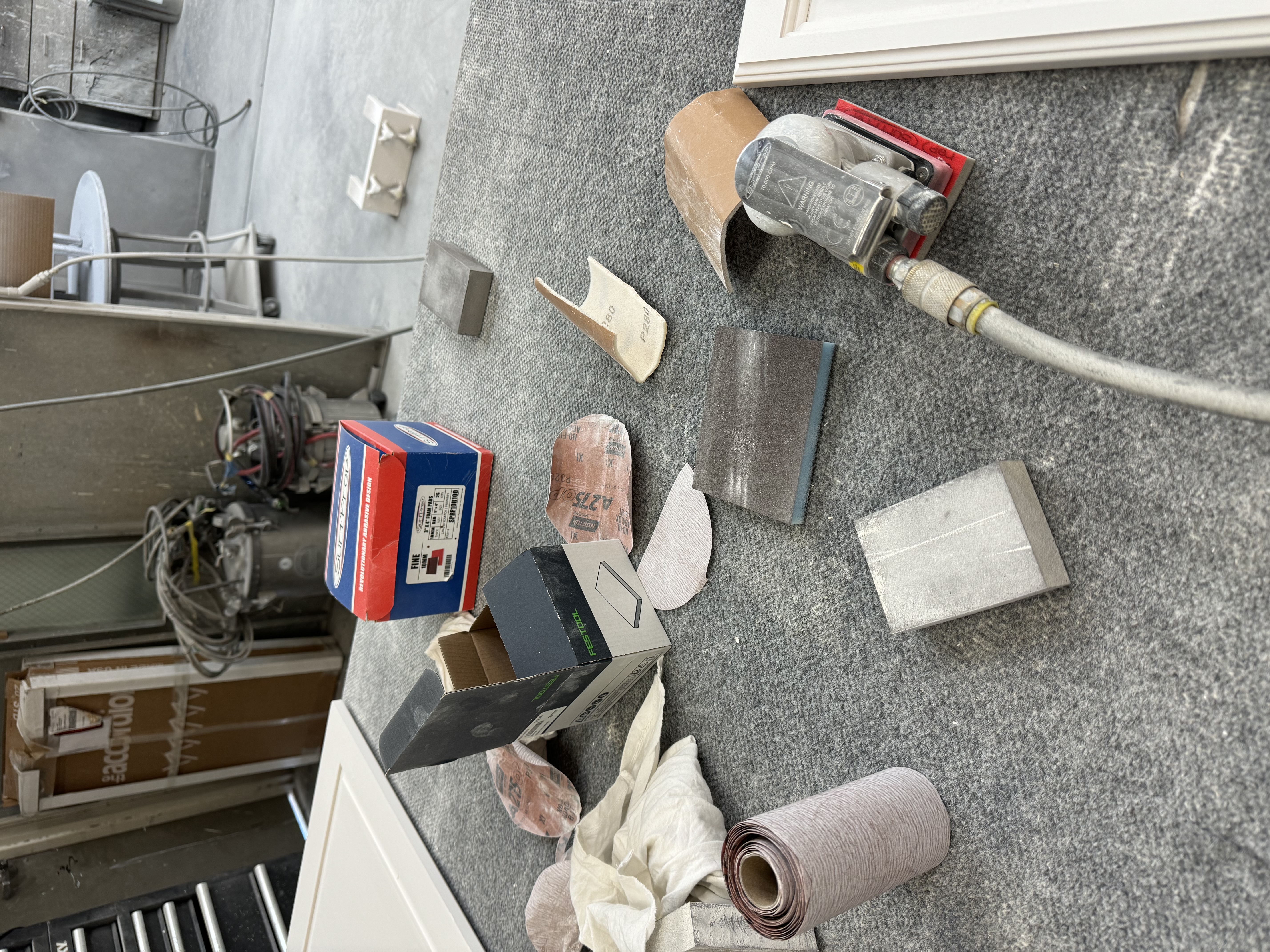

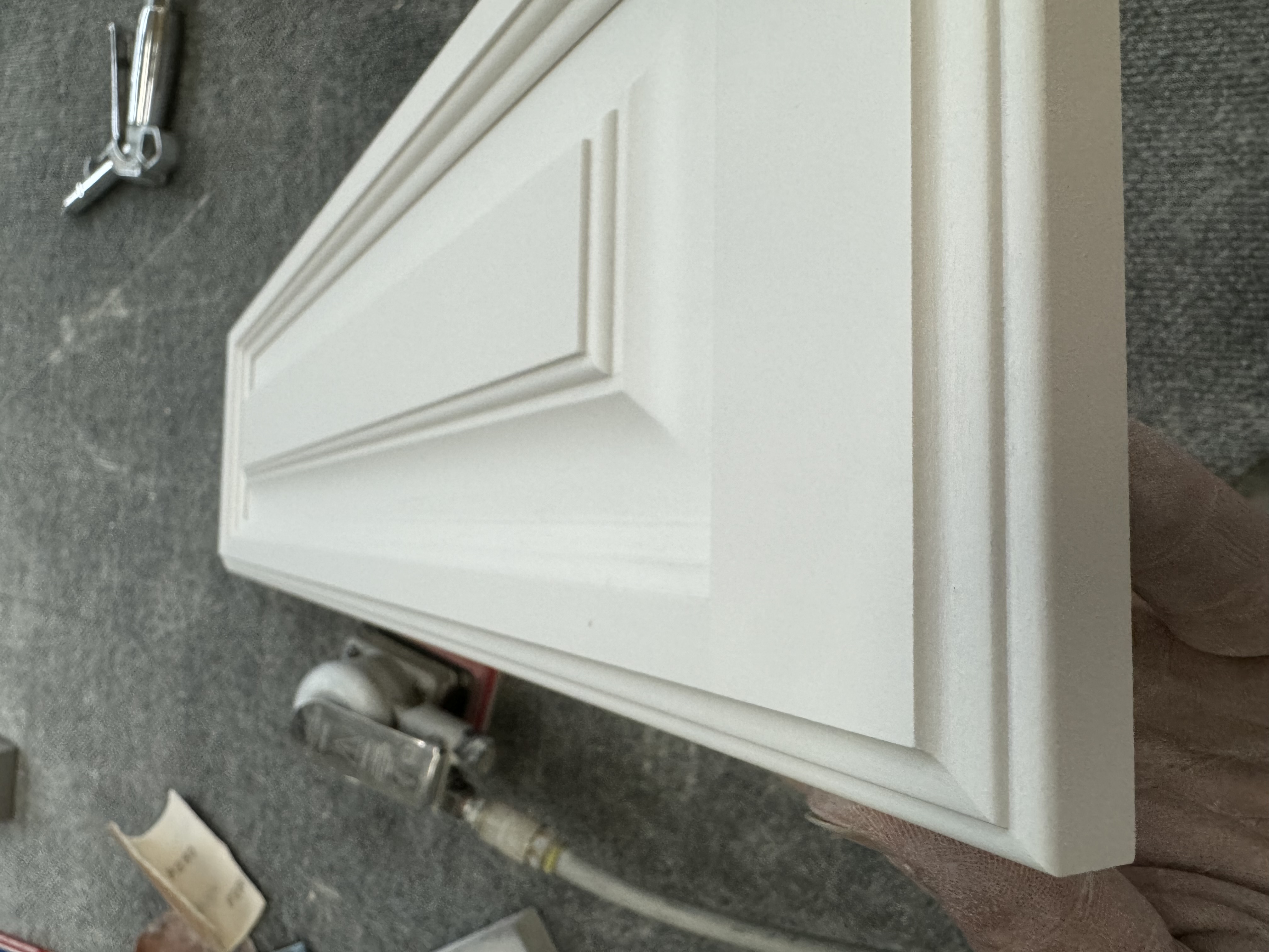

How are you guys sanding complex cabinet door profiles after primer?
I’m going to start this thread with saying, I’m normally not in the paint department but as you can see from my photo I have tried a few different things. Hand sanding with a 1/2” foam sponge seems to work best but is terribly slow.
I only have 10mm pads for the surf prep sander. They don’t flex enough and burn through quickly.
It’s been such a pain I don’t even want to do another primer coat. I looked at flap wheels online and the supermax brush sander but I don’t want to waste money if it’s not going to speed this up in the future.
There has to be a better way…

I don't know of any "easy" way to scuff profiles. Usually it's by hand and I use Mirka Goldflex for most of the operations. Square corners, shoulders I use P320 folded over on itself.

There is an actual tool designed to sand multi profiles for use in the finish process, hand held with air motor, Fladder, Micro 150/50 model. I have used this tool for over 30 years. We use the 320 grit set up to sand clear sealer & primer. Use 150 grit on parts prior to 1st finish coat prep to accept stain, sealer, or primer. Use same 150 grit at the exit end of our wide belt to touch fancy miter profiles on face side of door after sanding the backs. Tool is $$ but will be the best money spent., Replaced our 1st 3 tools after 25+ years of service only due design change and Fladder offer 50% trade to upgrade.
Company is located in Atlanta area, may need search for Hansen & Hundebol Inc, select USA web site. This will be the USA importer of tool & sand paper from Denmark.
