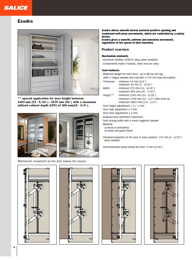

You may want to take a look at the Salice Excedra pocket door system. It has become quite popular, and Salice will work with you every step of the way.
Salice assembles the hardware for you, customized to exactly what you need.
If you would like the full details, please let me know.

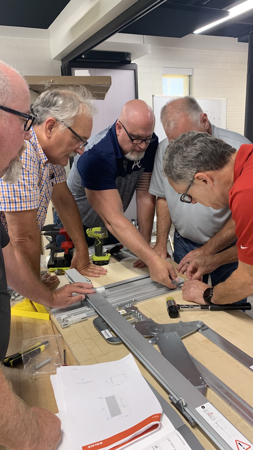

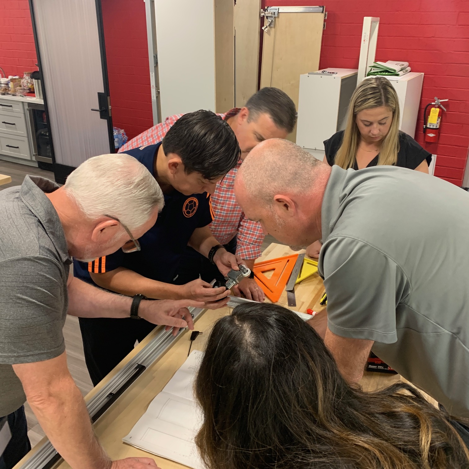

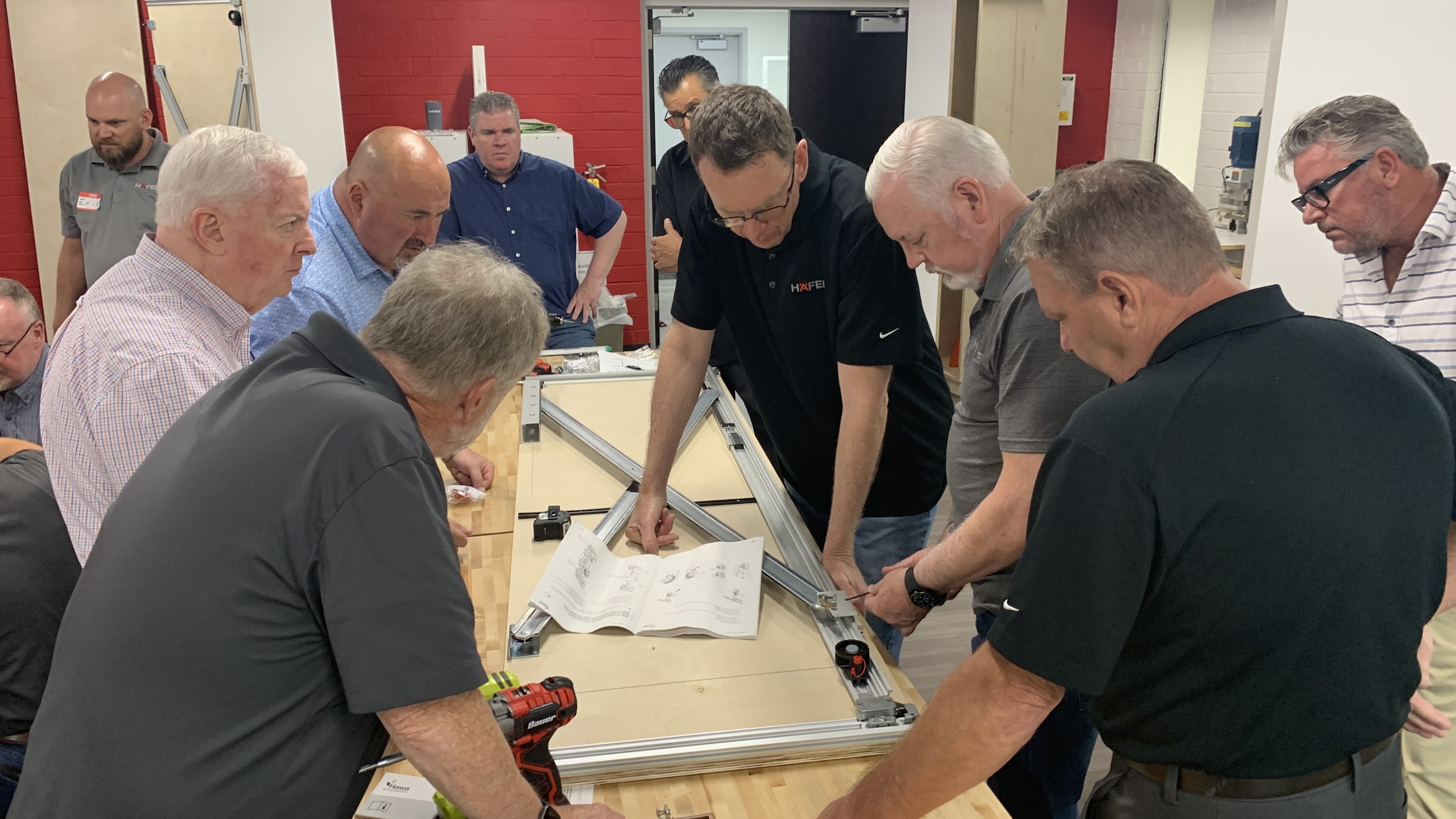

I'm one of the trainers at Hafele America Co and last summer we did several workshops for our sales reps where we installed pretty much every pivot/pocket system on the market; started with antient wood followers and rack and pinion systems through all of the current systems including the Blum Revego, the Accuride 1532, the Salice Exedra, several Hafele Slido F-Park products and the Hawa Concepta II and the new Concepta III.
While all of them have their advantages and disadvantages, in my 35 years of installation experience I have never installed an easier system than the Concepta III. I suggest you chat with your Hafele rep and give one of the new systems a try.

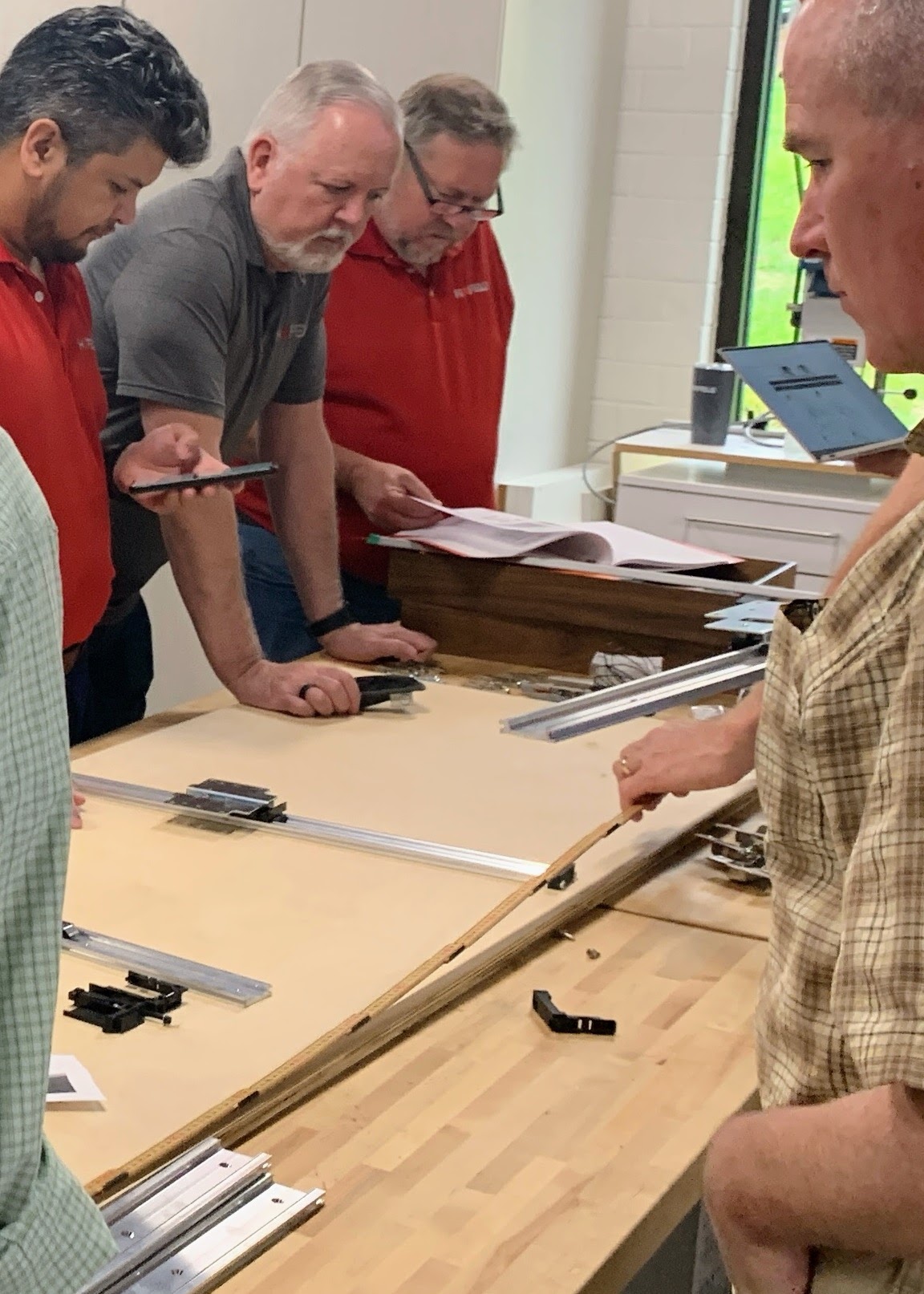

BTW, if your design allows for an inset door, the Accuride 1532 is by far the quickest and easiest to install, in part because it installs inside the cabinet. If you’re installers are familiar with the installation traditional furniture pivot/pocket door system, such as the Accuride 1332/1432 or the Häfele XL pocket door system (now called the Häfele Slido F-Park 71 16A), they will find the 1532 to be super intuitive and outrageously quick to install in comparison to all the others in a similar weight and size class. In fact, that system is capable of handling an almost 10' tall door! We did a workshop with a OEM cabinet manufacturer in Pennsylvania comparing a variety of the current pivot/pocketing door systems on the market, and their final conclusion was that the Accuride1532 was the right system for them. Because of their prior experience with traditional cabinet pivot/pocket systems that their installers took to it like ducts to water!
