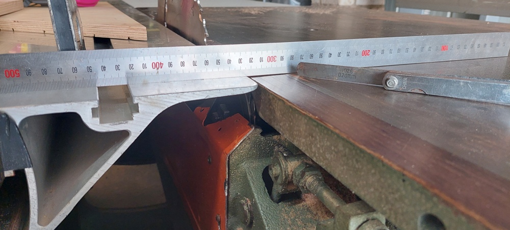

I have a 1991 Altendorf F45 panel saw. I am asking for help as to the sequence of adjusting and aligning the various adjustments.
I had a tech come in initially to get it in the ballpark but I feel I can go from there and do a more accurate adjustment myself with some advice.

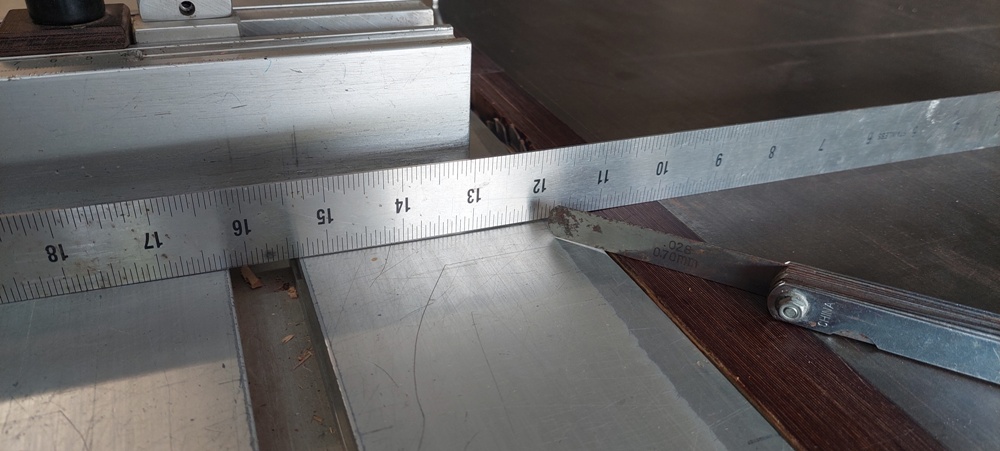

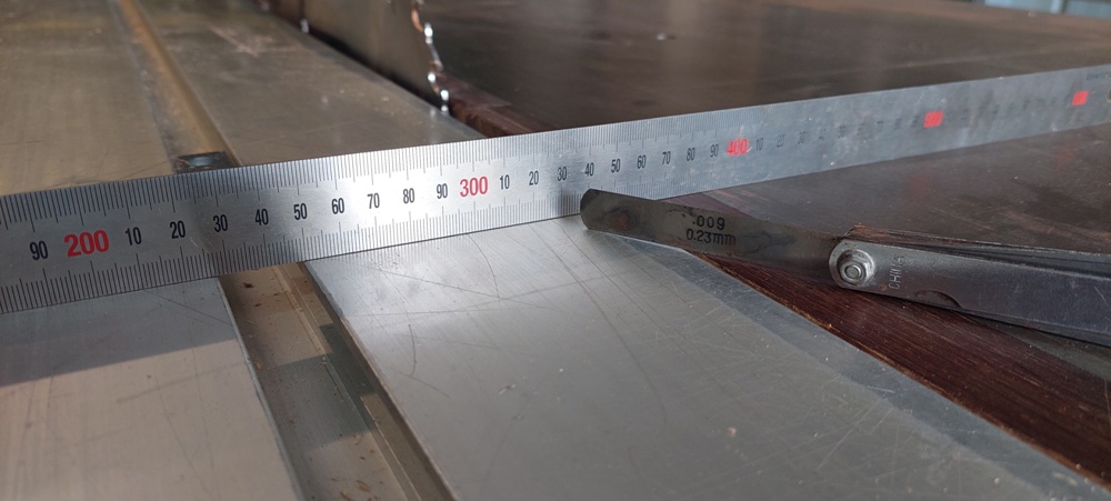

At the moment when I move the sliding table all the way to place a sheet in for cutting(start of sliding), just back from the scribing blade, the Sliding Table is higher than the Machine Table by about .7mm.
When I move the Sliding Table to the middle, just before the scribe, the Sliding Table measures .23mm lower than the Machine Table
When I move the Sliding Table to the end, the Sliding Table is .7mm higher than the Machine Table. I have included some pics for discussion.

I would start with levelling the fixed table of the saw first. Next I think I would align the carriage travel parallel to the saw blade.
Before you start setting the height of the sliding table check the condition of the nylon bearing wheels. There is probably a spec for acceptable diameter online or you can just measure the difference in what you have. They are a wear item so you might want to replace them. Also check the condition of the phenolic ways on the underside of the table and on the table support. One clapped out saw I worked on was so badly worn in the centre that I couldn't take up the slop in the mid stroke without the saw binding at the ends.
I can't remember how to raise the carriage or table but you never want the slider dropping below the fixed table. Before you shim the table run the slider through its stroke with a sensitive level at right angle to the blade. If the level changes through the stroke then the outrigger pivot arm height needs adjustment.
Get the slider above the fixed table by .3mm then adjust the rollers on the ends to keep the table close to that gap. The load on the slider will influence this.
