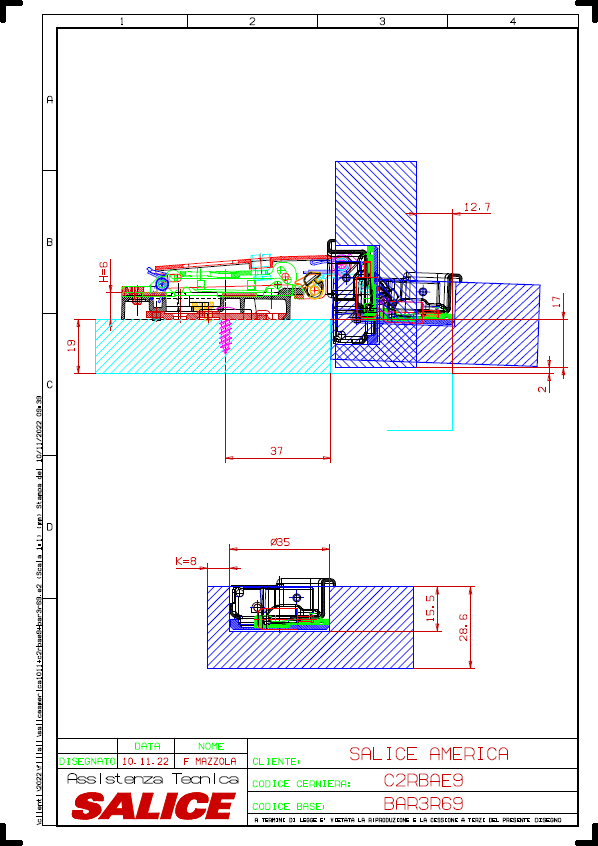

Hoping Dennis is reading. Doors are
1-1/8” thick with slight round over on edge. The hinge I was planning on using is 94 degree with 35 mm cup, soft closing. Can I maintain 1/8” gap between doors using this hinge?

Hi Al,
The 1/8" gap between doors is fine. Here is a drawing illustrating the details.
This illustration is using a soft close hinge.

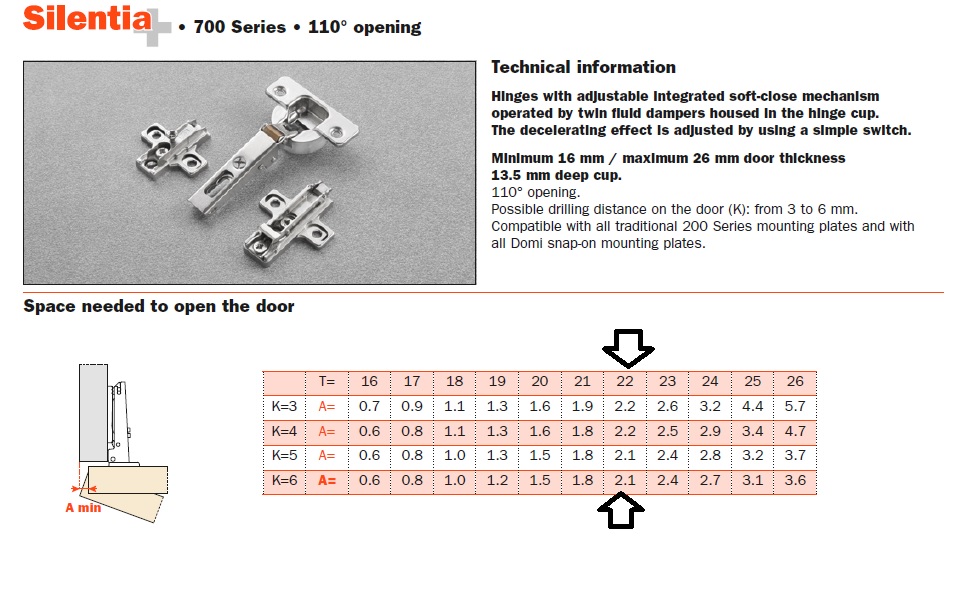

On another hinge question. Salesperson sent me a skinny shaker door. It is 7/8” thick and he said no problem with hinges.
My normal hinge is 110 soft close. What do you think?

No problem if there is room in the door stile for the 35mm hinge cup.
The maximum door thickness for your 110 degree hinge is 1".
You will need to leave 3/16" between 7/8"doors to open without rubbing.
Dennis
