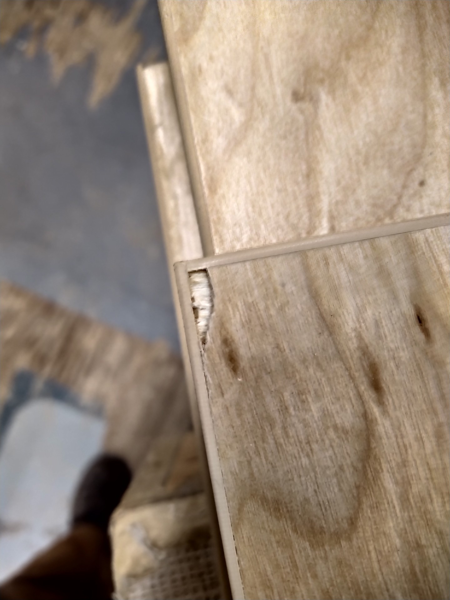

My edgebander has started chipping the veneer on the bottom piece happening from the front trimmer. Even when I adjust the angle so the blade is cutting the edging and is adjusted so that it doesn't contact the plywood, the veneer still gets chipped out. If I turn off the trimmers, no problem.
Has anyone else ever come across this? Its a Masterwood MWB43, Made by Technoma

Cutting on cnc?
4/14/25       #4: Edgebander chipping veneer ...
Michael Hermon Member
Yes, parts cut on CNC. Been using this edgebander for many years without this problem showing up.
4/16/25       #5: Edgebander chipping veneer ...
Bozzy Member
We've had a similar issue recently where the onion skin cut offset 0.2mm from the first pass and the end trim would snag that and chip it. We adjusted the CNC and the problem went away.
4/27/25       #6: Edgebander chipping veneer ...
Derrek
Recently had similar issue. Take a look at the edge, is the chip side protruding slightly from rest of panel?
I had a brand new tool loose the cutting edge near the tip. Still was cutting with nice she so it wasn’t noticeable. Parts were chipping. When we flipped them they wouldn’t chip. Changed tool in CNC and issues solved.
I’ve also had chipping if end trim guides had glue on them and wouldn’t slide smoothy but would grab and chip
4/28/25       #7: Edgebander chipping veneer ...
The problem was being cause by the edge trim guide. I noticed indentations on the edge of the ply where it was contacting the guide which led me to seeing that there was too much force on the guide. Turned down the air pressure and now very slight chipping. Will try changing out the cut out tool and see if that helps. No glue on guide, seems pretty smooth.
Thanks for the input Derek,
Bozzy, not doing an onion skin, small parts are tabbed and then cut out. (vacuum table) Veneer is flush.
