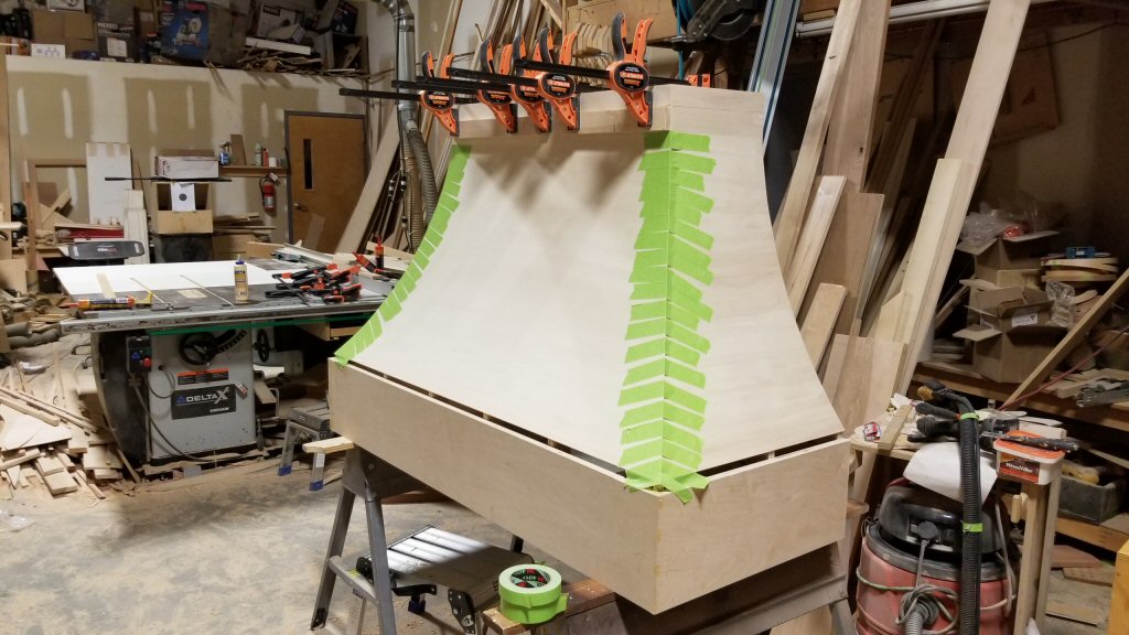

Leo, in your picture I see there's a corner block above your hip rib but it's hard to tell from the picture if the rib is mitered along its length, is it?
If it is, how did you make the miter cut? I've made miter cuts along a curved piece before using a jigsaw set at 45°, cut the curve on one side and flip it and cut the curve on the other side.

Yes it's mitered. I'm sure I used a router bit. The bending Poplar wasn't mitered because it was a painted unit. It was butt jointed. This was done a long time ago and I don't remember exactly what I did. I think I put the side on and trimmed it flush and then overlayed the front onto it. If I was going to do this in a stained piece I would do the same thing but then veneer the piece and still not worry about trying to make a curved miter.
Probably took me about a week to make it and paint it. I haven't made another one with the duel curve on it so I couldn't tell you. Everything I do is custom and I don't do a lot of things more than once.
The closest I've come to making another is the other hood I've put a picture up of. But that one isn't anything near what I think you need to produce.

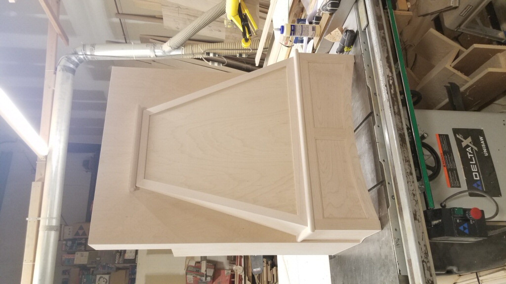

I first posted this back in April I have finally actually started building it. I have built it real similar to the one Leo has posted on here. When I took the job the contractor said that it was to be painted now, he is coming back saying no no it needs to be rift cut white oak. I have already ordered 1/8" Italian poplar for the skin coat going to double layer it. Now my biggest problem is I contacted a veneer supplier and asked about veneering this with the white oak, and he replied that the 1/8" Italian poplar would not be ridged enough to apply that over time it would bubble up in spots on me. I feel I have enough webbing built in this hood to support it but now I'm double guessing myself your thoughts please.
As far as the bottom part of the hood I am able to remove the piece of 6" high maple and replace with white oak rift cut.
