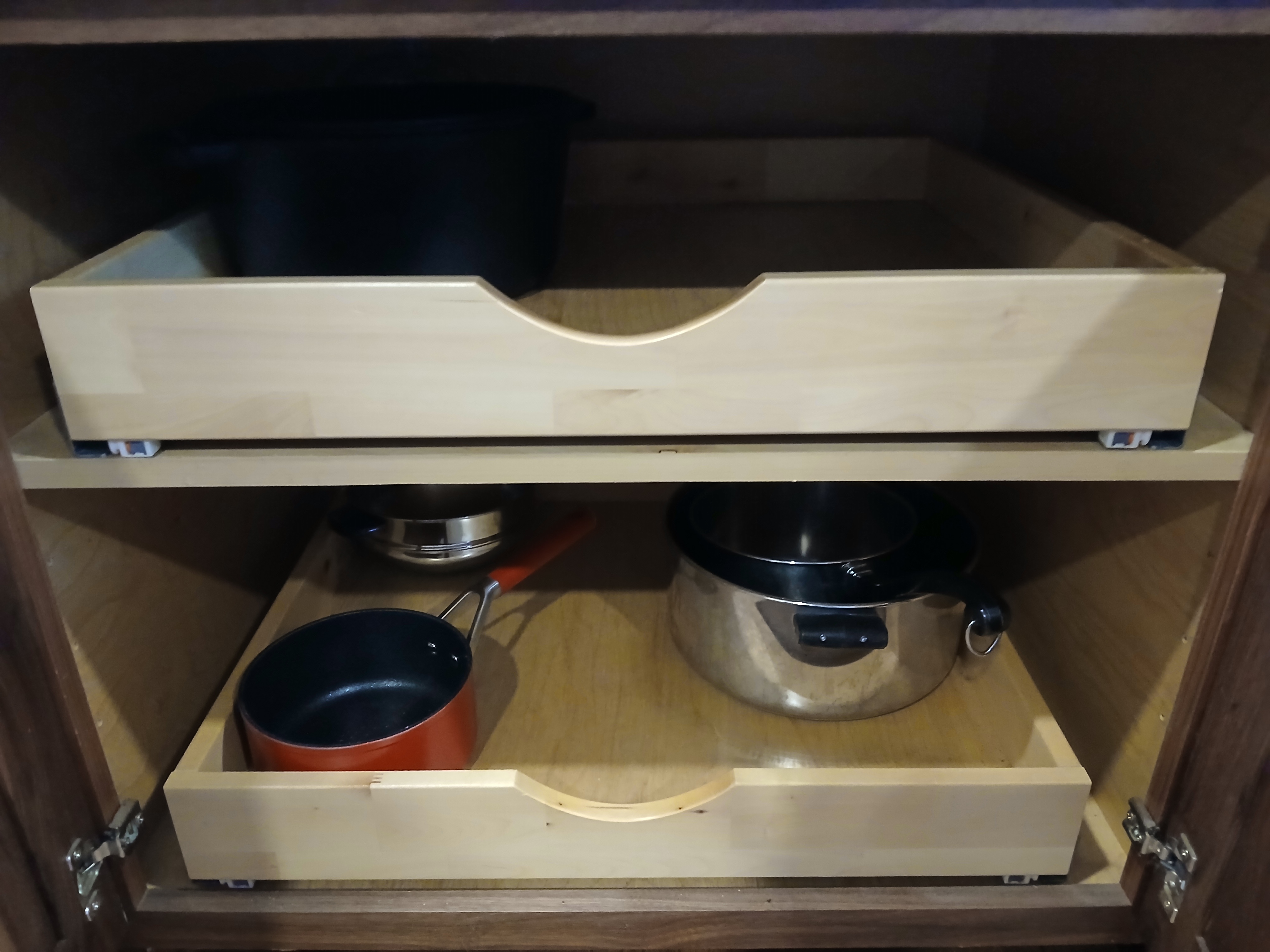

Tony
We mount the bottom one to the deck, then the others are mounted to a shelf. We bore another set of holes in our back row 7/8" offset from the others. Put a shelf pin in that hole to keep the back of the pullout from tipping forward-now the other pullouts are adjustable. Just make your pullout drawer box however narrow you'd like to miss the open doors. I struggled with blocking etc for years until I started doing them this way.

CHRIS
Tony, we did this once. Thnaks for the memory jog. I love the idea of it BUT, how do you keep the adjustable shelf from sliding from the front of cabinet to back of opened doors. When we did this we used the shelf pins with a screw hole variant. I'm guessing its an imperfect wrold and you cant have it all is the answer. Thanks for the responses.
6/3/25       #8: Rollout spacers ...
Tony
Chris-the shelf is stationary, like any adjustable shelf. Then you size the pullout smaller to clear the open door(s).

Tony
By "stationary" I mean the shelf doesn't roll out. The pullout/tray and runners are mounted to the shelf. It sits on pins, with a second set of shelf pin holes offset. Another shelf pin in this hole keeps the back of the shelf, with mounted pullout, from tipping up with the weight.
