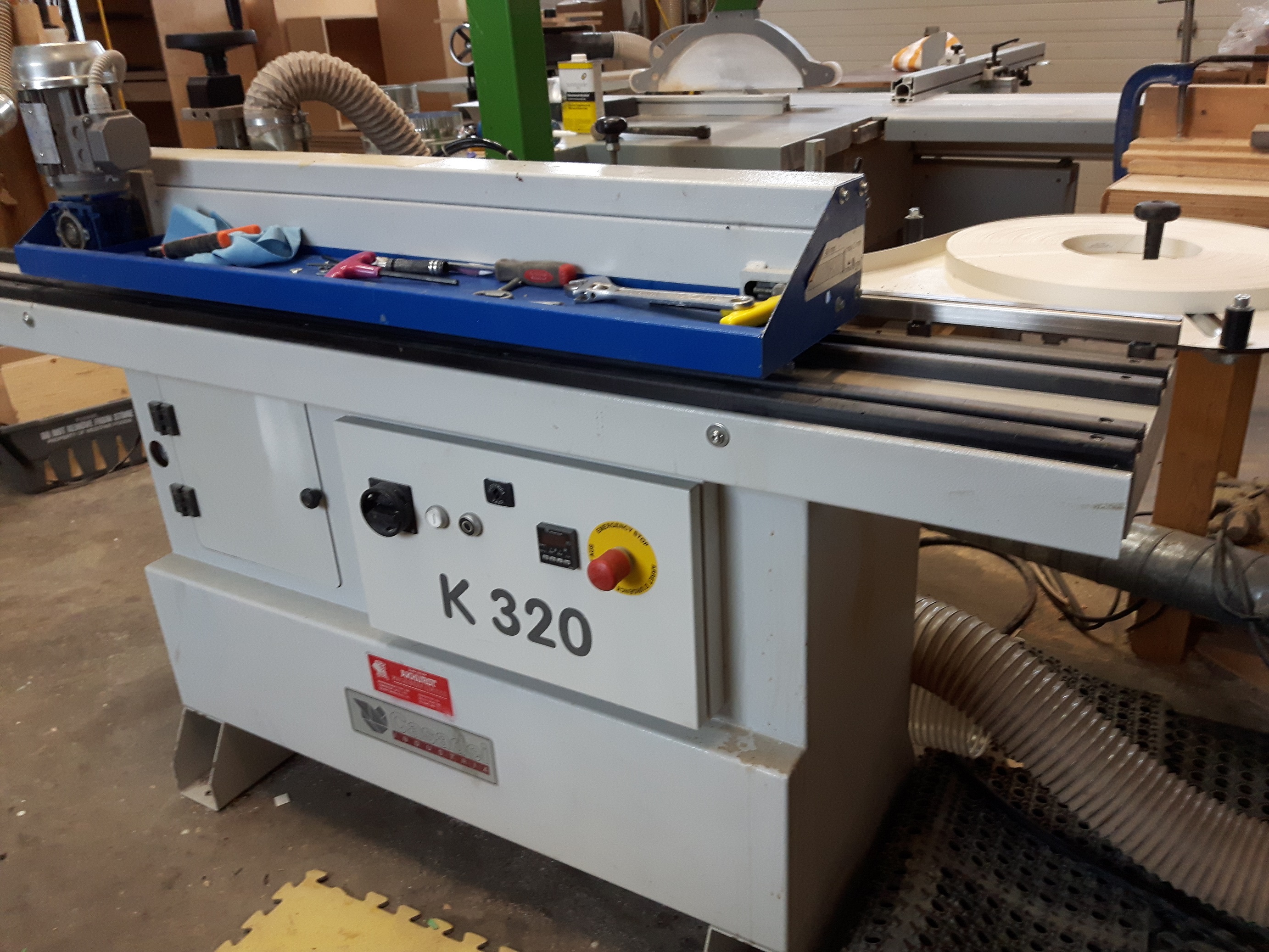

I just got this 2006 small edgebander K320 .
unfortunately it was not very well maintained ... I got it running pretty good but the end trimmer is not working properly , has a guillotine type trimmer , it trims the front well but not the back , it follows the panel but does not cut ...I believe several small bander use this device so hoping someone knows how to fix it ...

picture of the unit

The first thing I would check is the two micro switches that trigger the guillotine. If you are handy with electronics check for signs that the switches are working with a multimeter. Or do as I do and fiddle with the switch and spray with contact cleaner (power off).

Daryl
I have the same edgebander and had the same problem. I fought it for a few years until the main plastic tee fitting on top of the gilotine broke in half, I replaced that fitting and it fixed the problem. I found that the tee had a small Crack and that wasn't allowing enough pressure to the air cylinder.
