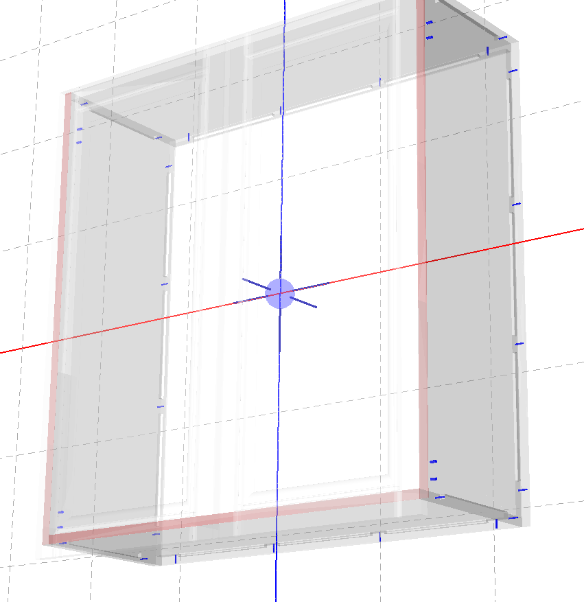

We site-build residential cabinetry from CNC-cut KD parts and use eCabinets software. Joinery is what eCabs calls lock dado, which is blind dado with intermittent gaps, and at the gaps, ZipR screws are used for fixing. The image attached here shows a typical wall box, 40" h. x 38" w. x 14" d. You can see where and how frequent the screws are placed. We use #6 x 2" size screws. Sides to top and deck are two screws at top and two at deck. Sides and deck and top to captured 3/4" back are spaced at about 12" as can be seen. Is this adequate and if not, where should there be more?

I built my cabs that way except only 12" deep. I did not use any glue and had 3 screws on the sides, top and deck.Never had a problem. How is the lock dato working out? I never tried it but thought it worth trying.

Lock dado works well. I asked this because while I had done dozens of kitchens using eCabs and the lock dado scheme, I changed laptops and foolishly backed up incorrectly so I lost all my seed cabs and am starting over.
I'd forgotten how many screws I'd been doing for the wall cabs at the sides for side-to-top and side-to-deck. I'll add one at center by changing the length between in the spec dialog.

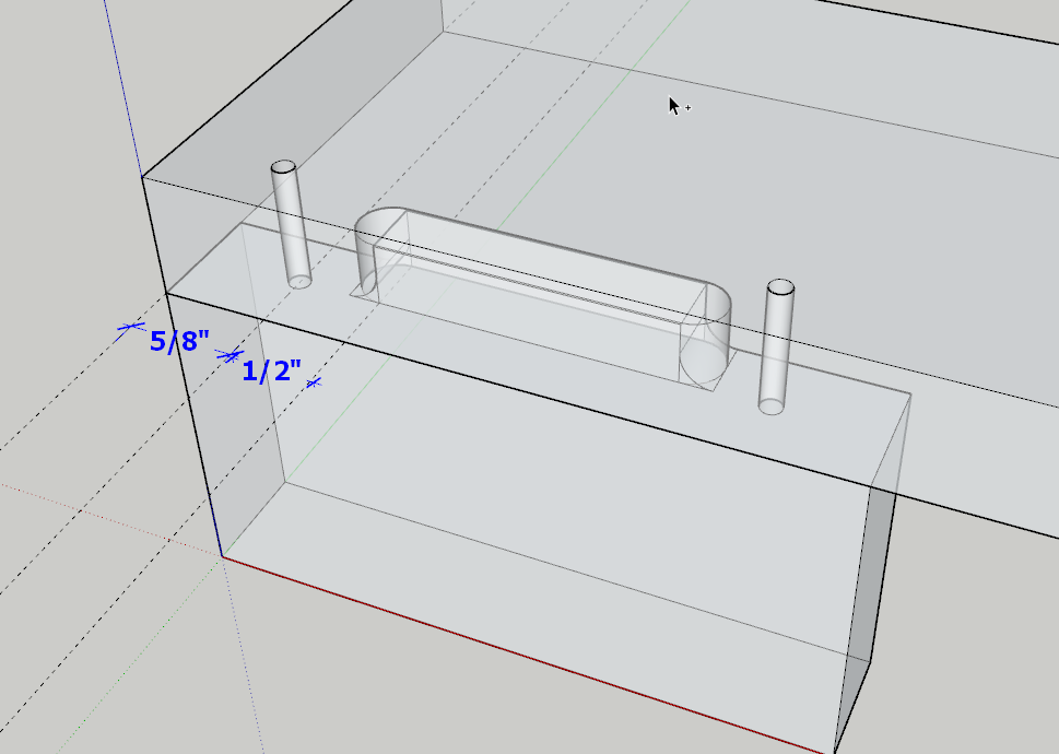

Below is a view of the joint for 4" stretcher to side, same as front edge of a split-top base. One tenon, two screws.
Made the change in wall cabs depth from 12 to 14 after researching trends and experiencing doors that won't close when modern plates and dishes are stored. Doesn't add much cost but makes for a custom feel and experience.
