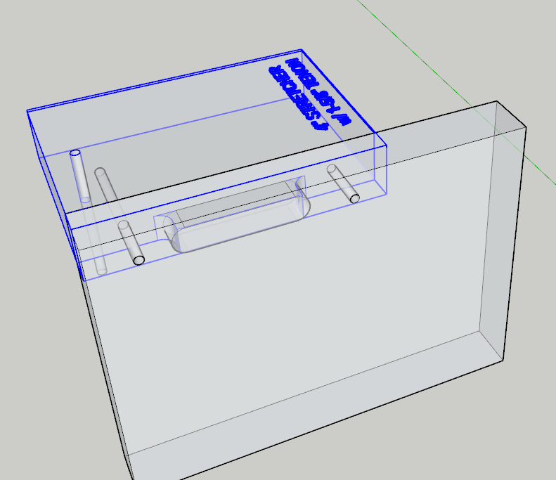

I use eCabinets to order frameless cabinet jobs which we source unbundled. The carcase parts are almost always 3/4 MCP, occasionally plywood, but the joinery is what eCabinets calls lock tenon. A shop that runs the eCabs software cuts and edgebands and labels all the parts and ships them to us flatpacked, stretcher wrapped to pallets.
My system went crash and I lost all my standard cab builds, and just finished recreating all so I can batch up a current job.
The joinery uses tenons indexing into mortises, and the tenons are all "within" edges, and assemby is by #8 x 2 screws. No tenon runs for more than a specified length without a break, and in those breaks go the screws. The CNC cuts through holes at 1/8" diameter as pilots for all the screws.

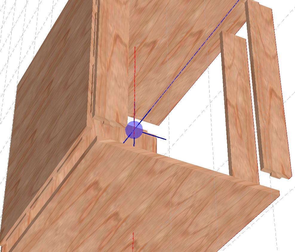

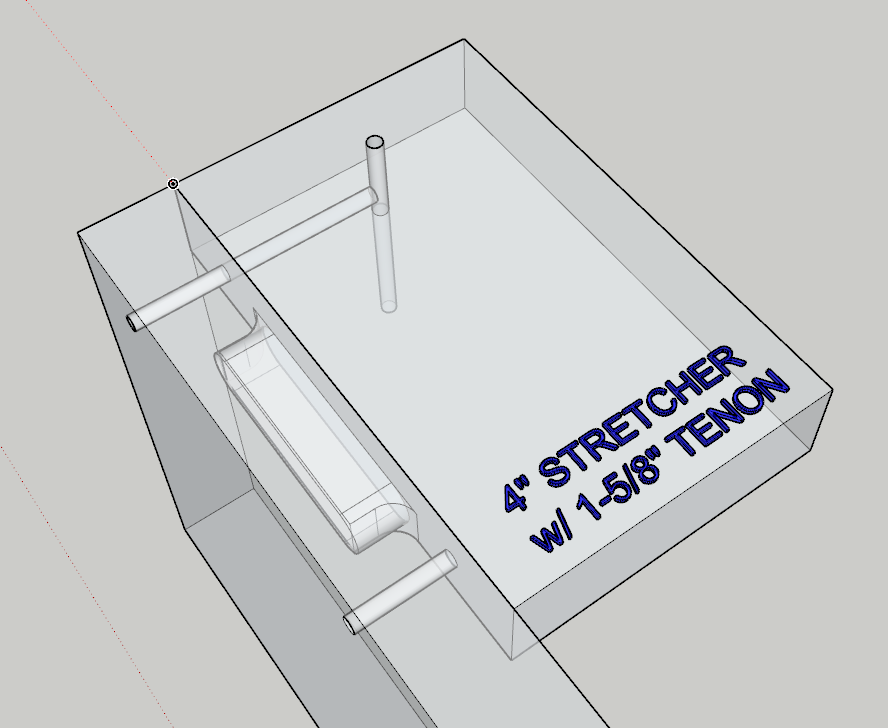

See the pics attached for what I just set up in the software for a joint at a corner, in this case the back where side meets top at back, and this top is for a base, so you are seeing the rear top stretcher. Two screws fix the stretcher as is seen, and we think the screw has a sufficent inset from the edges, 5/8", to go in and tighten without creating splits. The screw you see behind it, going through top into back, is 1/8" beyond the top of the screw fixing the side to the top rear stretcher.
Is 5/8" sufficient?

Leo G
Even with pre-drilling 5/8" is cutting it close. I usually use 7/8" and even that occasionally will split.
