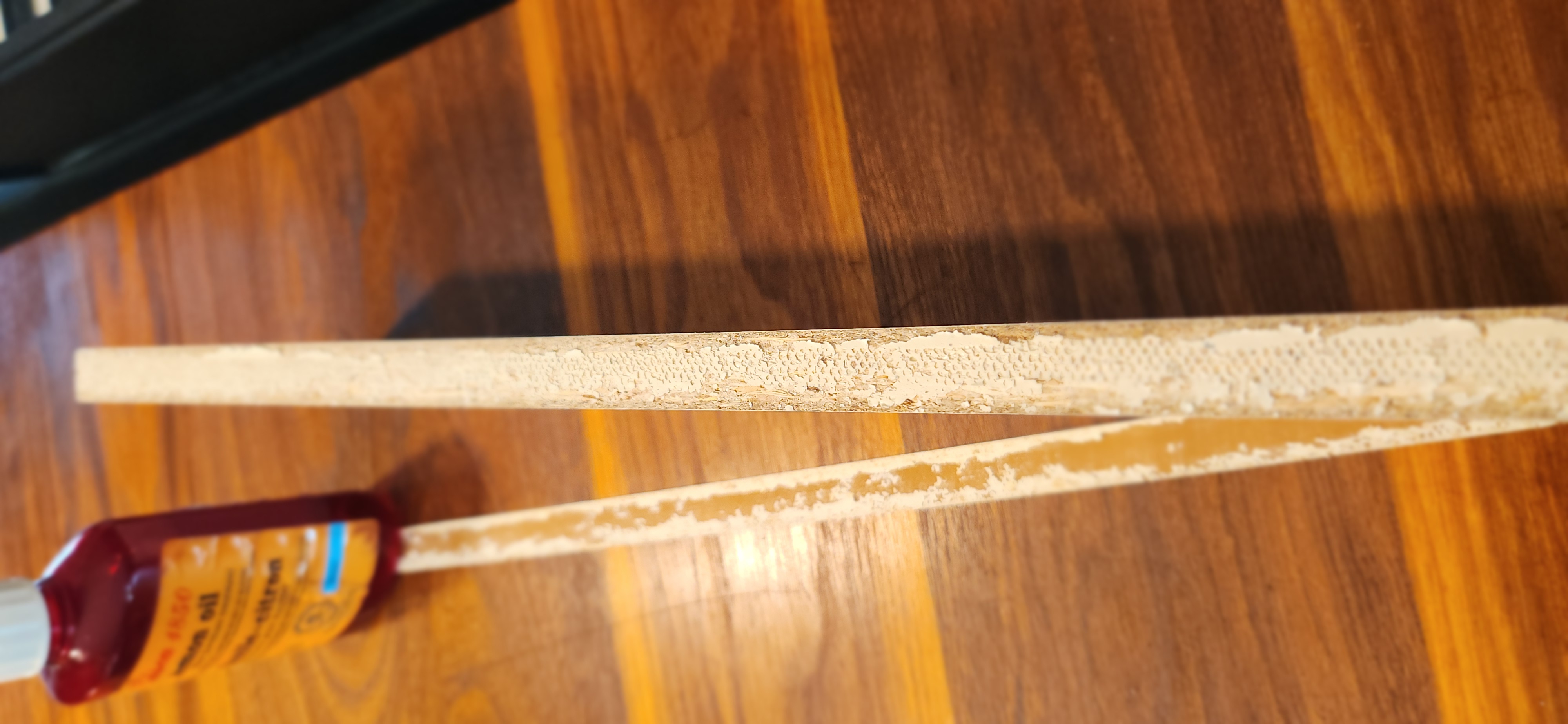

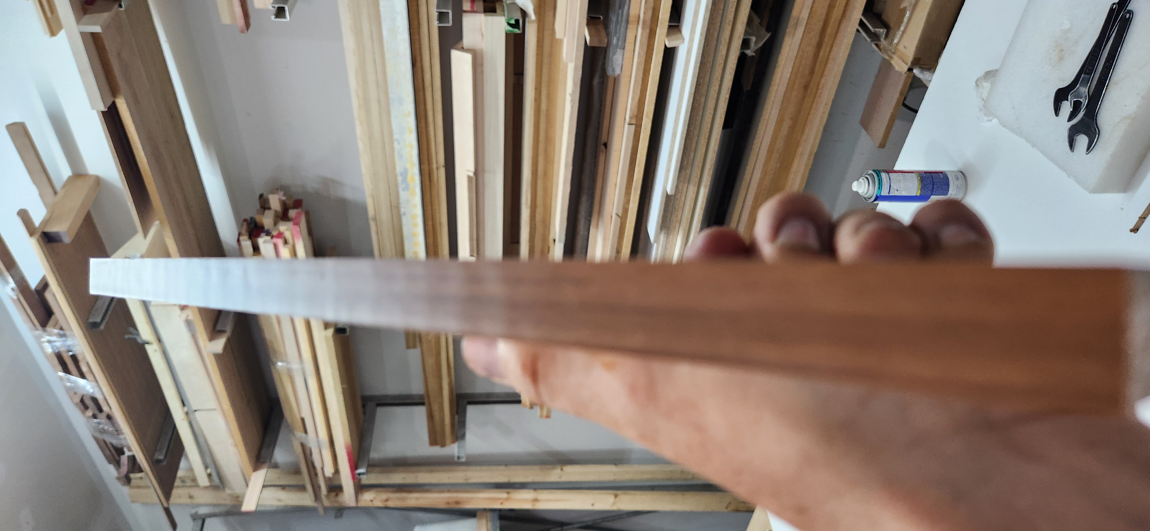

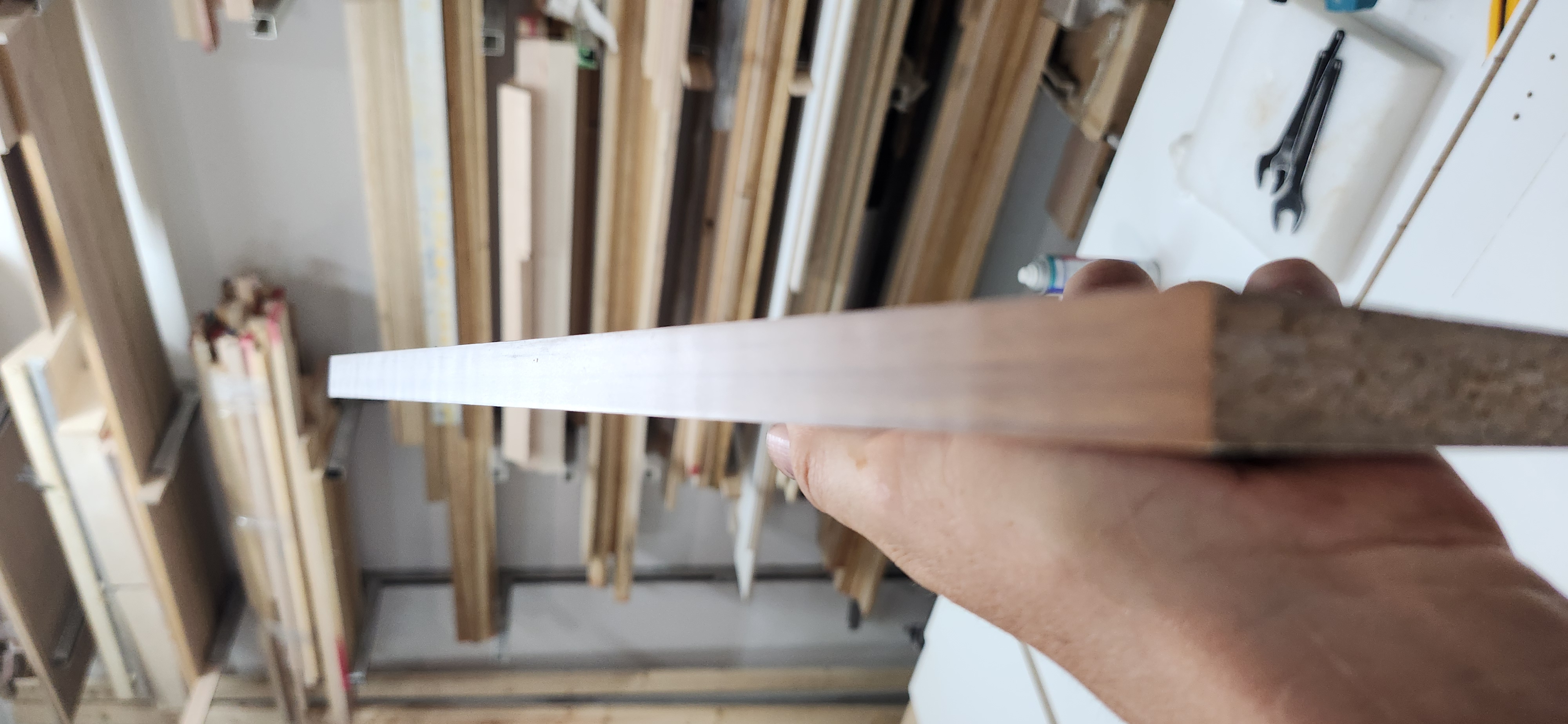

I have loaded .5mm pvc edge tape in my mikro+. The tape seems solid but the face has waves or a wavey texture on it.
View higher quality, full size image (4000 X 1848)

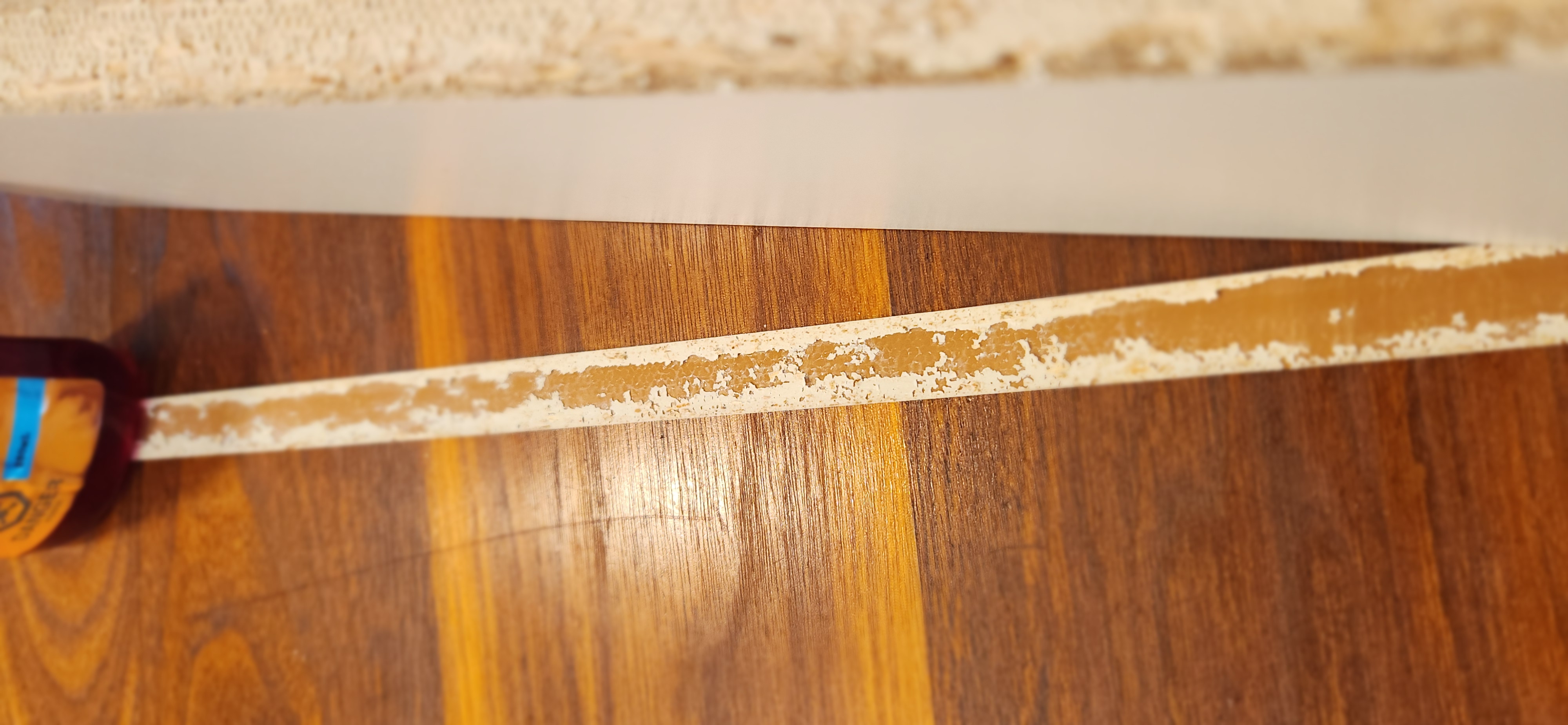

Do you have premill?
What does the glue application look like if you peel the tape?
7/22/26       #4: Edgebanding wave ...
Something Member
No premill on this machine.

Something Member
Im using helithern 480. Spec 180- 220 and 4-16 m/m my machine is 5.5 m/m iI could maybe bump the temp up to thin the glue out but need to find out if that's the issue.

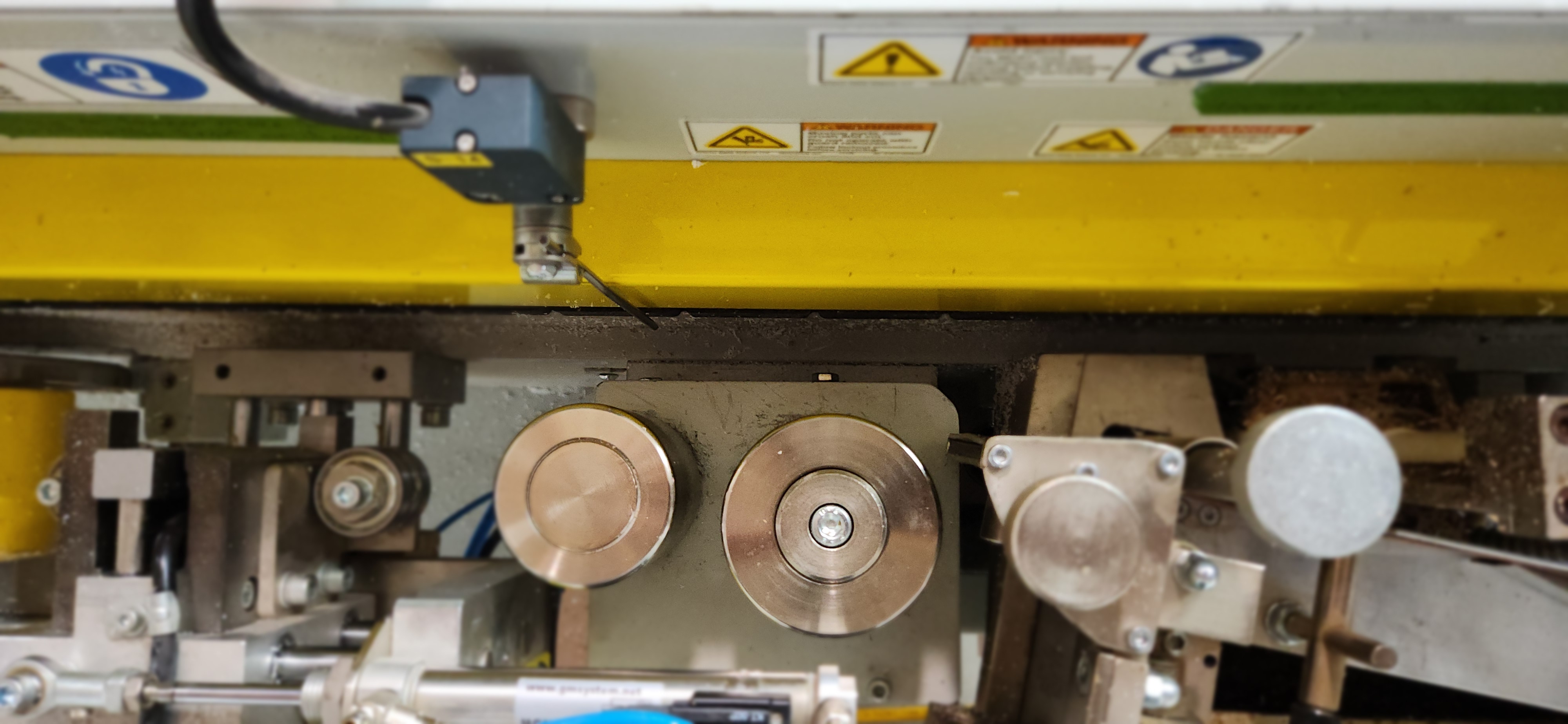

Something Member
Here are the pressure wheels. The drive seems to be set to 0mm clearance without edgetape as in with .5mm edge tape it wound push back .5mm and with 1mm it wound push back 1mm. The second wheel is 1mm proud before edge tape.

Spin the driven pressure wheel and the idler to feel if the bearings are still good.
It looks like this is an SCM K201 or similar. There is a preload handwheel beneath the guilotine for the pressure wheels. Mine has about 5/8" of thread showing.
