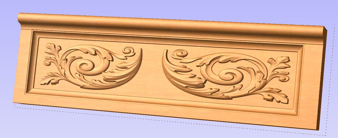

I was just finishing up a file for a Gfrc Mold we are doing for a Hood in a custom,, took a pick before I machined it in the negative to cut in foam for the mold.. I did this in Aspire over the last half hour !
View higher quality, full size image (1374 X 564)
