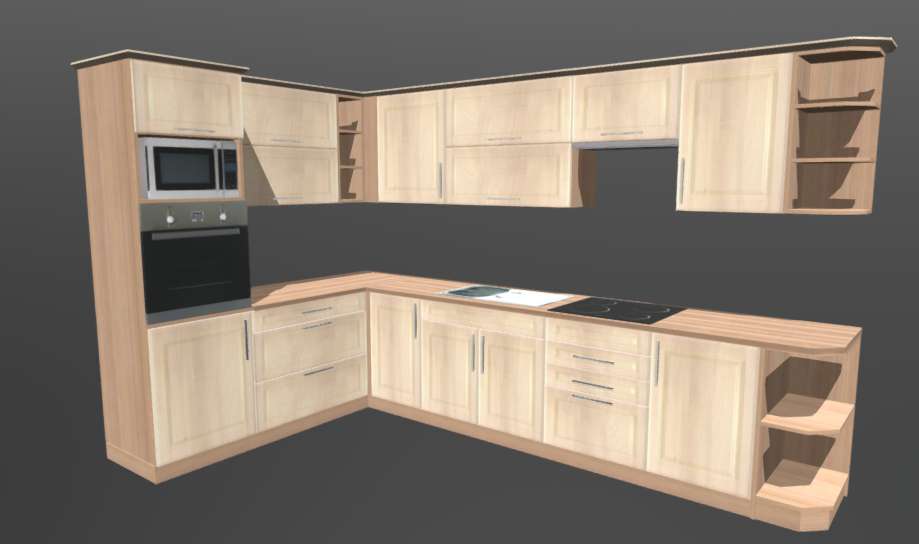

2/7/19       #15: CAD Programs ...
mokuskasw Member
Website: http://cabinetdesign.net84.net
ms_Butor software can export to .obj file can create cutlists and 100% free.
