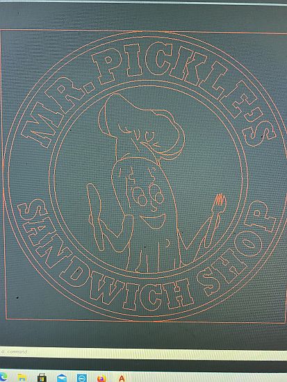

I am trying to rout out something on a weeke that was drawn in autoCad and programmed through woodwop. When it comes up on the weeke it gives an error message that says "reference to undefined contour element" I tried to post a picture, but it says the file is too big . It is doing most of it, but it shows red on some parts. Any help is appreciated.

Mauricio - you can send me your image via email and I will resize it and add it to your post. Send it as an email attachment to webmaster@woodweb.com.

Here is Mauricio's image.

pat s gilbert
Might be junk geometry, double lines or untrimmed lines

Peter Matos
Check the .DXF to see if there are lines on top of lines. You can usually grab the whole drawing and move it over and if there is underlying lines/geometry you an delete it. Then move it back to your zero location. There are other ways to find the issues too...

Gary Balcom
That sounds like there was a line in Woodwop, and it was deleted. There was a route that referenced it and it's now missing, so it doesn't know what to do. If your machine is relatively new, it the offending route would be highlighted in Red.

Brent Wilkerson Member
Can you provide the MPR file and DWG/DXF file? I'd be willing to fix it for you if you didn't get it fixed yet.

mauricio Member
It never got figured out, so i just finished off the lines it didn't do by hand, but thank you anyways
