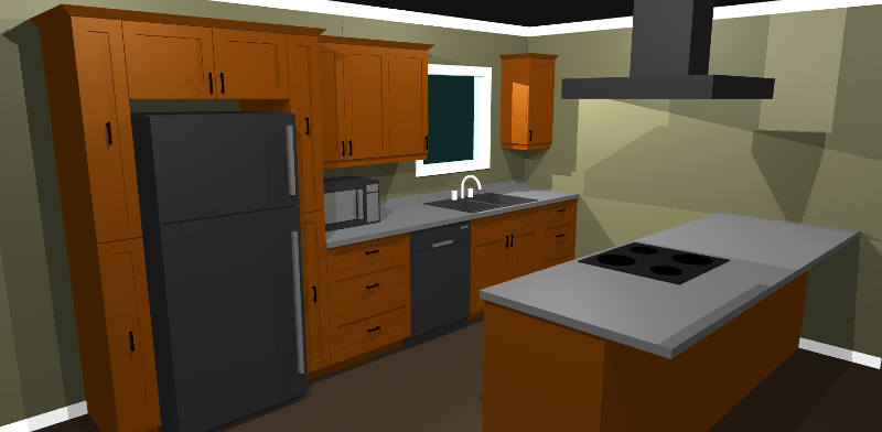

I made this website for my own use but I thought others might find it helpful.
I wanted something that just did renderings and was simple. It was also an excuse to learn web development.
https://cabinet3js.netlify.app/
View higher quality, full size image (800 X 392)

Very nice. This will probably terrify others that you will add cut list and cnc output. As those are child's play if one is driving the 3D graphics parametrically as you already are. You have all the data to do it right there.
About time someone did this.
Thank you. Great work.

I have thought about adding more to it but so far I have fought the urge as I'd like to keep it as simple as possible. One thing I will likely add is a report of all the cabinets and their sizes.

Great job Eric, very easy to use. Would be nice to have an option to add a filler/scribe to either side of the cabinets.

I've added fillers to all cabinets but the upper corner cabinet. Just use the filler of the cabinet next to it.
Let me know what you think :)

Eric, that works great, I did have to replace the cabinets to get the filler option. You may want to add a top & bottom filler to the uppers for a more finished look. Another thought would be a separate item for corner fillers.

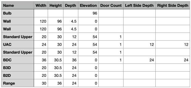

I've added item reports. It builds a .csv file to be opened in a spreed sheet program.
It only lists some of the more important properties like dimensions.
Still thinking about corner fillers. One idea is to have a property in the corner cabinets that would say something like "Act as a filler" or "Filler Box".
View higher quality, full size image (617 X 284)

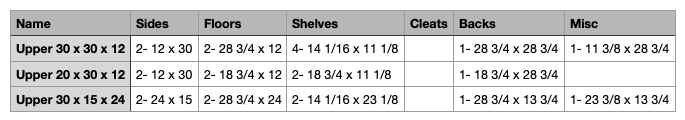

David, I started to add cutlists like you had mentioned.
Right now it's just an experimental feature. And only works with newly added standard uppers. At the moment the only option for the user to adjust is the cabinet material thickness. I think I might add a few more options like a back inset etc. But still trying to keeping it as simple a possible.
View higher quality, full size image (685 X 120)
