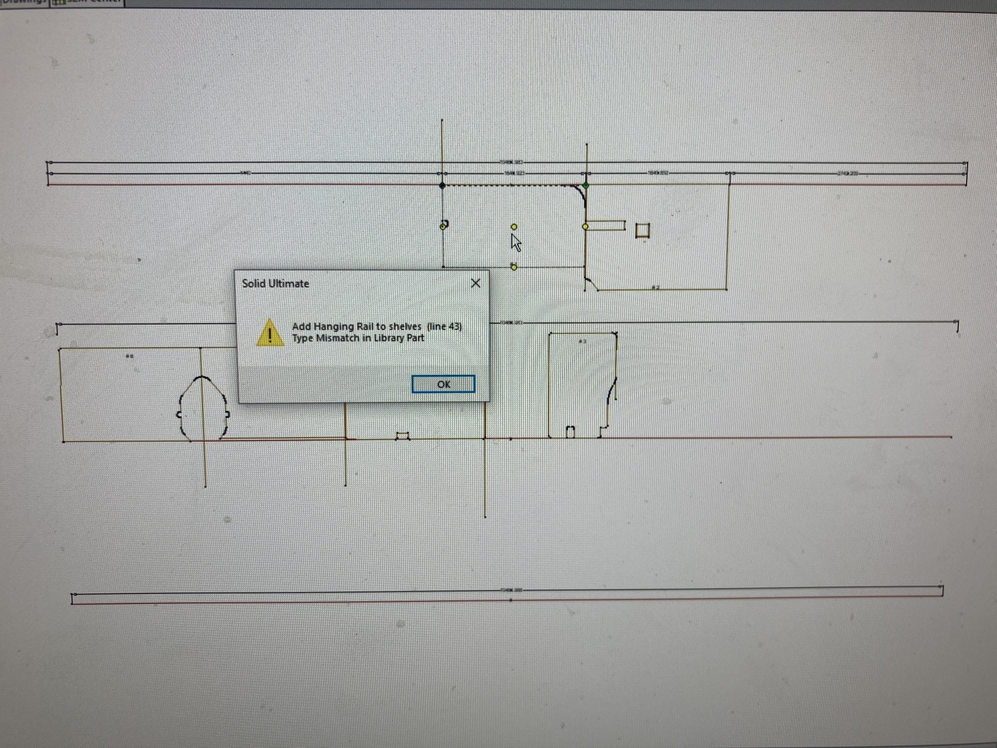

Hi all, could anyone tell me what the below error related to;
Add hanging rail to shelves (line43) type mismatch in library part.

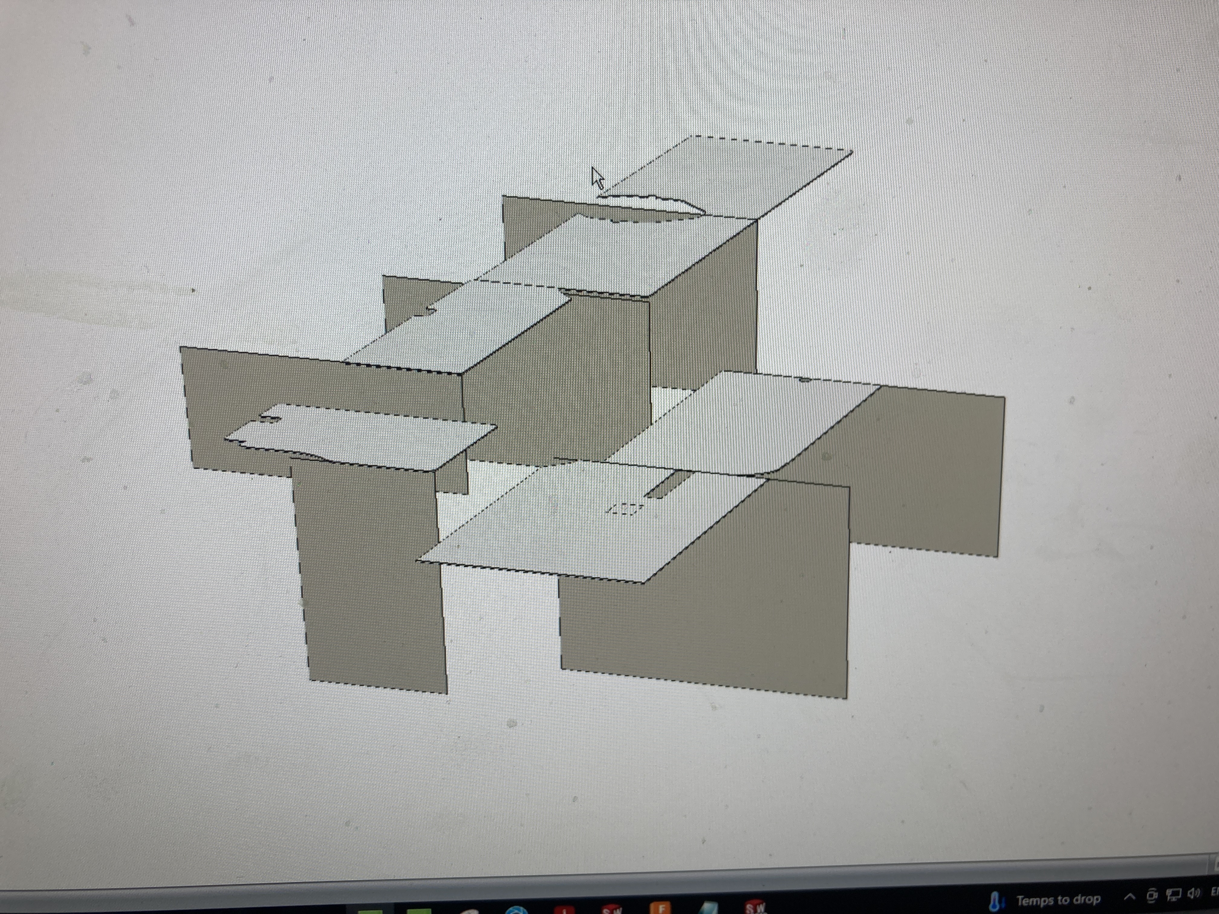

This has started coming up on all the parts I have created and when the part opens it adds a ghost part within the intended part. (See pics, the beige parts are ghost parts) But these ghost parts don’t appear on the nest in s2m
Does anybody have any idea what is going on or how to fix it?

Dylan B
Your UCS called "Add hanging rail to shelves" is trying to set the library part of something it is adding and the type of the library part does not align with the type of what the UCS is adding.
If you no longer use that UCS you can disable it by going to the "User Created Standards" in the utilities tab and click it then toggle the lightbulb icon on the top menu bar.
If you do still need it then you will need to fix the library part so that the types align, hard to say what you would do here without seeing the UCS and library part in question.
