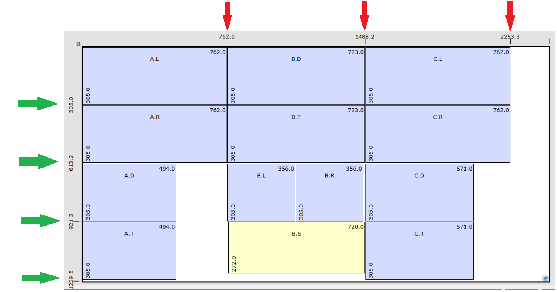

Our typical cut layout looks like the one in the picture attached.
This 3/4" melamine sheet contains parts for three wall cabinets: A, B and C.
Parts are left side (L), right side (R), deck (D) and top (T).
Backs are cut from 1/2" melamine, usually before anything else, while the edgebander machine is heating and other stations are prepared for work.
Once the sheet is squared, first I would divide sheets into three cross-cut parts: 762.0 mm wide, 723.0 wide and 762.0 wide. Those are the red arrows on the diagram.
There is a helping table at the front right of the sliding saw, so these parts just slide of the sliding saw to that table, no need to carry them away, and will be at arm's reach once it's time to cut them further.
These 'red' cuts would typically end up as a banana cuts and would be a problem in a regular situation, but not so much with our process, as explained bellow.
Next, I would cut each of these three parts into 305.0 mm stripes.
Those are green arrows on the diagram.
I'm not using cross-cut fence for alignment nor flip-stops for measuring 305.0 mm. I have made a jig instead that is mounted on a sliding bed and parallel with the blade (like a rip fence) and fixed at 305.0 mm so I don't have to adjust flip-stop on a cross-cut fence for these cuts. (There are also identical jigs for every typical dimensions: 610 mm for base cabinet depts, 775 mm for base cabinet heights, 305 mm for wall cabinet depths, 272 mm for wall shelves, 577 mm for base cabinet shelves, same set for 21" deep vanity cabinets).
So, all these eleven 305 mm wide stripes would be cut one after another without any changes on the sliding saw. This, obviously, goes very quickly.
Now, if I was not using that jig that is parallel with the blade, but instead referencing these cuts from the cross-cut fence, than those red banana cuts would cause problems, but since I'm using that jig I'm actually referencing from the straight edge and banana cuts end up having negligible effect on the final result. That way I don't have to use stable manufactured boards or cut twice to get rid of banana cuts.
Next, I would cut A.D and A.L from one of those 762 x 305 stripes.
Then B.L and B.R from one of those 723 x 305 stripes and finally C.D and C.L from two 762 x 305 stripes. These parts are cut regularly the way sliding saw cross-cut fence and flip-stop are meant to be used.
Occasionally, I'll toss in some shelves (like B.S on the diagram) or some other parts (like stretchers or such) to fill in unused space on the sheet. Our goal is to have critical case parts (those that are necessary to assemble the cabinet case) first, so that we can have cases assembled as soon as possible, and leave everything else (like shelves) for later.
We get a little more waste this way, but gain in time and efficiency outweighs that loss considerably.
This cut diagram has been made in CutList Plus. One way I can simulate sequencing is that I do not import all the parts at once, but let's say just first three cabinets. I then quickly manually arrange those parts to look like something on this diagram I used as an example. Once I'm happy with the layout, I can freeze/lock those layouts and then load another batch of parts. Those will be arranged on additional sheets without disturbing previous ones (since I locked them), and so on.
It's not a big deal, but we have recently solved some bigger bottlenecks and are now attacking these smaller nuances. We're running out of space in our current shop, and I feel like nothing big can be done until we move into a bigger space.
