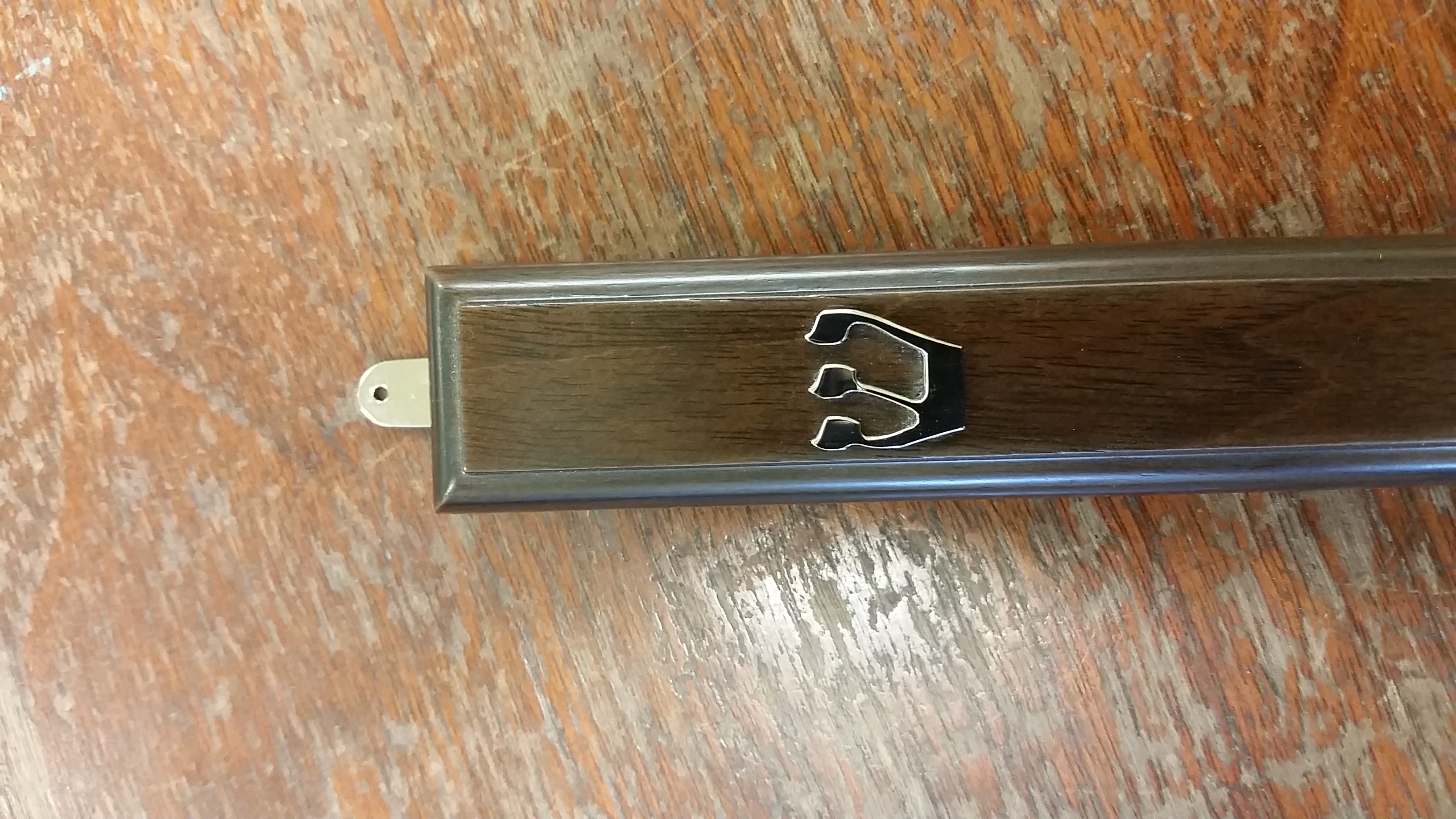

I have a job that involves routing out a decent quantity of small (Approx. 5/8" Square) Hebrew letters & tabs from a 6"x 25" brass plate. The brass is 0.05" thick and has been glued to a piece of solid wood which in turn is screwed down to my spoil board.
We are using a 2 flute 1/16" diameter end mill in 3 passes. Cutting at 6 IPM with an RPM of 15000. I had tried to run it faster last time we ran the job but was snapping bits.
These settings are what we found worked last time but this time the operator is snapping tools like crazy, 15 already! Mostly seems to be on the letters not the tabs.
What am I missing? I will attach pictures.
Thanks in advance for any insights.
Richard
