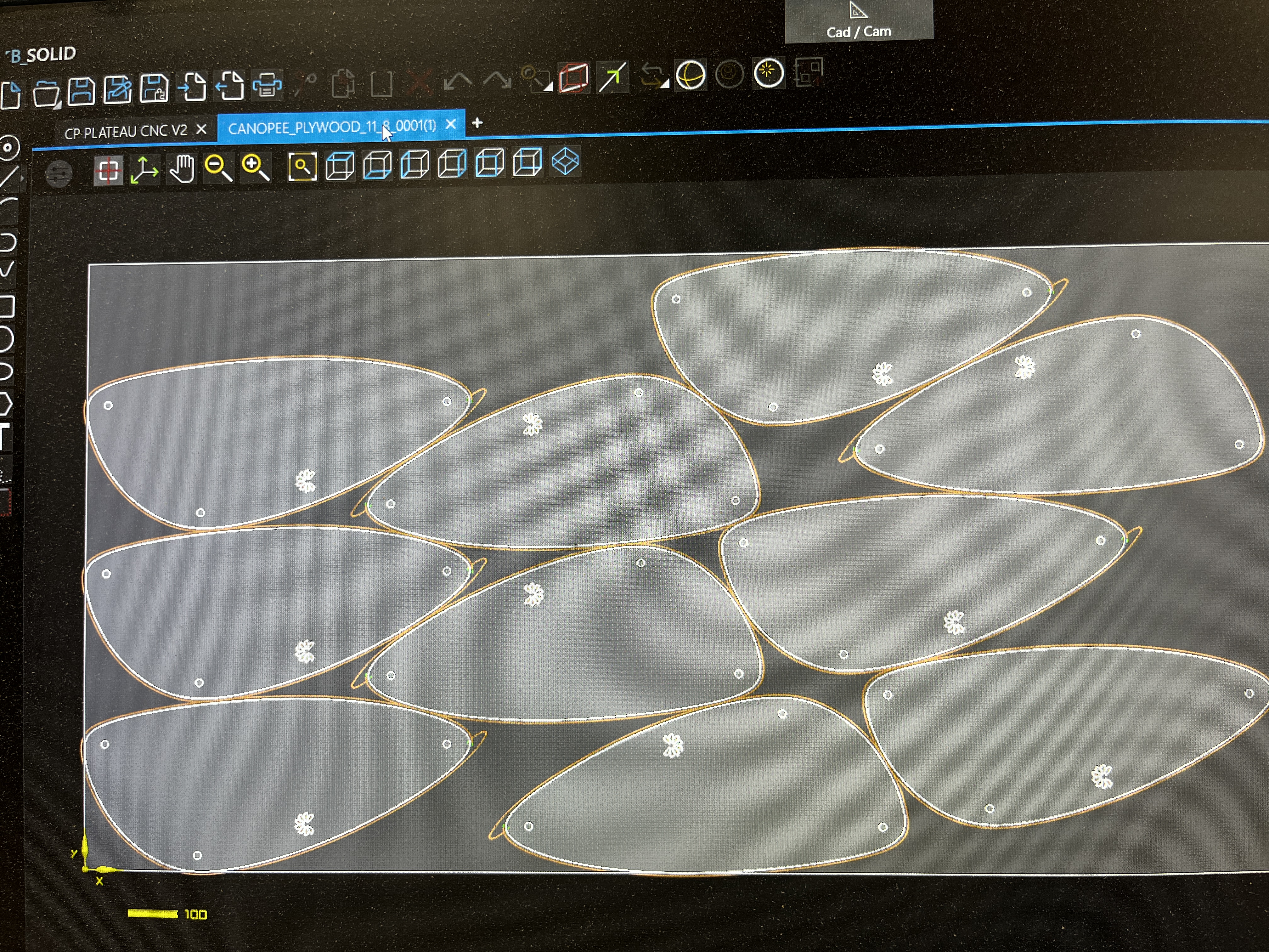

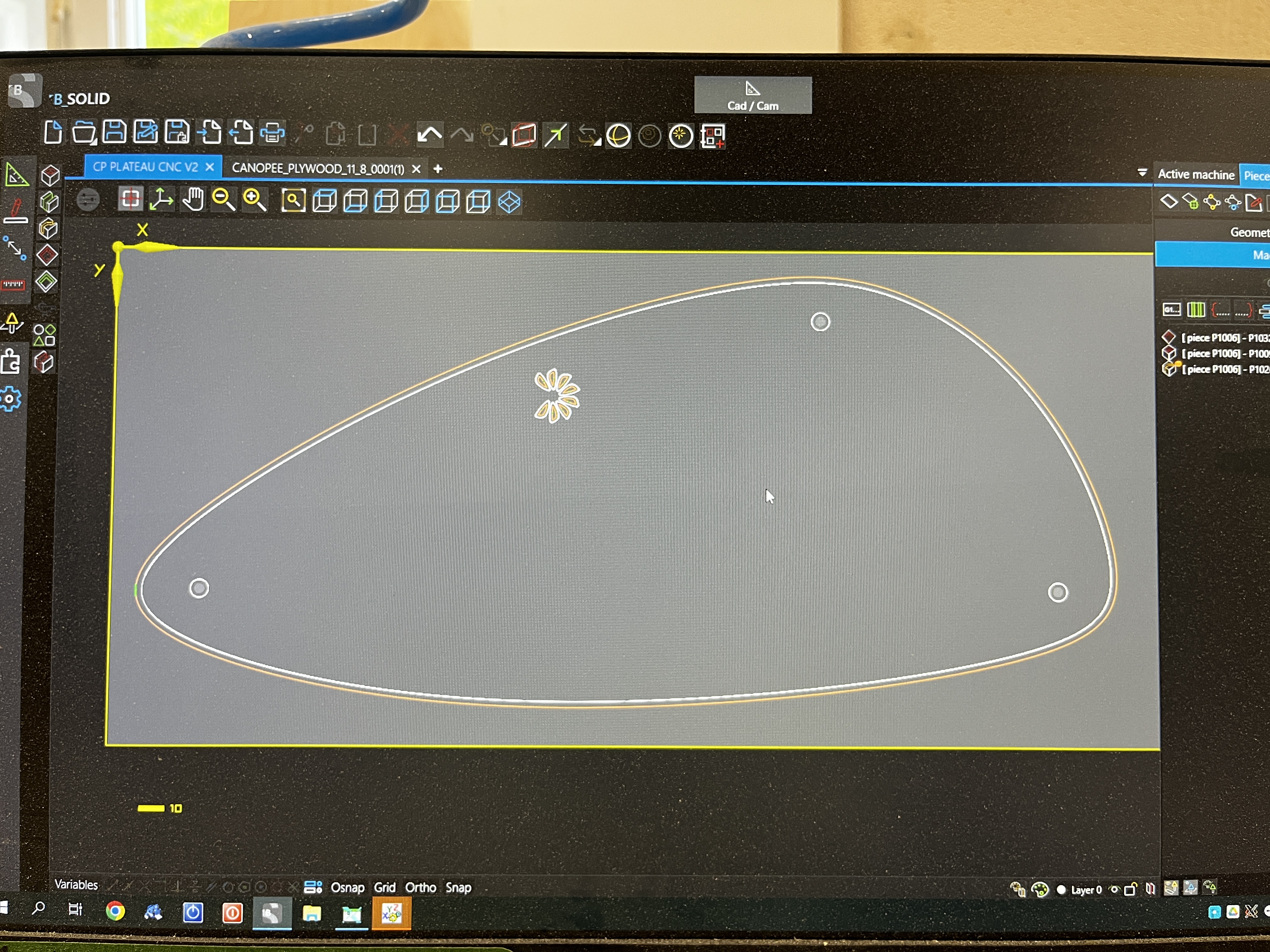

Mathieu
Hi! I ran into I issue with Bsolid and Bnest. I create my .DXF with fusion. export it in Bsolid, apply the machining operations, save as an article. Went into Bnest to cut as much article as possible on a 4x8 sheet, process it, Bnest lay down 10articles wichi is nice. But when I open in CAD, It create a swing shape for I don’t know why reason….I thought after reader you’re answer that it was my working piece so I scale it bigger but it didn’t fix the problème, did you guys would know what’s the issue here ?!? I’m lost. &#128542;
