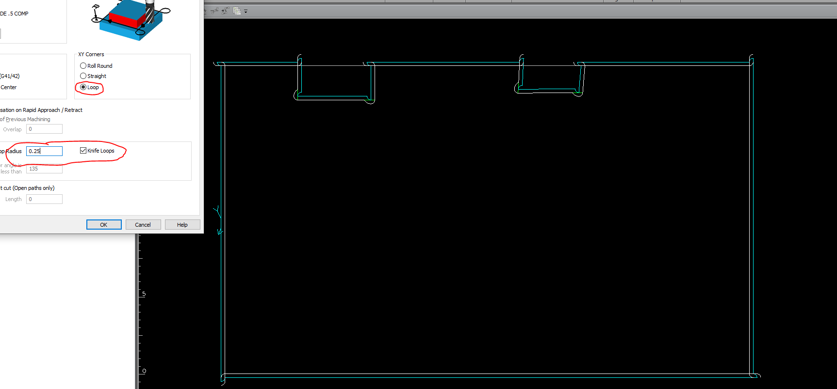

1/4/21       #3: Alphacam overcut corners ...
Kbold
I haven't used it but look at knife loops, it might do what you want.
See attached.
View higher quality, full size image (1297 X 778)

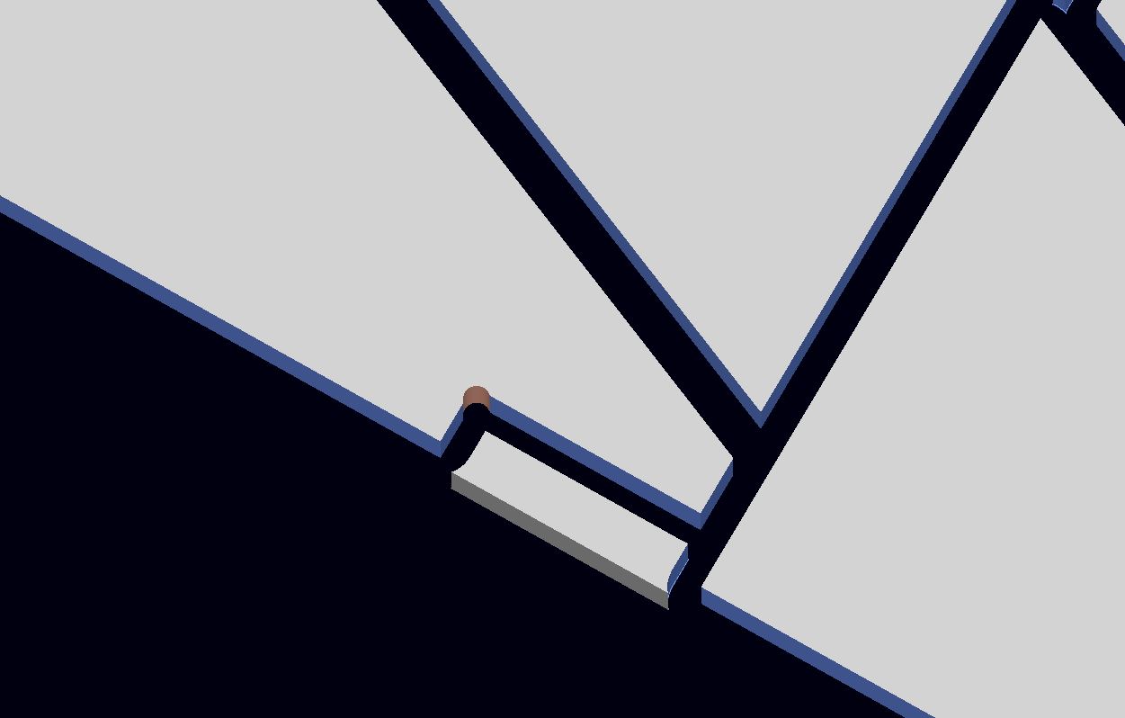

1/5/21       #4: Alphacam overcut corners ...
Kris Member
I've tried knife loops, but from what i've tried it only works for ouside corners. would work for pockets we have to cut inside of a shape, but not the outer profile
We've been doing this with sheetcam, but have recently made the switch to alphacam.
we need it for inside corners so that when we have a joint between two pieces, we don't have to clean out the rounded inside corners manually
i've attached a picture of what the geometry looks like once we have cut it, and what i have to manually do now.
the left is the overcut corners, the right is what we would like to be able to draw and apply overcutting tool path to.
View higher quality, full size image (1504 X 813)

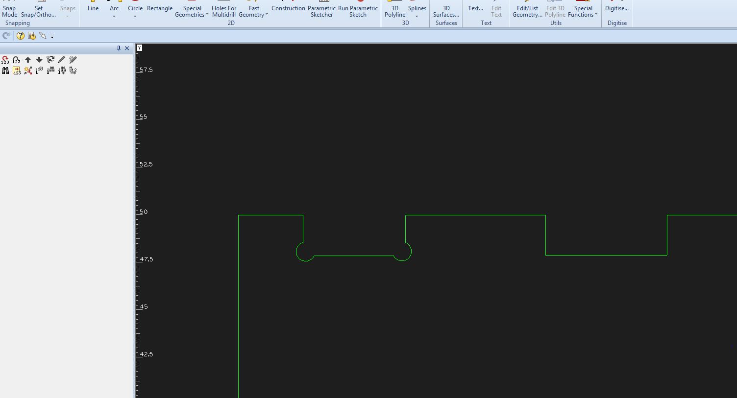

1/5/21       #5: Alphacam overcut corners ...
MIKE C
have u tried edit - fillet - reverse bubble
1/5/21       #6: Alphacam overcut corners ...
Kris Member
Just tried the bubble fillet, and it works quite well.
Thanks Mike!
We will definitely use that if we have to redraw the geometries.

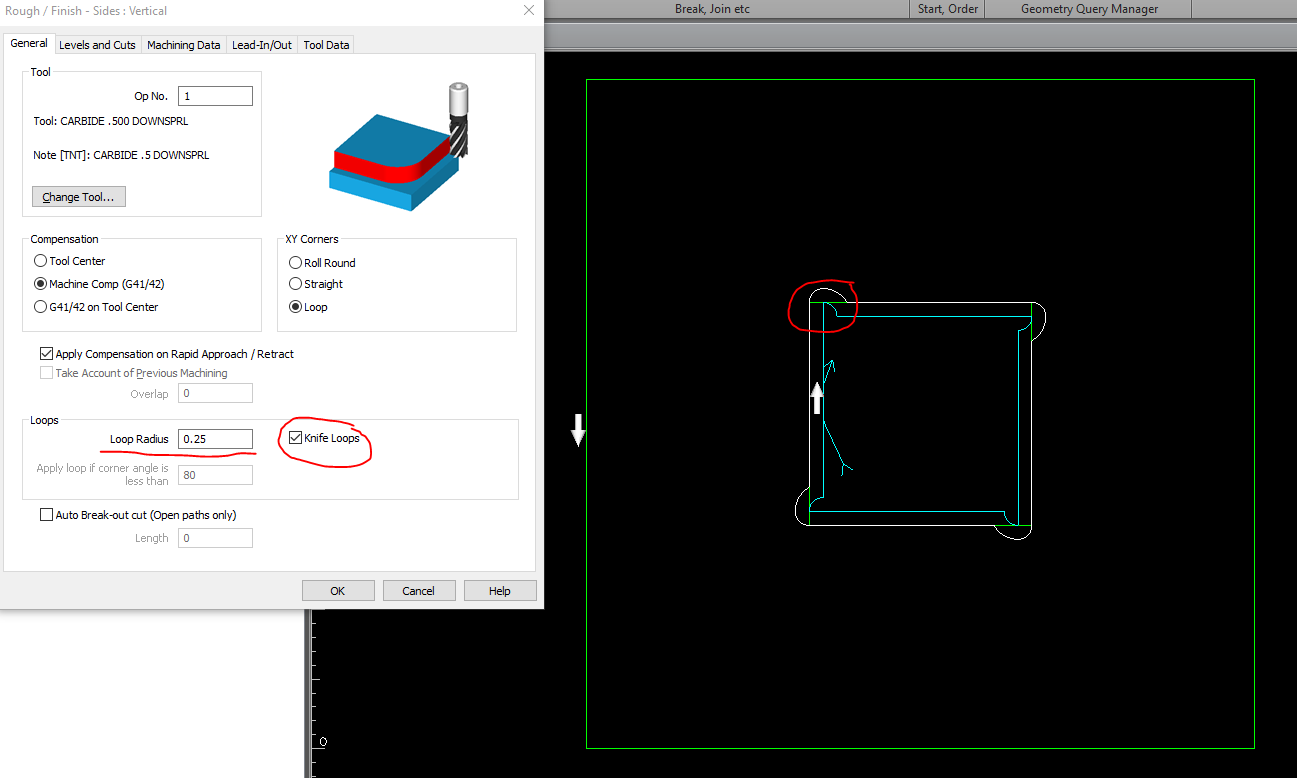

1/5/21       #7: Alphacam overcut corners ...
Kbold
I tested Knife loops on a outer profile and it seams to work for me. I don't like the path it creates but should do what your asking.
I prefer the bubble fillet but it does alter the geometry and you said that's not what you want? It will update the tool path a geometry at the same time.
Good luck
View higher quality, full size image (1154 X 709)
View higher quality, full size image (1725 X 803)

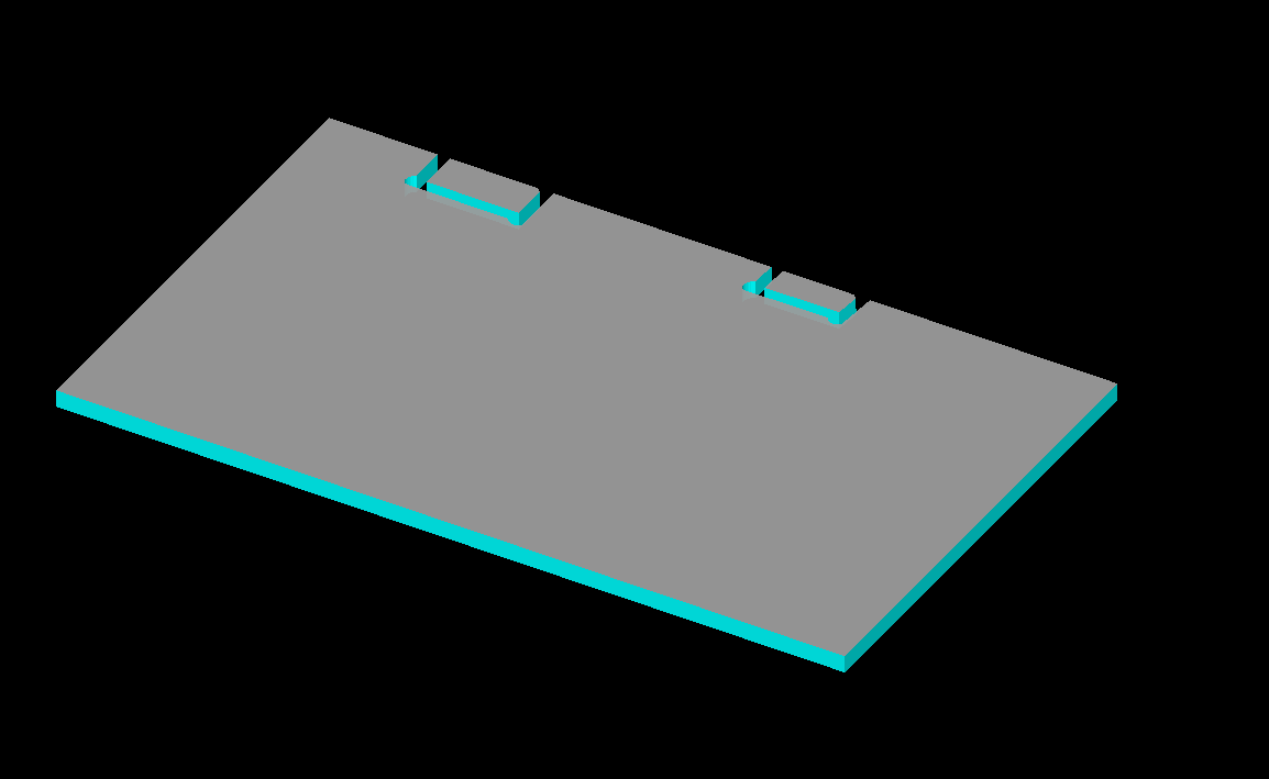

1/5/21       #8: Alphacam overcut corners ...
This is what I think he is looking for

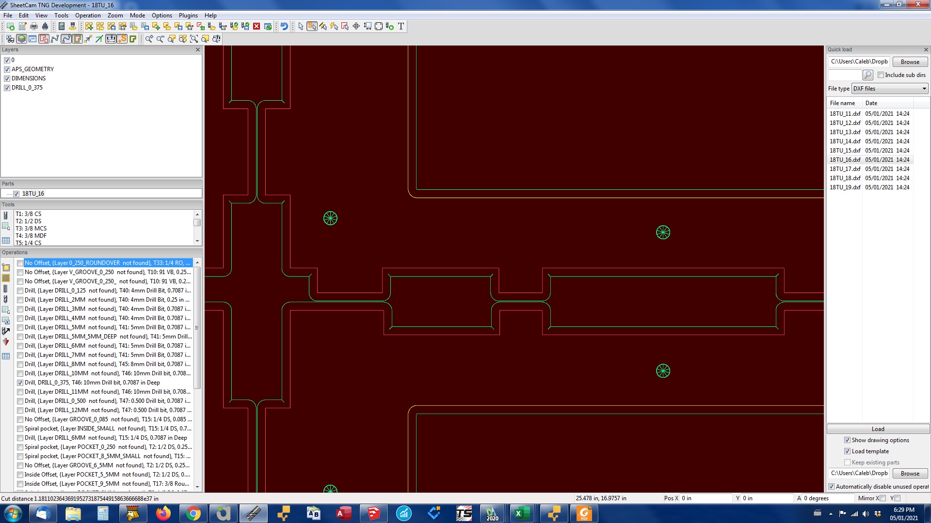

1/7/21       #9: Alphacam overcut corners ...
MIke
I just use corner drill. I drill inside corners first with an Alphacam add-in called Corner Clean, then route the part. The inside radius is eliminated. The add-in can take care of dozens of inside corners in about a second. Once I discovered this, I use it all the time for plywood studs and horizontal framing parts.
View higher quality, full size image (1251 X 798)
1/7/21       #10: Alphacam overcut corners ...
Kris Member
That sounds like exactly what I'm looking for
Thanks a lot Mike
