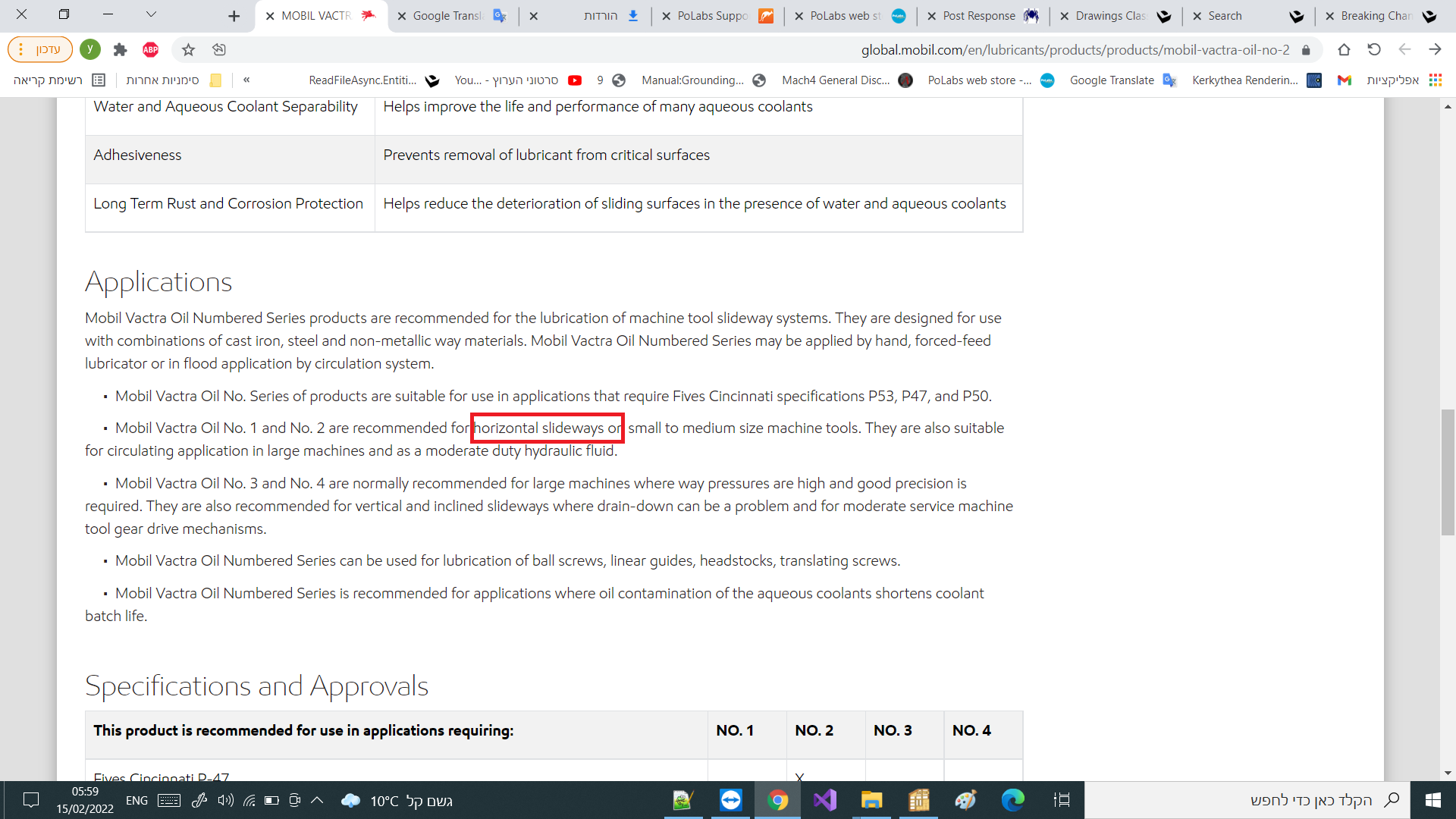

yaakov,
You doubt my experience? I ran a 5'x10'x3' Z, 5 axis Motionmaster with a Fagor controller for 12 years using oil and manual pump on the linear ball bearing guides. It was the recommendation of that western manufacturer when we purchased the machine new. You have personal knowledge of every single western made cnc maintenance recommendations?

2/14/22       #14: Software upgrade for generic Chines ...
yaakov
i was real interesting so i also look at mobile Vectra no 2 manual
it said there Only for horizontal guide(even the long axiss in cnc are not horizontal because they on there side )
so its real strange how the manufacture recommend you oil that not fit yours machine
