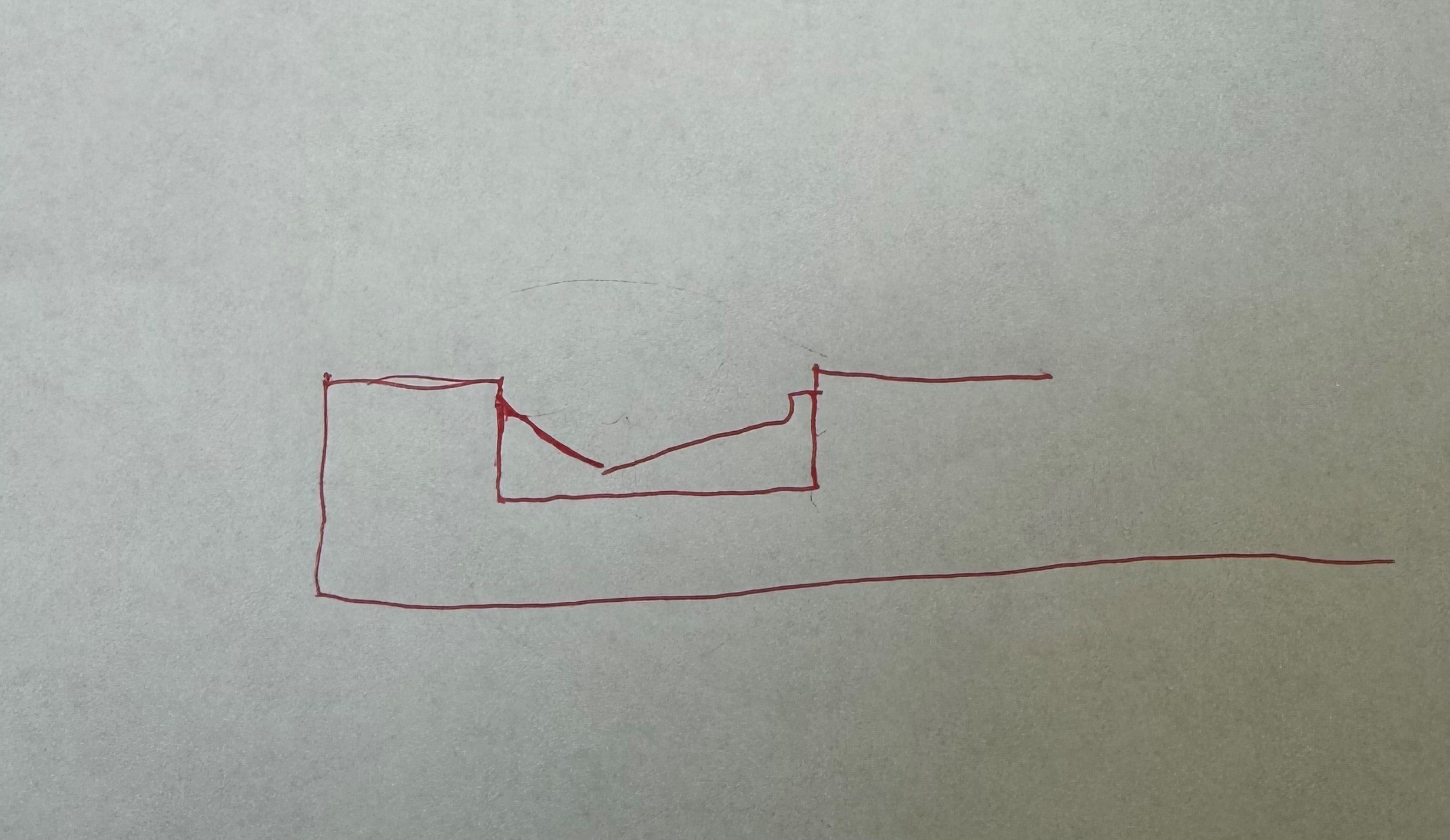

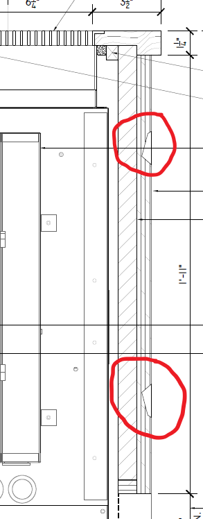

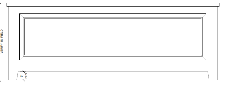

We got a job where will be making over 250 removable raised panels. This is a perfect job for the CNC. The profile is quite unique so I decided to ask you guys how can this be accomplished with a CNC machine.
I am attaching the drawings of the profile.

It's a tough profile to do.
I think you'll have to design it in 3D and then go from there. I don't see a good combination of tools that will work easily unless you have a 5 axis machine.
I'm looking forward to other's ideas.

I'd do a couple of them with vcarve and a ball nose. That's crazy slow though.
250 of them, I'd entertain running the profile on a tilting shaper on sticks, then wrapping a core and veneering.
Or have a moulding shop run the material for me.
The corners are what will screw you. If I'm understanding the profile, that can't be run on a solid piece in a normal spindle scenario. You run one edge, the tangent edge will cut through through the other edge.
That's a seriously dumb profile and somebody needs a buttchewing for flexing their ego and lack of building knowledge.

Depending on the answers to these questions you maybe able to make these as a 2 piece door, basically an MDF frame with an MDF centre panel.
The centre panels could easily be nested and cut using any CAD/CAM software.
For the frame your software would need to be capable of squaring up the corners of the profile with a ballnose tool. This would still take a little time but would be significantly faster than using a a ballnose for the entire profile. I know Enroute and Alphacam support this function and I'm sure that there are other products that do also.
This method would require you to glue in the insert panel but it can be done pretty quickly. Probably your CNC operator can glue the panels in whilst the CNC is cutting.
2/15/24       #5: How can I make this raised panel pr ...
BH Davis  Member
I'm not saying this is the best solution but you could make an outer frame and an inner panel. The split between the two would occur at the bottom of the V-cut.
The outer portion can be run as straight moulding stock mitered to make the rectangles or butt joints with miters at the profile like on beaded face frames. The inner panel would be run like any raised panel on the shaper or CNC. The outer frame would be assembled around the center panel.
I suggest this because in the cross section it looks like there is a backer panel to support the assembly.
As others have mentioned the only way I know of to do this out of a single sheet on the CNC is with 3D raised panel door software. I use Enroute and while I haven't ever used this feature I know it is there in the Pro version. This would be a time consuming, tedious process with so many panels involved.

We use Mozaik for our CNC. they have a door template you can program all sorts of one piece mdf door profiles in. We do raised panel, shaker and many others on a 3 axis flat CNC. We even have glass profiles in our library of doors. Check it out.

Since this is such a hard thing to accomplish with a CNC we decided to use the machine for just doing a mortise with the width of the profile and 1/16" to 1/8" deeper than it to create a break (making the finish room life easier) and routing out the shape of each panel, and then use our Molding guy to sent us poplar with that profile and we'll just insert it in the mortise with the mitered corners. The only thing done manually at the panels is squaring out the corners of the mortise.

I was thinking along the same lines but your initial drawing didn't show enough material behind the profile to rout out the mortise and still have solid support across the width of the panel. But that's definitely the way to go.
