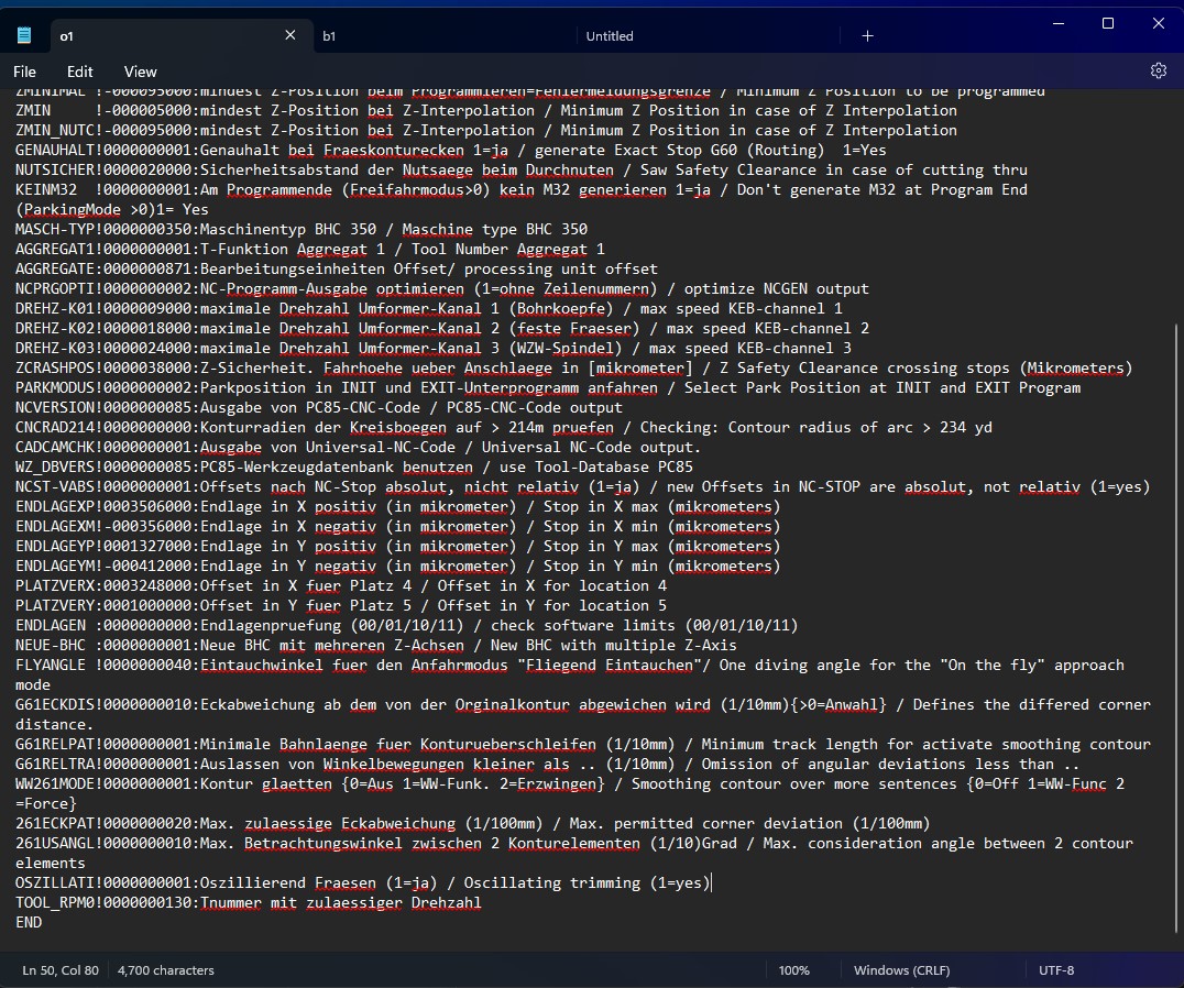

Chris Member
you need to enter a line into the O1 file, located in the cnc folder:
TOOL_RPM0!0000000904:Tnummer mit zulaessiger Drehzahl
obviously you need to exchange the tool number for your own.
then in tool management, set the tool speed to 0 (values T2, T2.1, T3 & T4) and direction of rotation (T5) to "none".
In your woodwop file: make sure the tool speed is defined as absolute and at 0
Also, yes you can enter G and M codes into woodwop, using the NC-subroutine macro. Or rewrite the templates which woodwop uses if you are confident!

I found the folder and added the line:
TOOL_RPM0!0000000904:T130 mit zulaessiger Drehzahl
I think i've understood you correctly? my tool number being 130.
Thanks Again
1/10/25       #9: Drag Knife Setup on Homag CNC with ...
Chris Member
everything after the " : " is just a description (helpfully in german of course!)
it should be :
TOOL_RPM0!0000000130:
of course I should have also said. important to make a backup of the original file before making any changes. And maybe even a 1:1 machine backup.

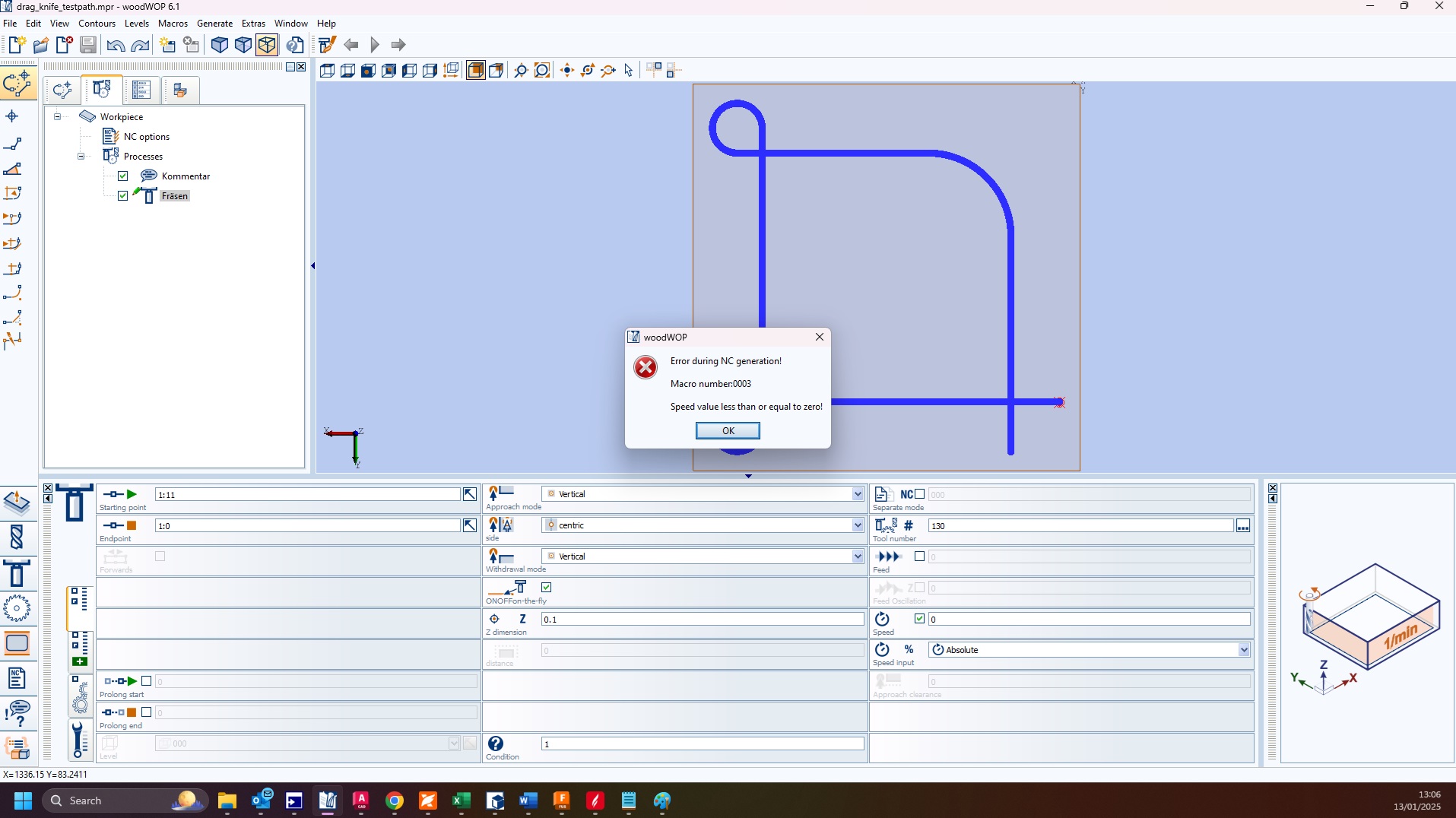

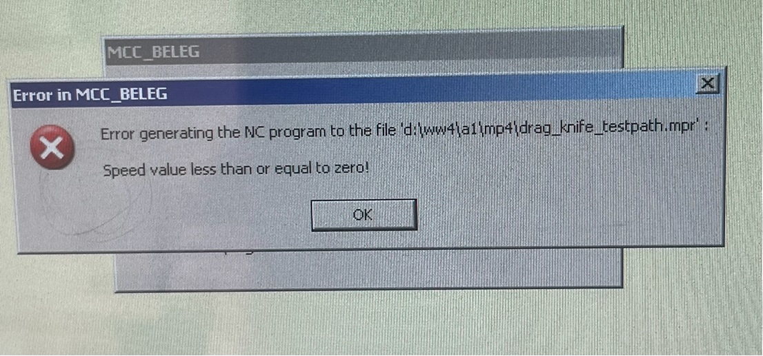

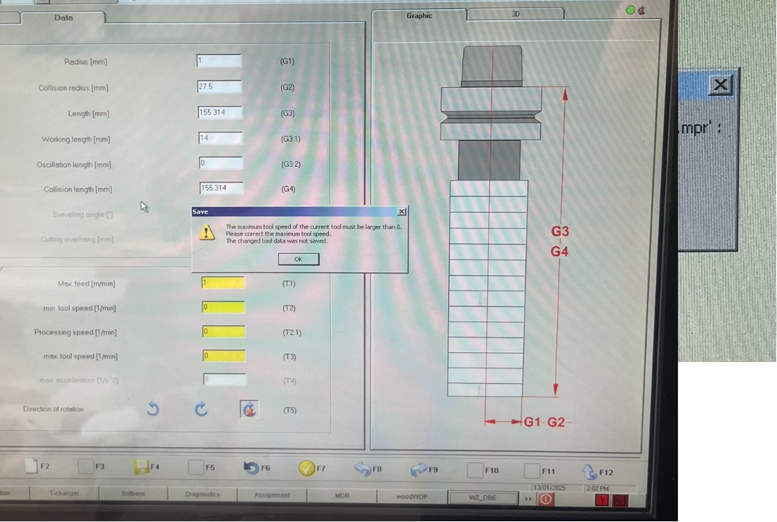

Tom
Unfortunately still no luck, what type of Process did you use?
I'm using a vertical trimmer could that be the issue?
does Vcarve generate a different type of process?
Also the tool is set as a vertical trimmer in the WZ_DB Tool Type 01 Vertical Trimmer on the machine.
attached some images with the errors

1/13/25       #15: Drag Knife Setup on Homag CNC with ...
Chris Member
Hi Tom,
that looks exactly the same as I have set up. Sorry can't say why it doesn't work for you.
Maybe worth trying a different tool type in the tool manager (aggregate?)
Do you have a screenshot of the O1 file also?
