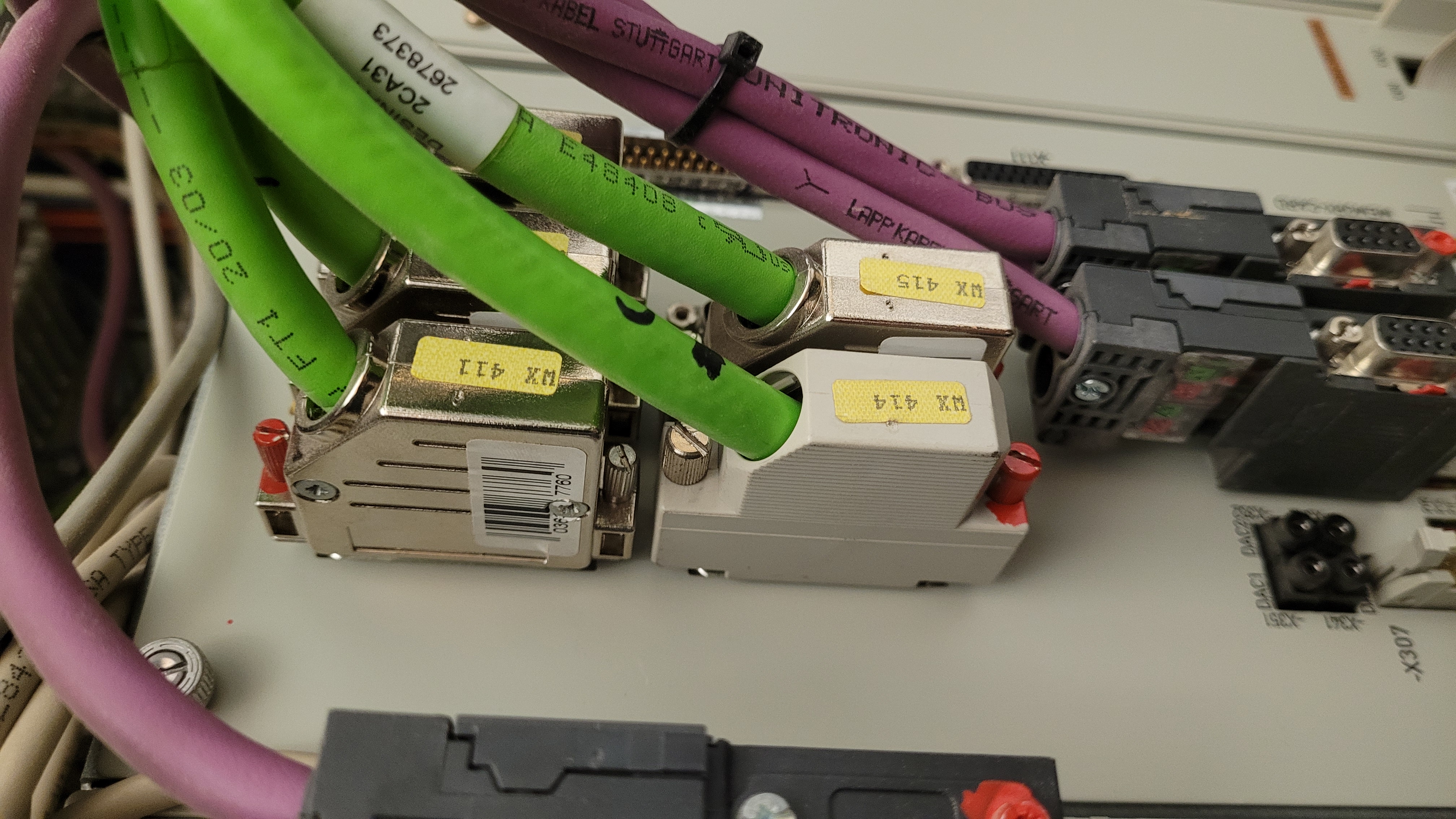

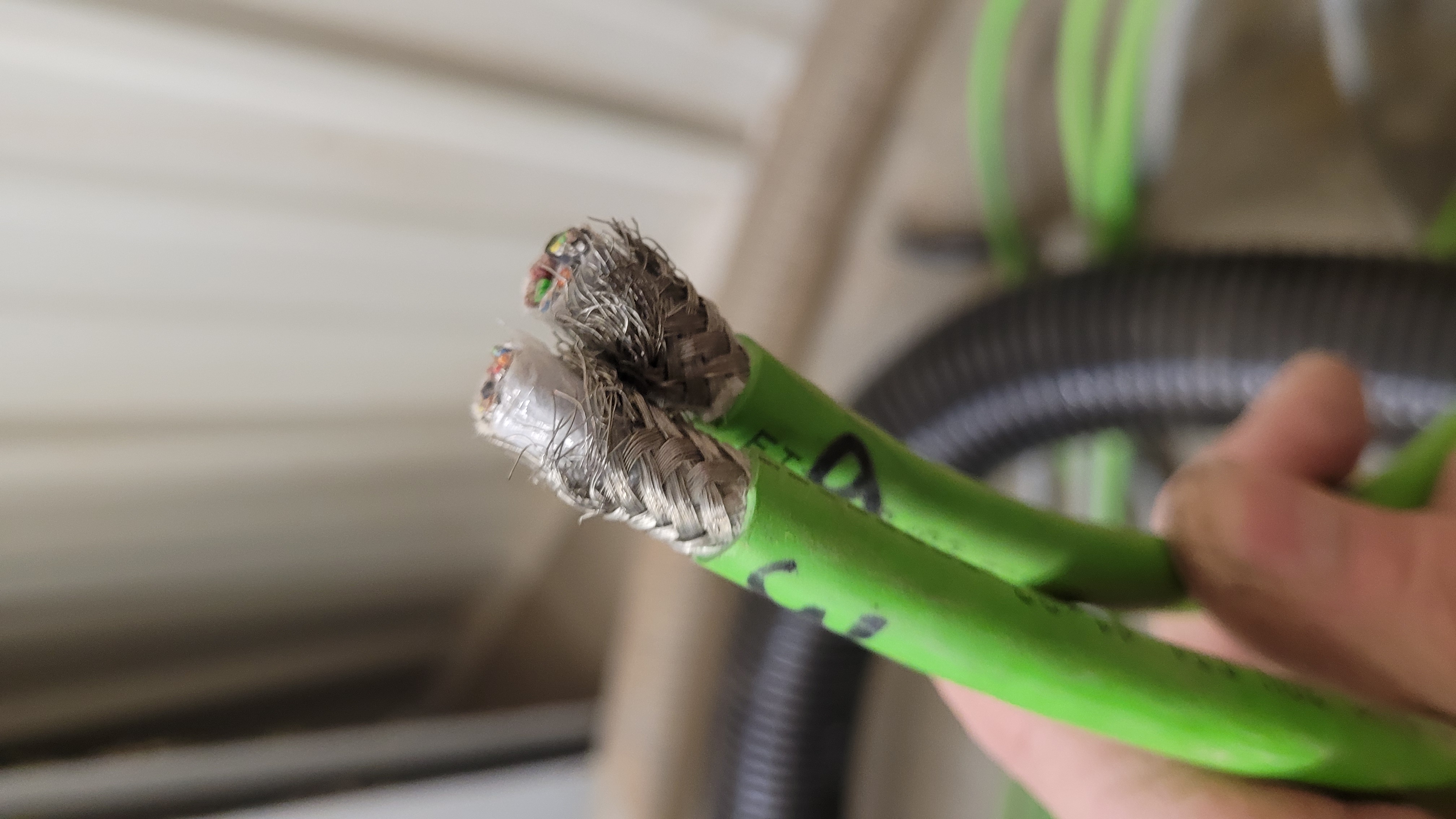

Got a large pod and rail machine and the shop we got it from cut the data cables to disconnect the computer from the machine. Why? Who knows.
Can anyone tell me how to correctly re splice these or if I can unhook the end from the controller and reinstall the cable.
Pics attached

Strip, solder, and heat shrink the individual wires and heat shrink the bundle
The connectors should have screw terminations inside if you want to replace end to end.
Take your time and get them on a clean, work surface and work them one wire at a time.
Multiple photos will
be your friend
Hope that helps.
1/28/25       #3: HolzHer unimaster ...
Dave Edgerton  Member
Thanks Jim, that us what I was thinking but what about the metal sheathing? How do I get that correct so there's no noise contamination?
1/28/25       #4: HolzHer unimaster ...
Jim Herron
I'd try to cut it clean, pull the braided shielding back, make my heat shrink connections, re-lay the braided shielding and apply a wrap of foil tape, then heat shrink the bundle.
If it gets interference, recable it end to end at the connectors.
One other option is to install a male and female connector in the existing cable that's cut, then the shielding is intact.
