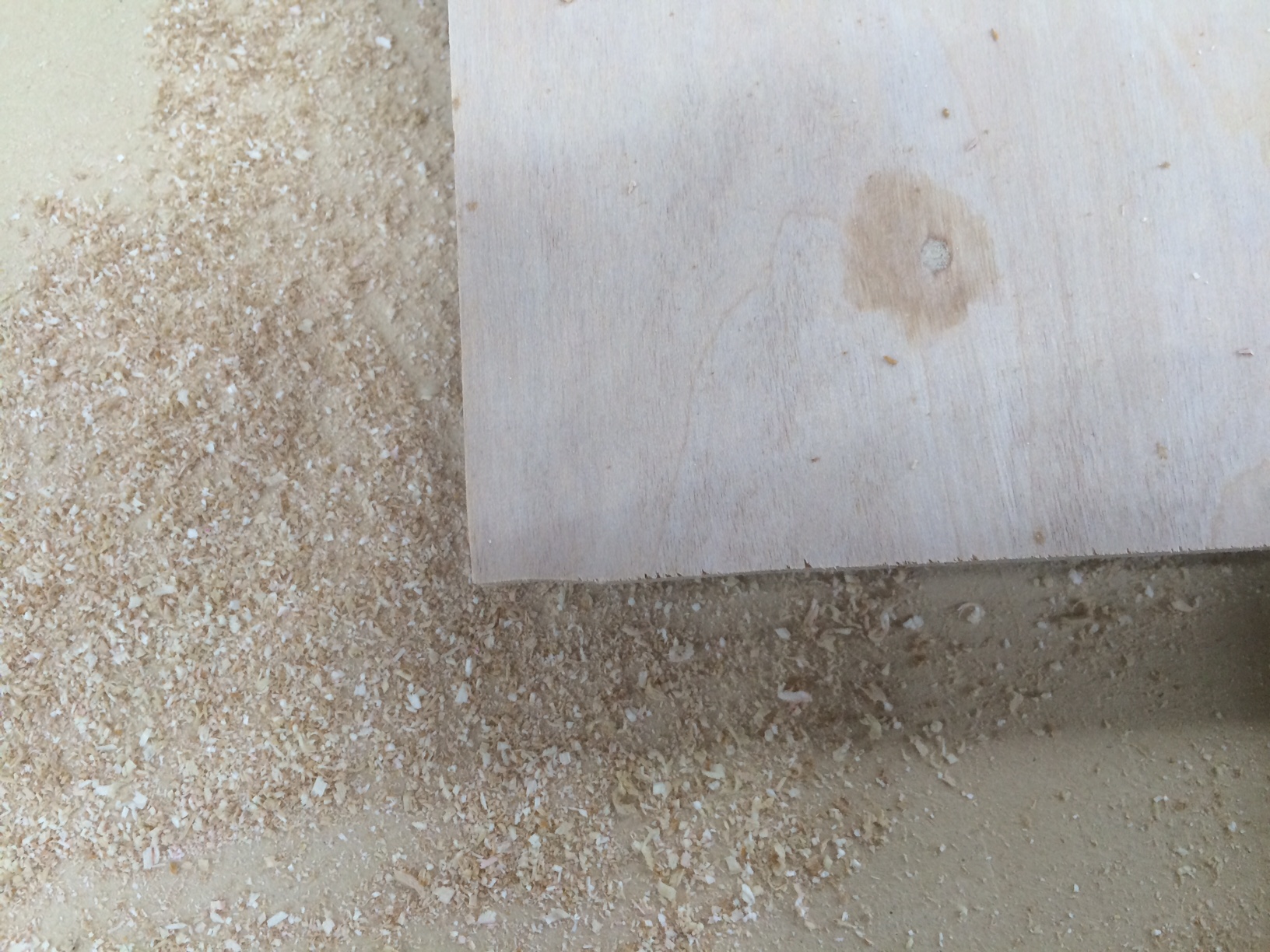

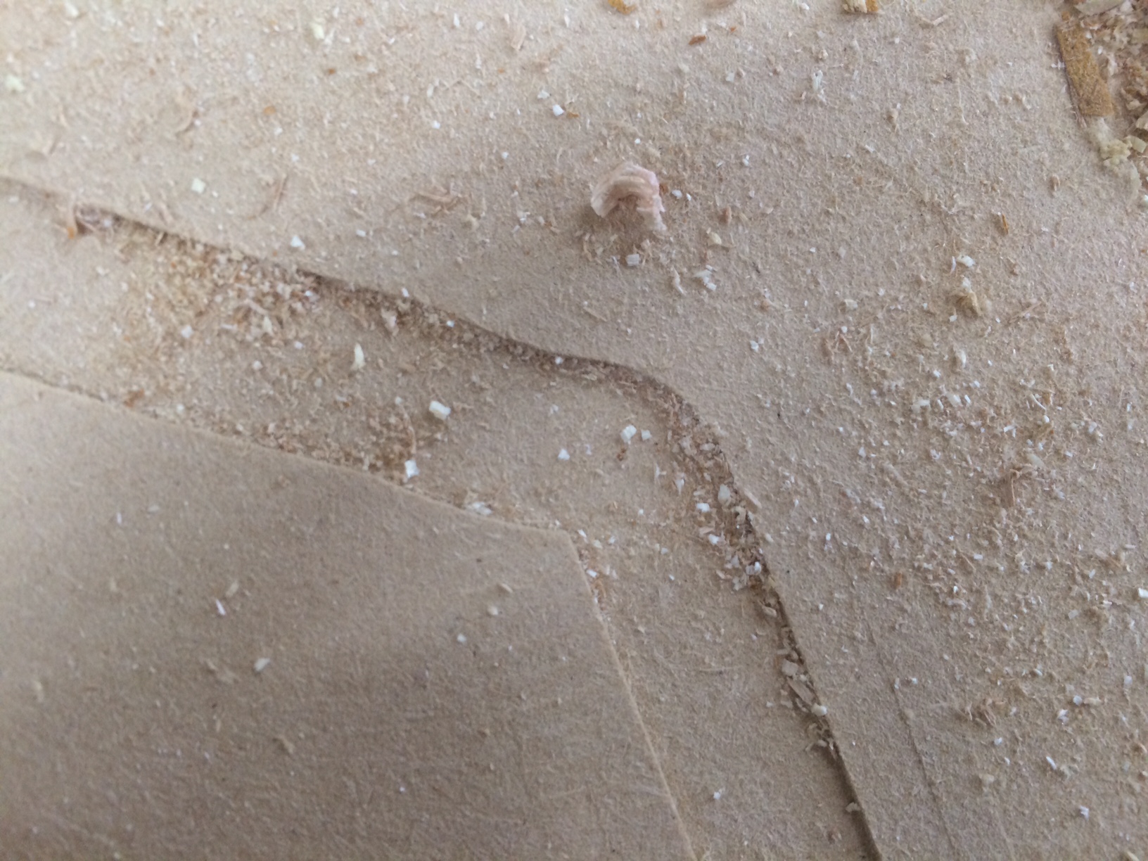

Anyways, I'm using the XNC post from Enroute that I use on my Rover 322. The issue I'm having is that when the machine arrives at a corner it decelerates to a near stop and accelerates back up to speed in a very jerky motion. This causes the gantry to shudder and make terrible corners. I would expect this if we weren't rolling around the corners,but we are. At every corner the post issues a G4 command and a radius of half the cutter diameter.
The axis move smoothly and the machine doesn't seem strained and only misbehaves on the corners. i don't know why it decelerates so abruptly. Any thoughts would be appreciated.

Quick update. It appears to be an issue with the post. If I enable "sharp corners" in the post and eliminate the roll around corner code, the machine smoothly decelerates at the corner and the accelerates with the change of direction. The parts come out nicely.
