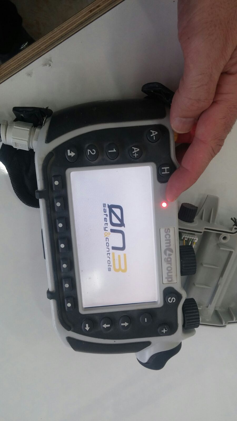

7/30/17       #19: Need Help with 2014 SCM Pratix S15 ...
Benjamin
a voice from the past...Hi everyone.
The inevitable happened today and the HMI console fell off its cradle. Now I get a white screen and Windows doesn't load. Everything inside looks ok, all wires connected etc. Any clues please?
View higher quality, full size image (900 X 1600)
11/6/23       #23: Need Help with 2014 SCM Pratix S15 ...
George Reiche
Website: http://mainestaircompany.com
I have this handheld for my SCM N100 and it sometimes goes to a typical desktop screen, and I lose typical controls. Has anyone had this issue? I have tried redownloading software that SCM assisted me with no luck. I would love to avoid buying a new one...
12/8/23       #24: Need Help with 2014 SCM Pratix S15 ...
Pdub
Ours is starting to crap out again. Already replaced the screen once. These handheld units are garbage.
Anyone replace theirs lately and know what they are running cost-wise?
George, just seeing your post. On the
"windows screen" there is a "file" button in the upper left. Press that (with a stylus, it's small and hard to hit) and then hit Exit. You should be at the usual screen.
