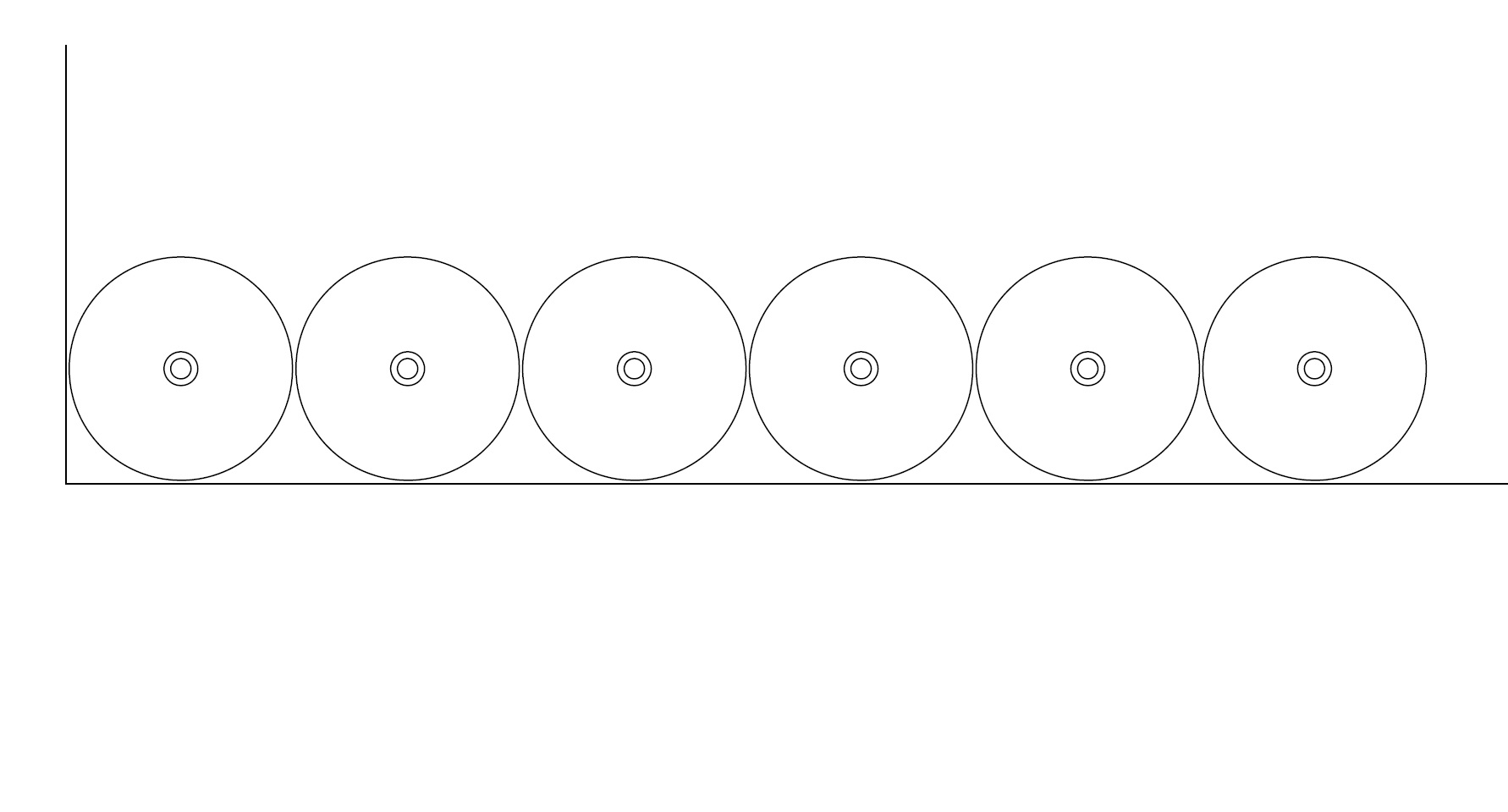

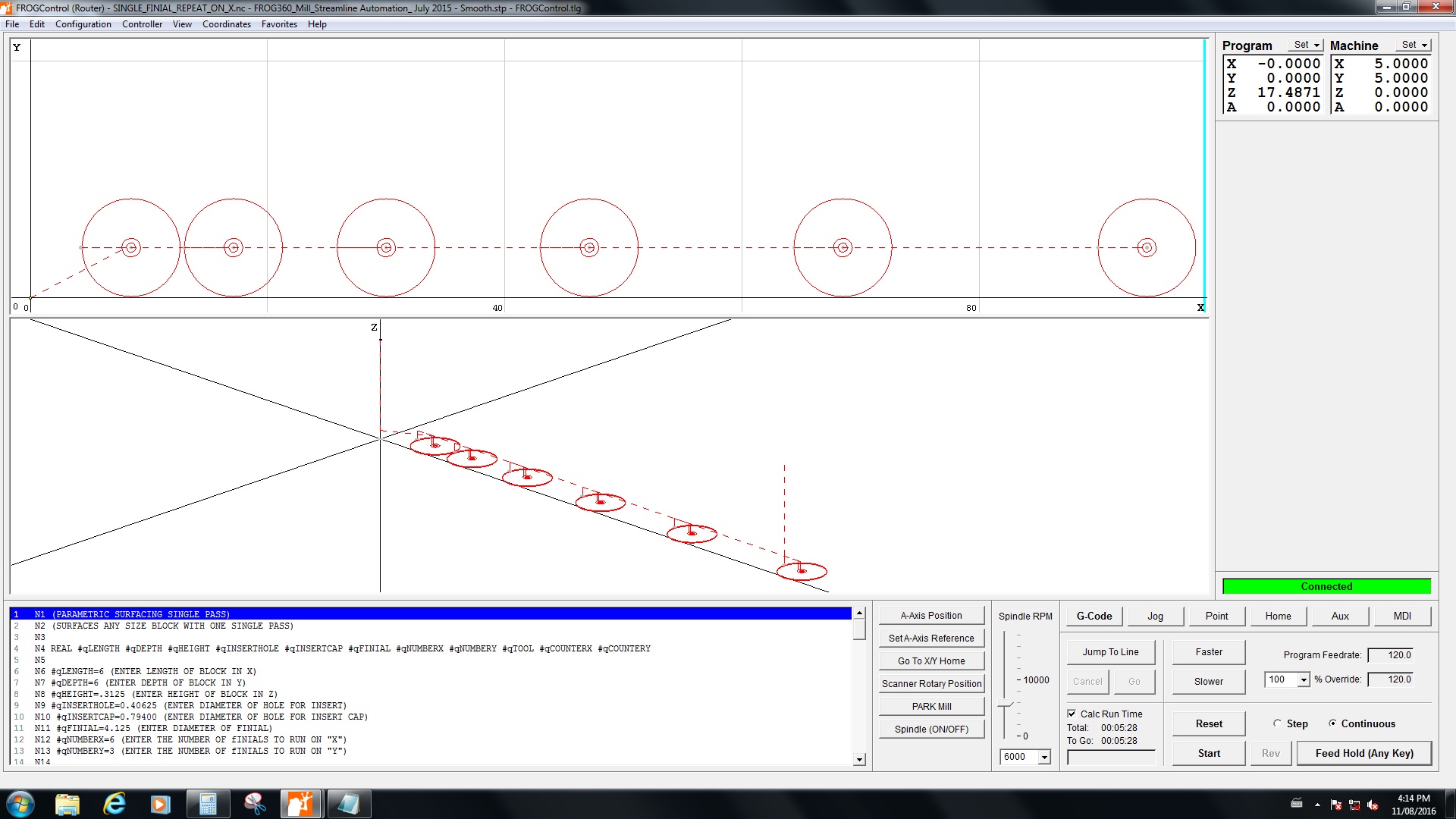

I am trying to create a loop for a program that has three circles.
I made the program so that the center of the circles are at X=0 Y=0. Then I added an offset so that that program in inside my stock.
N42 G92 X-[#qFINIAL+0.125] Y-[#qFINIAL+0.125]
This by itself works fine. However I want to take this program further and add a loop. I want to make multiple of these circles on my "X" axis so I added the following parameters
WHILE #qCOUNTERX<#qNUMBERX DO
N45 #qCOUNTERX=#qCOUNTERX+1
Now everytime this loops I need to offset the bigger diameter plus 1/8" clearance.
N49 G92 X-[#qCOUNTERX*#qFINIAL]+0.125
At the end of the loop I need to reset my offset back to "0" and end my loop.
N84 G92 X0
ENDWHILE
The problem that I am getting is that it is not offsetting as I want it. The attached picture shows the result of my loop and the second one what it should look like.
If anyone has any tips on how I can get this working I would really appreciate it.
