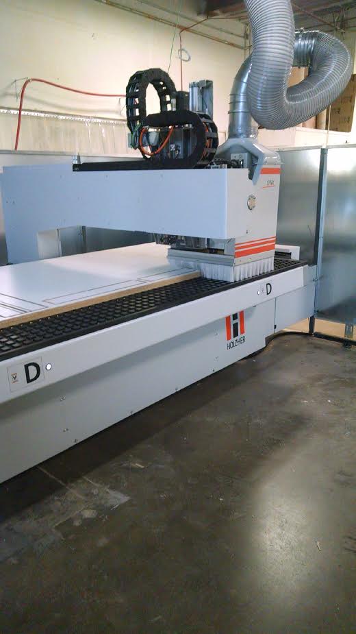

stefan feulner
I have a Lynx and I have been very satisfied with the machine. I did not consider the weeke due to a unruly saleman in our state and the $30,000 extra on the price tag for a very comparable machine. I also didn't consider the Biesse due to some interesting sales techniques and some horror stories from their "Klever" machines.
We had an omnitech before the Lynx and that was a horror story.

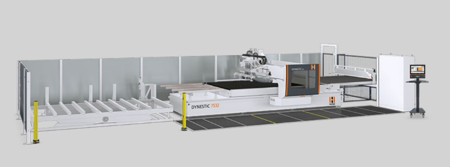

Stefan
Its weird seeing this post pop up from 4 years ago. We now have 11600 hours on the Holzher Lynx. We have had zero downtime during that time.
In April we are upgrading to the Holzher 7532 Lift with auto load(pre-labeling) and auto offload.
I can say that my LYNX served us very well in the last 6 years.
