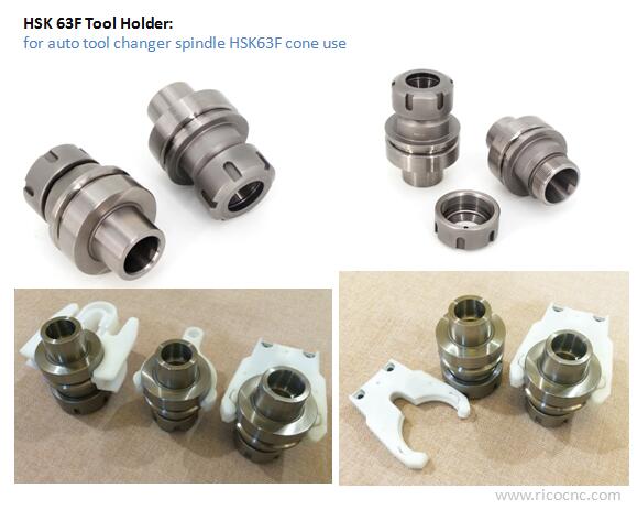

4/6/17       #5: Tool holder options ...
Salce Smith  Member
Website: http://www.ricocnc.com/
RICOCNC supplies CNC tool holders (HSK63F, ISO30, ISO20, BT30 etc) and matched toolholder forks.
View higher quality, full size image (579 X 463)
http://www.ricocnc.com/list/22-cnc-spare-parts.html

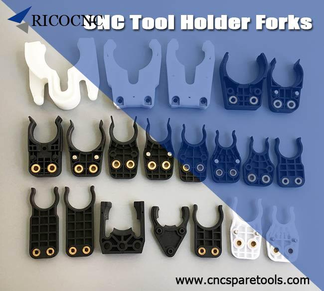

11/5/18       #6: Tool holder options ...
Sherry Zhao  Member
Website: http://www.cncsparetools.com
a range of cnc toolhodler forks
View higher quality, full size image (650 X 583)
