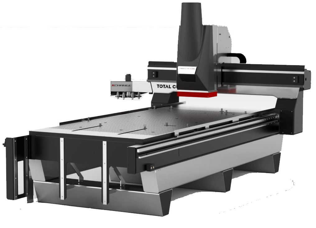

What is your primary product line? Is there possibility for expansion into other products?
Machines such as the Total Cut line of CNC routers are capable of both pod style and flat style cutting making it a more versatile machine for a growing company.
